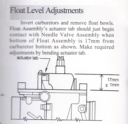

Where RS34 carb float height is significantly maladjusted, and desiring to get it set within the ballpark as prerequisite to the fuel level adjustment via clear tube method, here's the float height setting procedure.
And to again beat this very dead horse, float height is NOT assurance of correct fuel level.
