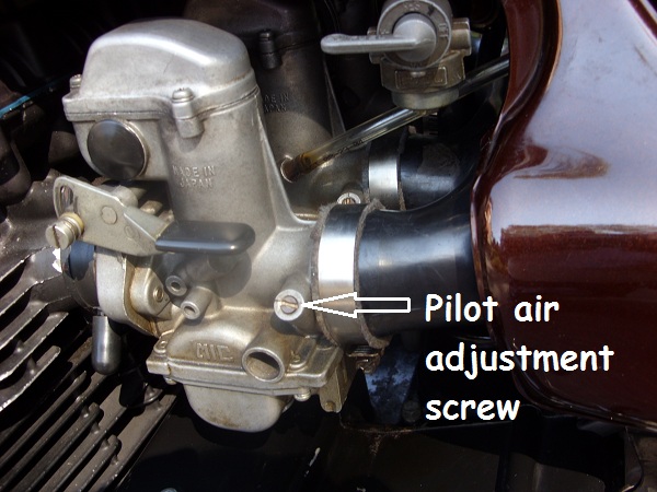

05 Apr 2011 07:46 - 05 Apr 2011 07:47Z1class wrote: ...carbs...have air mixture screw no fuel mixture...It ran and drove fantastic so i took everything apart mostely for cleaning, put it back and now..It runs great until you close the choke, or if I put it in gear and let the clutch out it boggs down and dies under
3000 rpm. does this sound like a carb problem or something else.
Here's a method to clean the pilot circuit in a carb that has a side-located pilot air screw.
Last edit: 05 Apr 2011 07:47 by Patton.

05 Apr 2011 09:12Z1class wrote:...still have the choke problem.Attachment 201144027.JPG not found
Guessing either 26mm or 28mm Mikuni manual slide carbs.
I don't know about the numbers Z12 00 and R 63.
To determine size, could measure interior diameter of bore where exits to engine.
In the pic, choke appears to be ON, because the plungers are in UP position.
