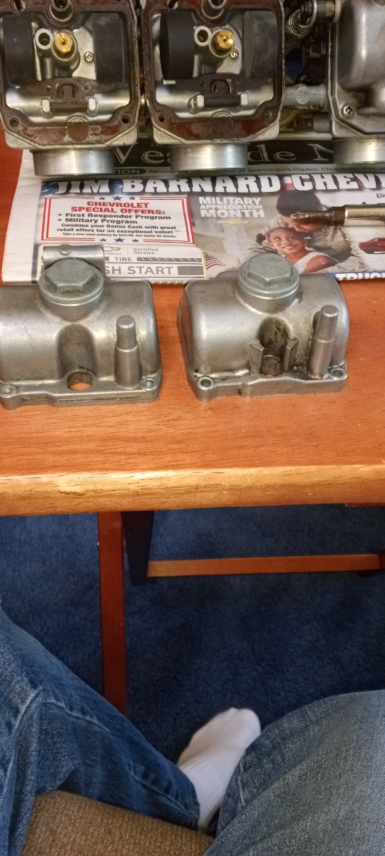

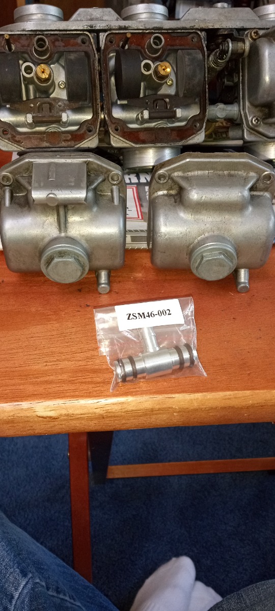

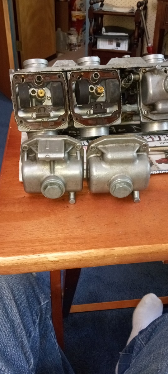

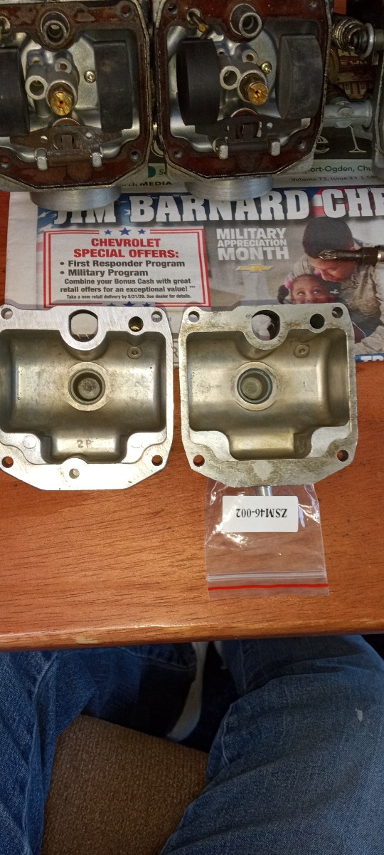

Hope this helps identify something. I am looking for a early Z1 28 mm bowl or 3 29 mm bowl's. Do the math... Will give you a 29 bowl for a 28 mm with center drain.
These are what I have and would like to match the set to all same.
They ran real good like this but I think it is better to get it straight.
If this 28 bowl fits, and it does I think 26 mm & 28 mm bowl's from 900 cc bikes should fit.
Jim
Jim

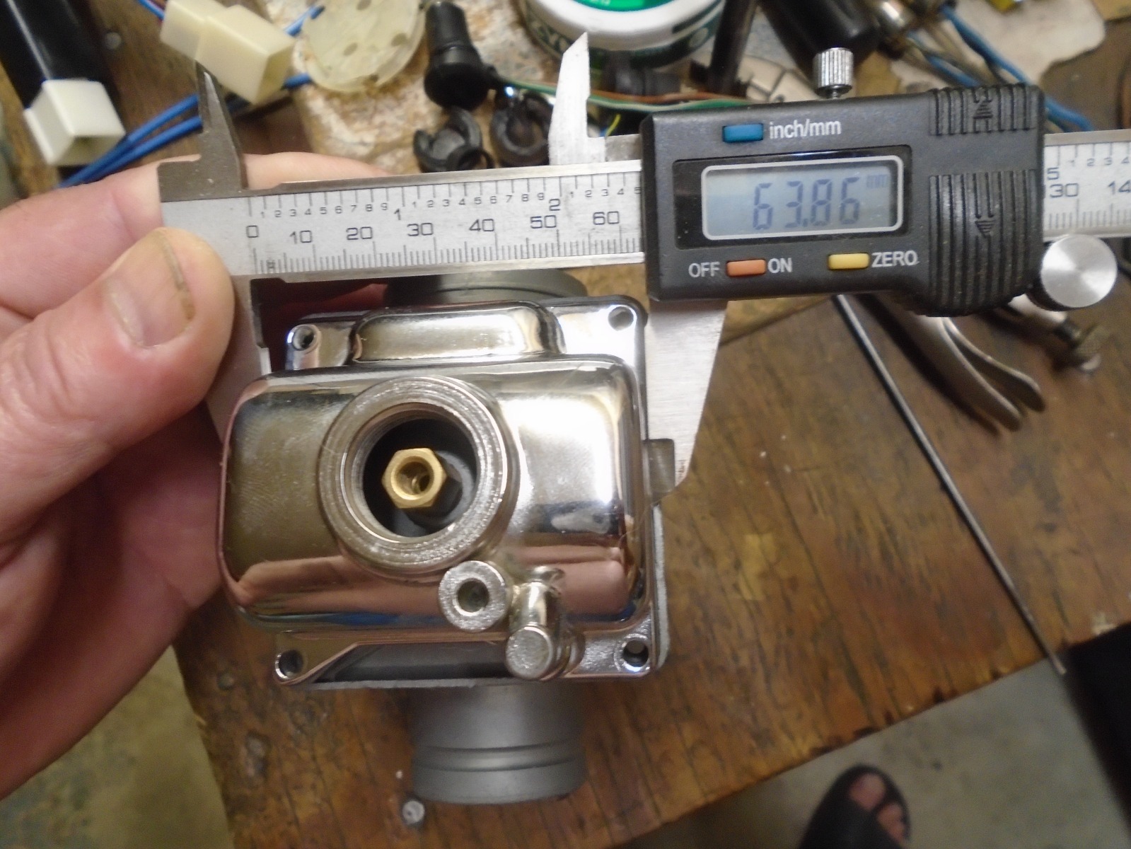

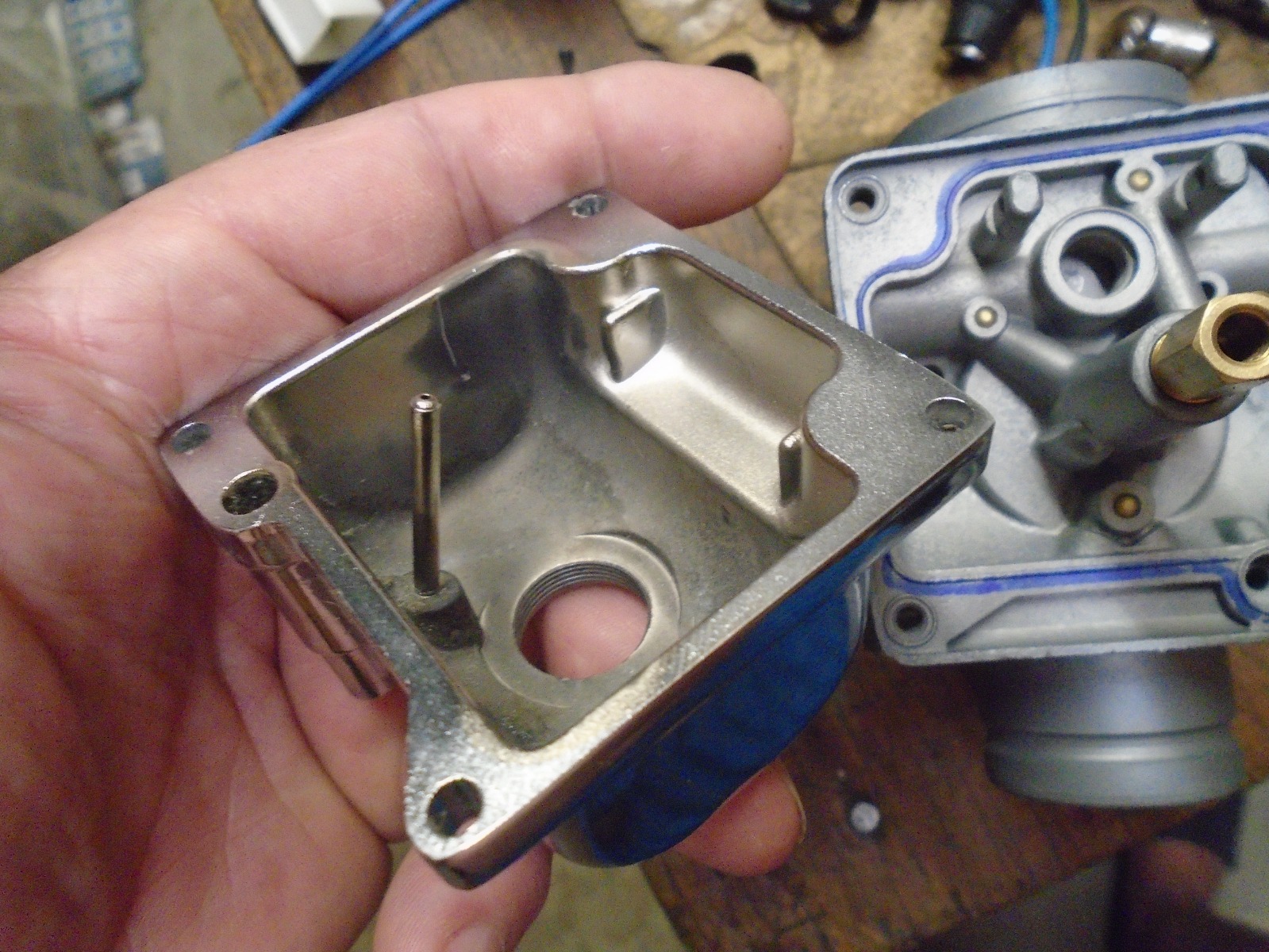

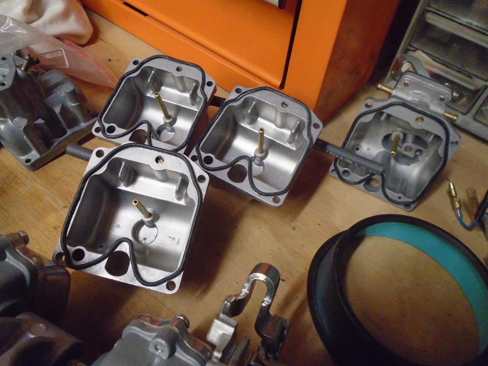

Although i've never tried what you're trying to do, Highly doubtful an early Z1 "big nut" bowl would even fit your smoothbore carb casting. Soo many differences between the two making it impossible, Sorry Jim. Seems you have a hodge podge of non-matching stuff. Note the angle of casting and bowl you have where it gets closer to the 4 screws. Not even the KZ900/1000 VM bowls would fit. Occasionally you will find these 29 bowls on ebay. Even then, verify the Big Nut Bowl and Nut threads are intact. They are often stripped from ham fisted previous owners. And those nuts threads are a different size then the Z1 28's. Here are some photos for you to scan over to verify what i'm saying.

Thank you for the knowledge. That sounds like 29mm smoothbore bowls must have came with different outside figurines?
At this point I keep looking for the one or three others to fix it.
Thanks again, Jim
