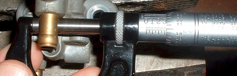

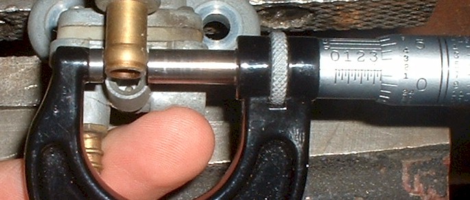

I use 1/4". It's a snug fit, so I guess either size will work ok. The inside diameter of the petcock outlet tube is just shy of 1/4" so either size will flow enough fuel. Ed

On on the later models, they went to a larger fuel line. I think it's nominally 8mm. The closest to that is 5/16".

Interesting. On mine it's a snug fit, but not nearly tight enough to pull the nipple loose. Mine has the original 1977 non-vacuum petcock. Of course, it could be that the automotive fuel line I'm using is actually a tad over 1/4" even though it is marked 1/4" or maybe it's more pliable than some other types. Ed
