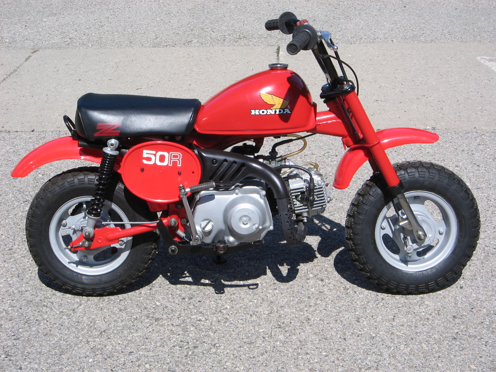

Sold the Honda Z50R tow bike for the asking price locally. Its going to be restored by a enthusiast.

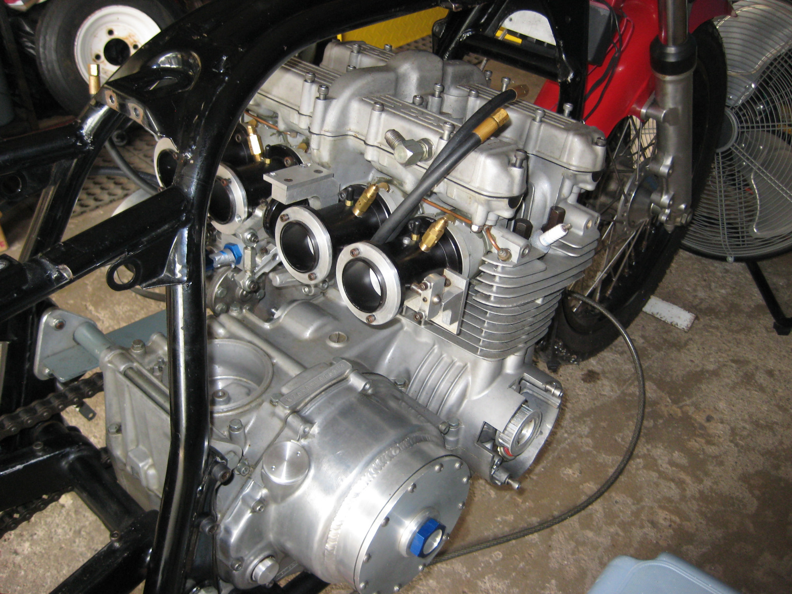

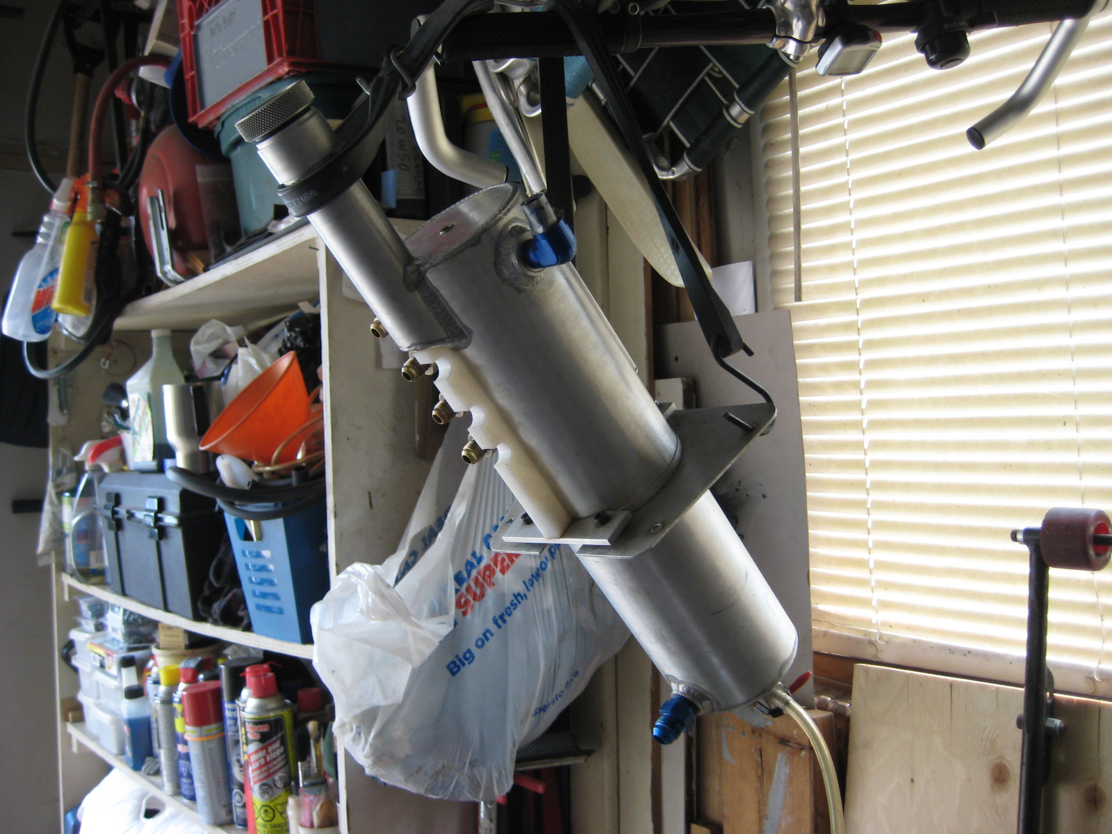

Started stripping down the 831cc Alcohol Injected bike today which has not run since 2010. Hoping the compression is still in the OK range for gasoline, it was a 16:1 comp (~280PSI) engine so will see how bad those rings may be stuck!
It has custom pistons in it that may need cut down a bit!
The plan is to put this back on the street with a huge oil cooler and some big round slide carbs.
Was able to get some parts removed...

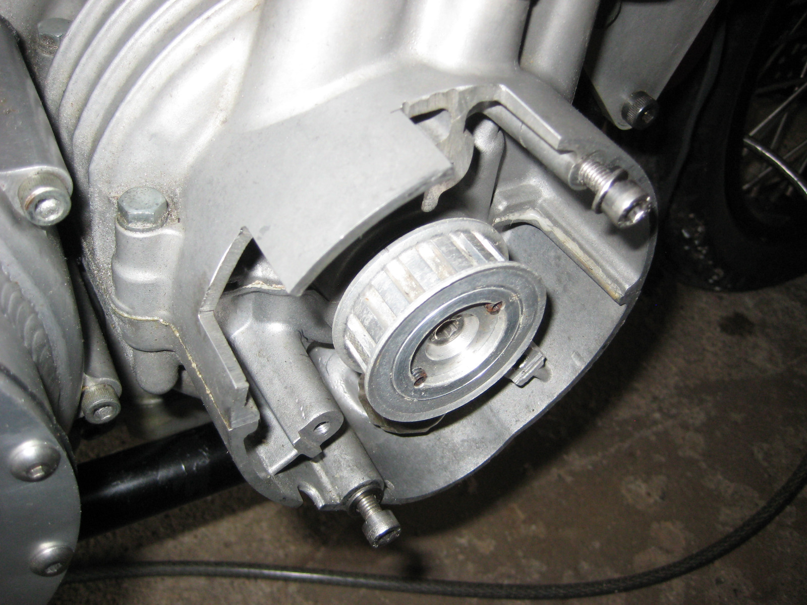

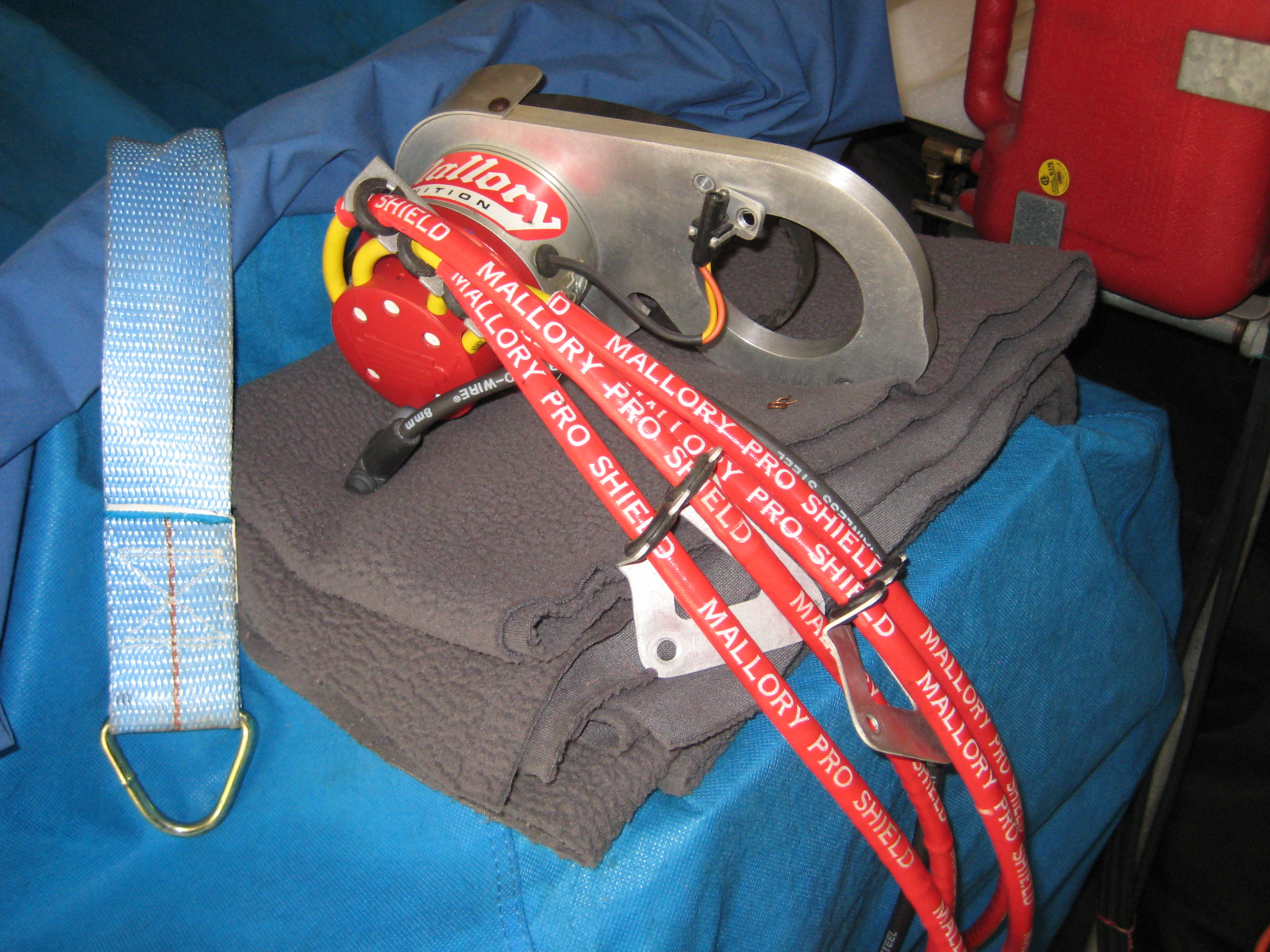

Magneto :
Have to fabricate some standoffs for the ignition plate and some plugs to keep the weather out of the points

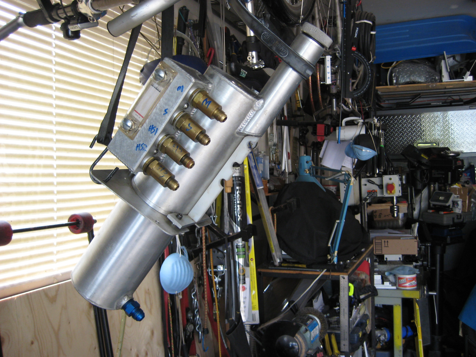

Got the fuel tank out in the wind :

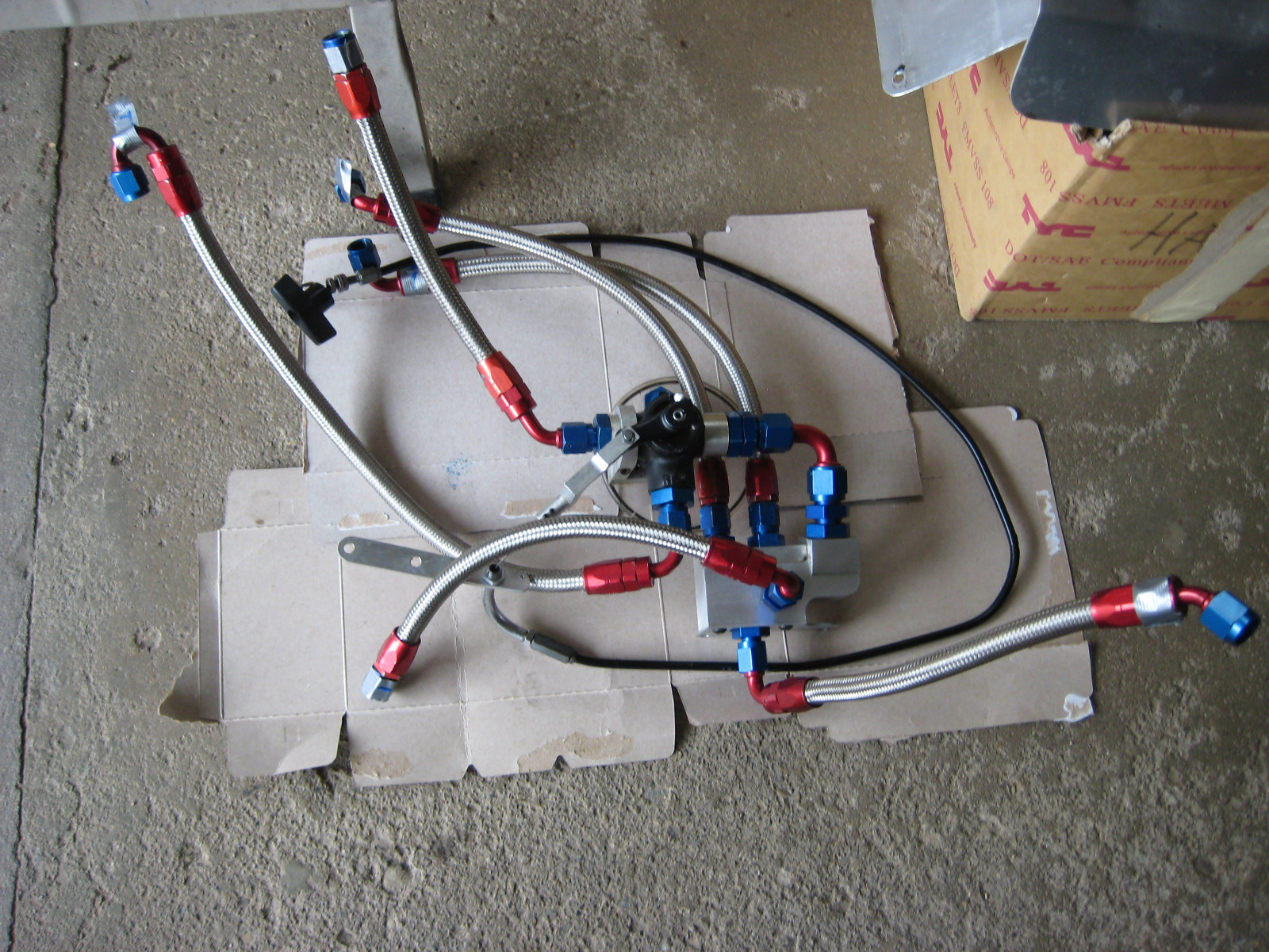

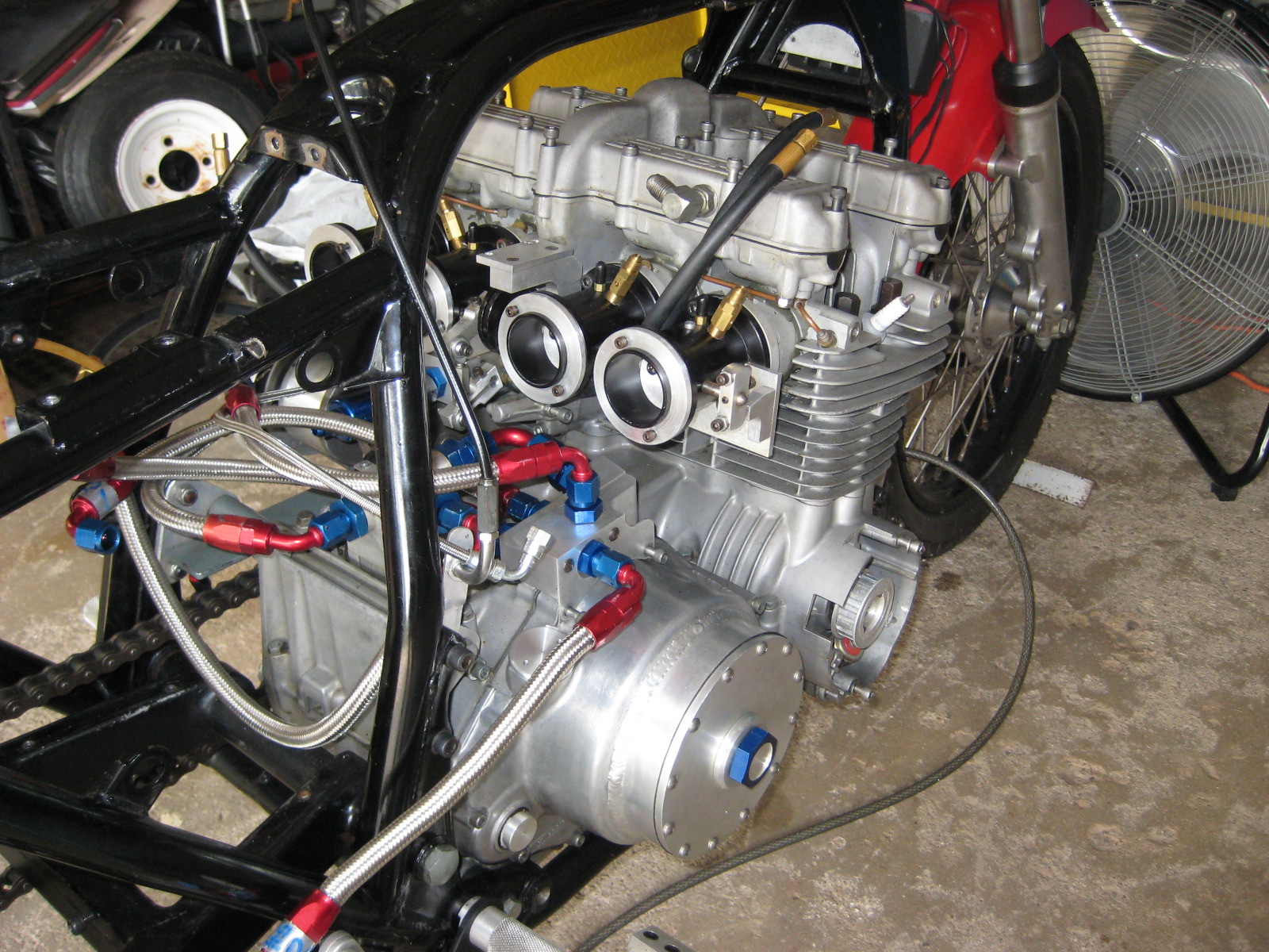

and all the AN hoses off the top of the case :
The injector bodies are a bit tricky to remove due to a couple of nasty placements on the fasteners.
Only thing left is to remove the fuel pump. I will also need to remove a car battery to whip the engine over to test the compression. No kicker or electrics on it
I have 30 years of development into this puppy.
