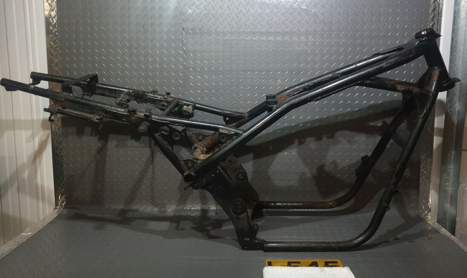

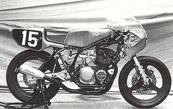

I talked to a frame builder about building a racing frame for a 500/550 engine.
He adviced to build a Moriwaki frame and sent me these pictures.
I haven’t found any information about these bikes. Does anyone here know anything?
Kr Sixten

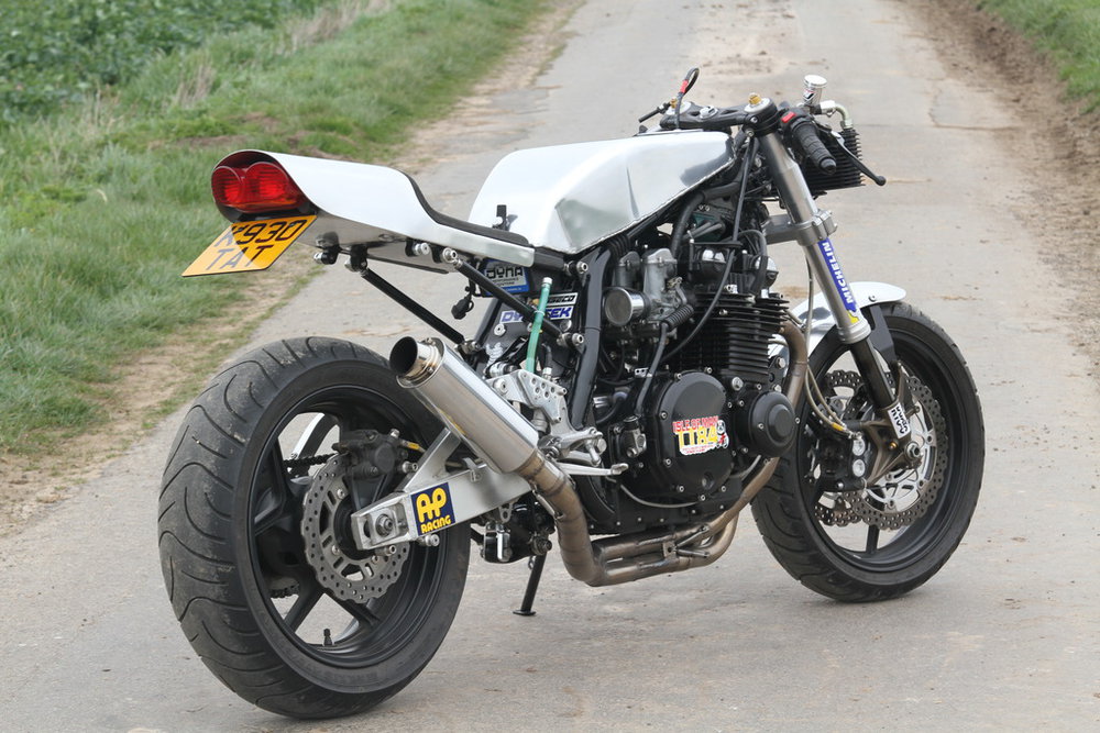

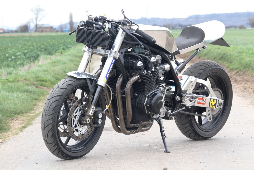

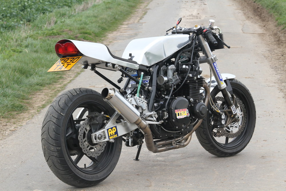

Why not start with a ZR550 frame and modify and brace it to your requirements.
You will get a machine that handles just as well and the lines will enable a similar look as well as being a lot cheaper.
This is my Z1000 in a ZR750 frame and it handles as well as any race bike.

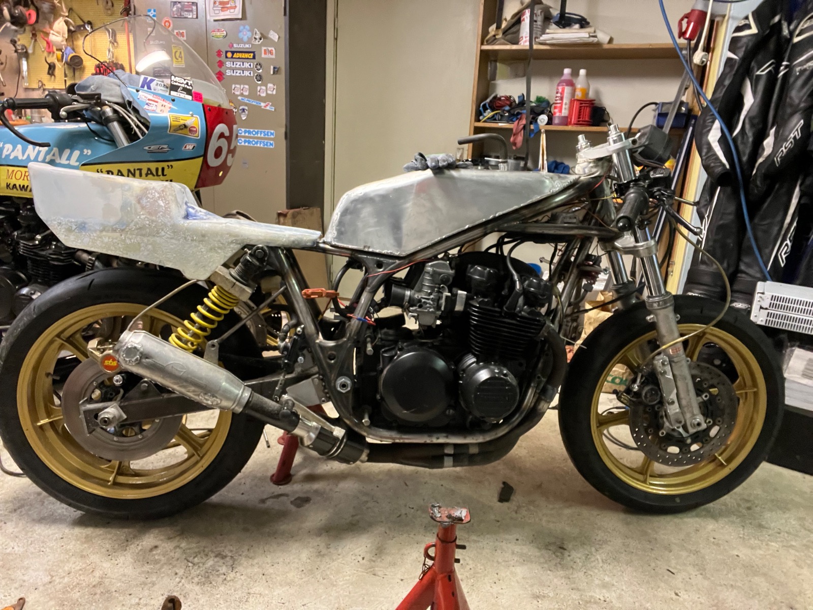

I found Japanese magazines on eBay with some info. Moriwaki started building the bike 1979 and 1980 a finished bike was ready for japans GP but unfortunatly the rider was killed in a practice session before the event and the bike never raced. Moriwaki later switched to CB400X engines.
Don’t know how many frames for Kawasaki engines that was made but I know it was used for 4h endurance in the early 80s.
I have put everything together and just took it for a test ride. Now it’s time to take it apart again and paint everything.

Wow that chassis looks awesome, who made it? Do you have any more pics of it? Whats the other Moriwaki rep in the background?
- Sixten
- Posts: 68
- Thanks: 27
Re: Moriwaki 500
06 Jan 2025 12:07
Good point. Should be in FIMs archive. Not so easy to get I guess 🙂
JL Mekaniikka made the frame.
The bike behind is not a real replica it’s a Z650. Only the front fairing is the same as the original Crosby Moriwaki. And Morris wheels but otherwise nothing is the same.
