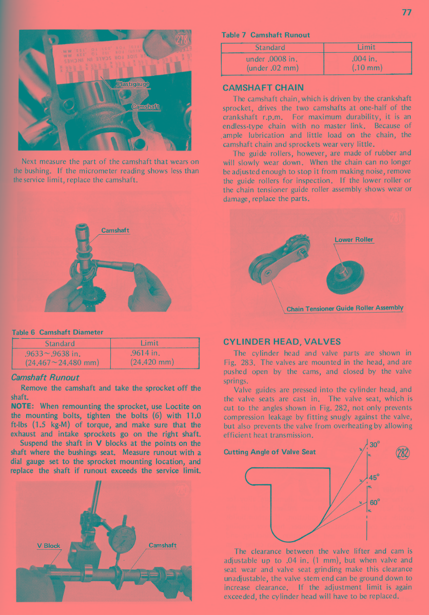

Checked the cam between centers this morning there is .002-.0022 of run out, doesn't seem horrible but not great either . Is there a specific for that does anyone know?

Re: Cam bearing clearance
05 Oct 2021 06:55 - 05 Oct 2021 06:57
The factory service manual shows the process and specs for measuring the cam. I've scanned the page from the '76 KZ900 manual. The specs are the same in the KZ1000 manual, but the kz900 manual gives both inch and mm units.
