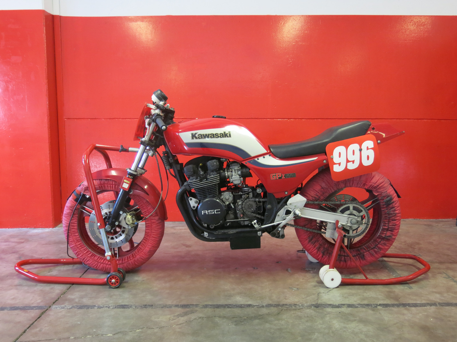

Corry hasnt been racing his GPZ for a while ASFAIK, but he will be an endless fountain of info if you contact him.
I'll be more brief...
I raced mine for one season between other efforts, with medium level but cost effective mods, at least IMHO...
So first thing to check is your rulebook, class you can run, and in general how competitive you want to be....
mods can range from making it just track ready to full blown 680 cc kitted monster, $$$ and effort vary accordingly.
My middle of the road effort was basically:
1. Keep stock 18" rims and run Avon AM22-AM23 race rubber,
2. ZR-7 shock (cheap bolt on mod)
3. stiffer 0.9 kg/mm fork springs / blocked off antidive
4. upgrade front discs to 280mm gpz750 ones (cheap bolt on mod)
5. Brembo callipers + race pads all around (stock setup will be a serious limit / fade beyond “track cruising” level)
6. Marving 4-1 exhaust / R6 silencer (or better kerker/moriwaki
7. ZR-7 carbs
8. Stock cams degreed to 105 degs lobe centers
Regretfully, a well prepped 600 Ducati Pantah or FZ600 that are just two year older will run rings around it
Next step will be a 610 kit, megacycle cams and proper porting, but didn’t got to do it as I switched back to my CB500/4

27 Dec 2019 12:50Mine is an 84...the zr7 shock is a bolt on,Ryanhwatkins wrote: Would these mods fit an 84-86? I’ve been looking for a bolt on front fork option or rear shock. These sound like great mods but I’m wondering if any would work for my 85 gpz550
I kept the stock fork but dropped in there stiffer springs and blocked the anti dive.
Any other law I fork would be easy to install but you'll have to check ride height and trail
