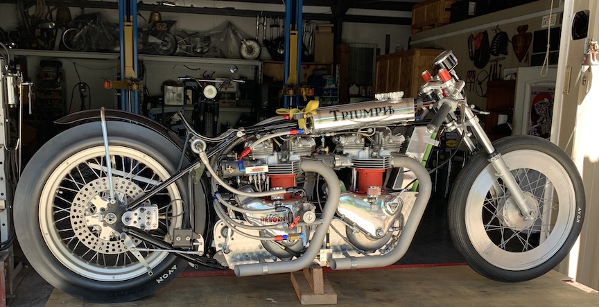

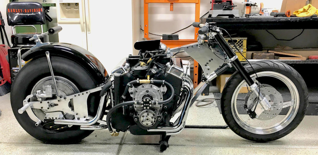

This was a frame Boris Murray made for Sonny Routt. He said it was too 'flimsy' and sold it to Sandy Kosman. Kosman sold it to Ray Masten who ran it around So Cal in the 70s. I've had it since 87 and finally restored it a couple of years ago. I had to make several parts and repair several more. It's now ready to run except for a fuel pump.

07 Mar 2024 04:50Thanks for sharing those pics, Vinsky. Great job on the restoration!This was a frame Boris Murray made for Sonny Routt. He said it was too 'flimsy' and sold it to Sandy Kosman. Kosman sold it to Ray Masten who ran it around So Cal in the 70s. I've had it since 87 and finally restored it a couple of years ago. I had to make several parts and repair several more. It's now ready to run except for a fuel pump.

That's a cool piece of history, glad you made the effort to restore it, great job!
magazine.cycleworld.com/article/1967/9/1/sonny-routts-dragster
Hilborn equipment use to be all over Ebay but I have noticed a big decline over the last 5 years.
Are you running a PG150 #0 pump? Is it setup to run Gas, Alcohol, or Nitro?

It has a BL235 pump mounted just for the vintage look. Nobody will flow test them any longer so a 00 will be fitted when it's run. The bike always ran on nitro and it will only be fired up for cackles.
I did a build page a few years ago on our locals vintage forum if you want to see the whole story.
olymoto.org/viewtopic.php?f=2&t=589&sid=...f5e6927e471be02036fd

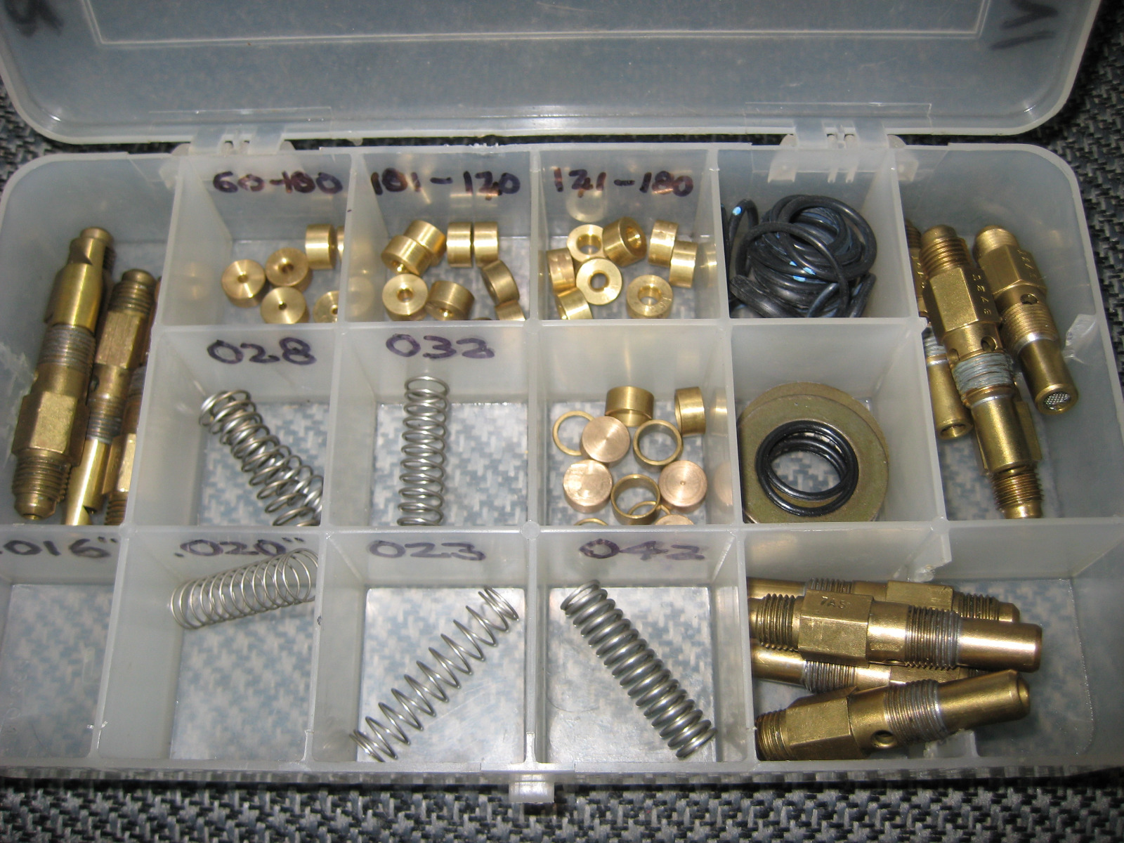

18 Mar 2024 19:13 - 18 Mar 2024 19:16I am not familiar with that pump number but it sounds quite vintage. Hilborn was making this stuff going way back so its got to be early. Too bad they got bought out by Holley as they use to have a pretty good web site. I was kind of shocked to see that web site has disappeared.It has a BL235 pump mounted just for the vintage look. Nobody will flow test them any longer so a 00 will be fitted when it's run. The bike always ran on nitro and it will only be fired up for cackles.
I did not build my injected engine till 1994 and at that time Hilborn was still active and they had tech guys answering the phone for tuning advice.
I run a #00 pump as the engine on my bike is only 831cc. I run many alcohol but I have tipped the can as much as 35%.
I think I was told the #00 was good to about 1500cc on nitro, but too small if you added a supercharger or turbo on top of that.
Thanks for posting that link I will check it out for sure.

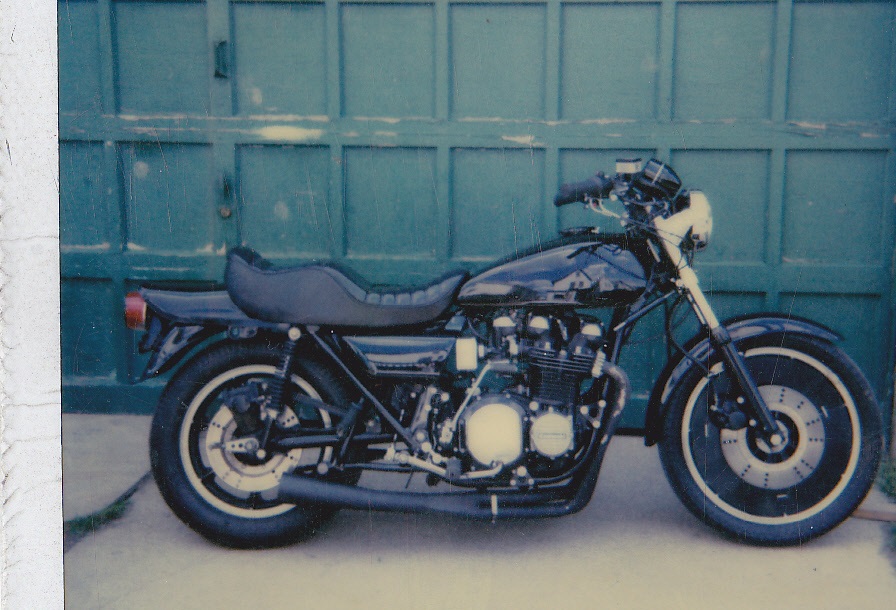

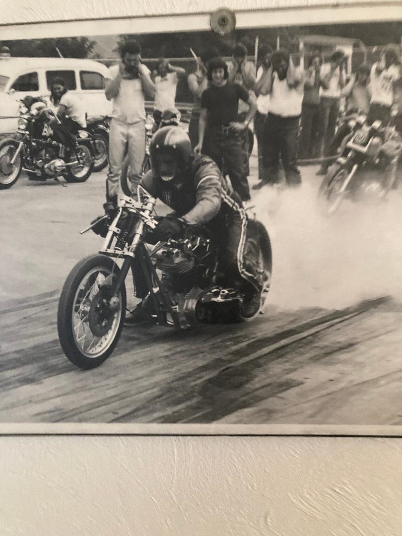

OK, Marty in Buffalo, Here is the story! Just 3 days ago! 3-15. I ran into this old friend on the Z1 "Jimmy The Blaster" He was the jockey for a couple of bikes.
Plus picture of "Al Charlier" "The Buffalo Bullet" was a big name on the Harley circuit. They were all friends
First time I seen these old pictures! 3 days ago! We spent hours & multiple beer's talking & looking at pics
Of course this has to be 75-76 at Bowling Green. "Wild Place" back then! The owner of this bike was my Kaw Mentor! "RIP David" Dave raced side hacks too, Blaster was the monkey. Those Z1's were like water! all over the place, stripped, crashed, blown up, insurance dis-appeared! David saved all the stock parts
Notice the Hog wheel, All blacked out paint, No emblems, Denco left side pipe.
This time period started my Kaw obsession. Maybe the Black paint also! They were all Harley Guys, Plus I knew Paul Gast and PUPPET in their beginning's They were all hooked up together
Forward to 1991-92, I purchased David's Kaw collection, cleaned out his garage! I filled a 24' construction trailer up. Which started my ebay career in 2001 after my 1st Lumbar Surgery, learning to use my windows 95 / 8 gig gateway PC sold oem Z1 parts all over the world.
More of a personal story for me. I'm 65 now.
Lot of memories I wish I took pictures back in my early days.

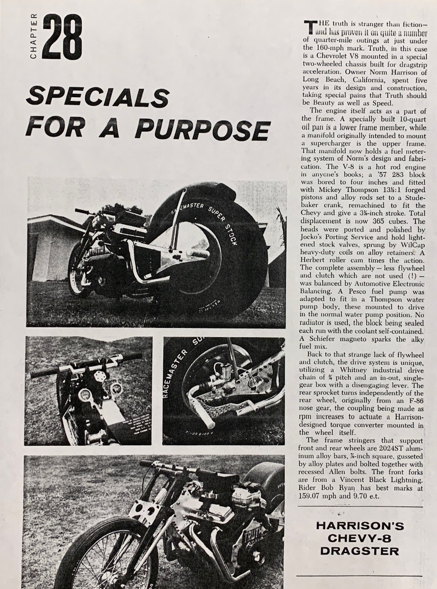

This is a Chevy powered drag bike from the late 50s. I found it while looking for some part for a Vincent drag bike I was restoring. I got to meet some of the guys who built and rode it. Some cool stories.

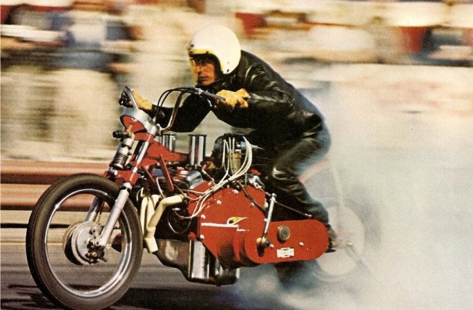

That Potter is amazing. I had never heard of him. A couple pics of him from a link in your wiki link.

Bill Harrison was the builder, and a much different bike than EJ Potters. The article attached is from the Motorcycle Sport Book Quarterly by Peterson Publishing. As you can see it had the forks from the Vincent drag bike I was restoring. And had the steering head with serial numbers that matched other numbers on the Vincent, one of the reasons I searched for two years to find the V8 bike.
I eventually sold the V8 to the son of the builder and he did the complete restoration on it.

Potter made a world record pass in 1973 running 8.68 @ 172 MPH, setting the quickest and fastest time in the quarter mile on two wheels. That was version #7 which had a 350 cu in engine with the Hilborn Injectors (suspect that was on Nitro)
