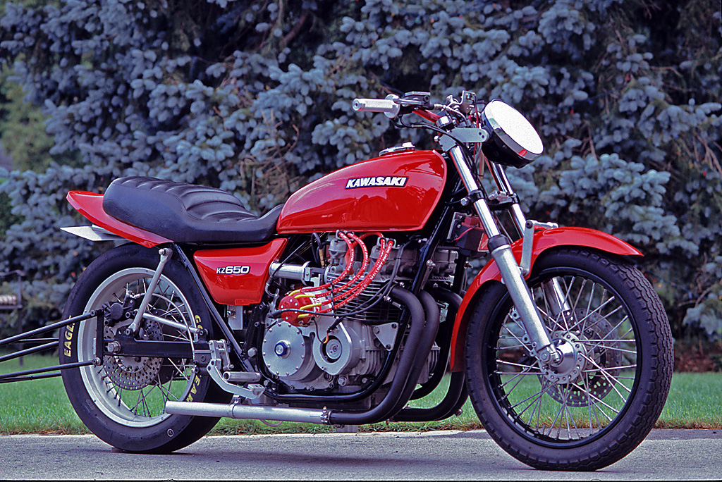

17 Jun 2021 08:11Interested in knowing a little more about that 650.
kzrider.com/forum/11-projects/338400-a-little-bit-of-an-upgrade
'77 KZ650-C1 -- build
810 kit
GPZ cams and carbs
ZX6R front end
GSXR600 Rear
Kerker
Dyna
Accel
ContiMotion tires (120/60-17&170/60-17)

The red 650 is my old street bike, it has a 831cc motor and mechanical fuel injection, it runs alcohol. It was built into a drag bike by me and a friend in 1995.
The Z1 is now black and runs a 1327cc motor with 40mm Lectrons. I am just finishing up a complete rebuild on it, it has a scratch built custom chassis, not a back half conversion. I bought it as a roller and built the motor.

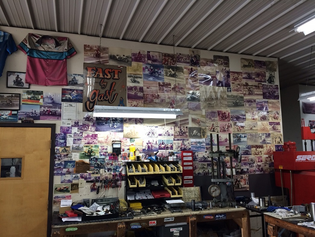

Lets see that car tire frame. Race Design was the Infamous "PUPPET" from the early 80's Pre- "Racevisions" Don't ruin that paint! Puppet painted that! As these items also. Pictures!!

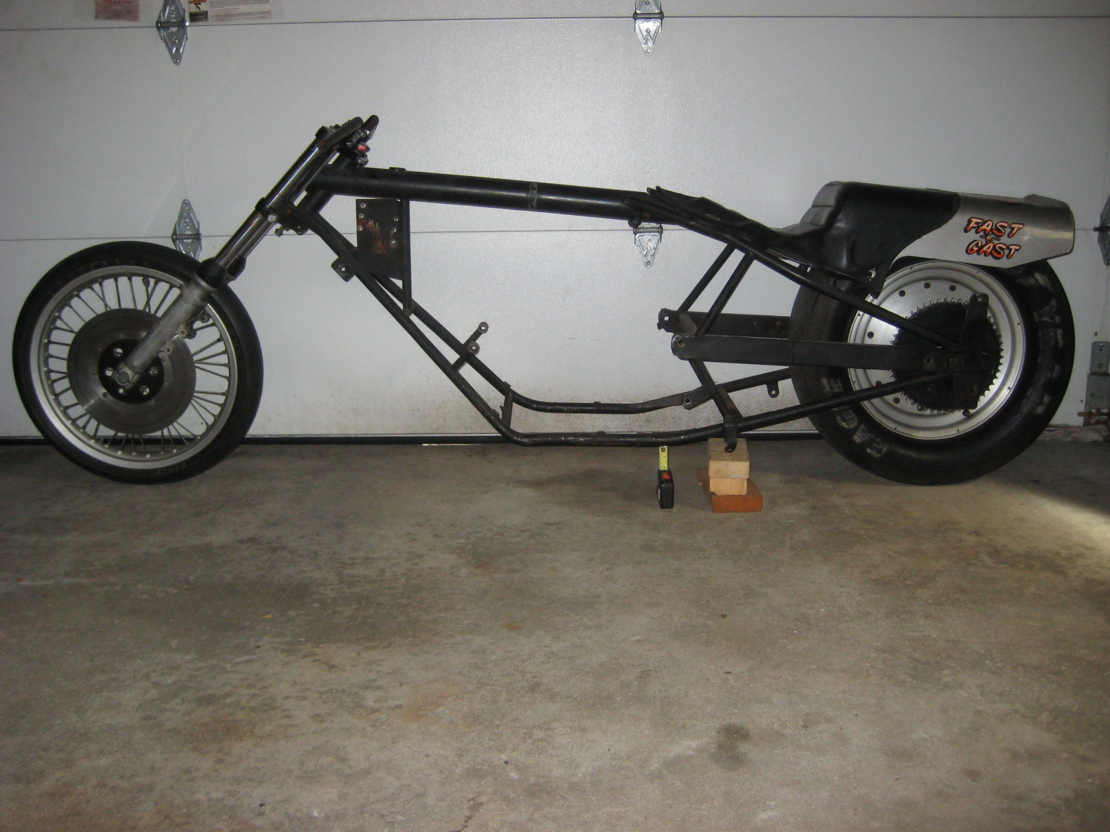

This is the car tire frame - FBG/Race Design (some of the pics not so great)
It has a 15" x 8" slick, so small car tire (VW?) So far all I did to it was take all the stickers off the tail and remove the two stroke motor mounts. I mocked up the engine in the frame to make sure it will fit with the supercharger mounted behind the head.
Personally I don't think it is a Puppet frame, its a bit too sloppy/jenky to be his work. I have seen some of his work up close and the frame I have is a beginners work that was possibly done by somebody that had too many beers.

25 Jun 2021 07:20 - 25 Jun 2021 07:25So what is your opinion on that roller?Lets see that car tire frame. Race Design was the Infamous "PUPPET" from the early 80's Pre- "Racevisions" Don't ruin that paint! Puppet painted that! As these items also. Pictures!!
You can see in the last picture the lower frame rails are wonky, up close the welding is terrible, looks MIG welded to me. It looks like there was no attempt to get it symmetrical.
I talked to my local drag race guru and he says he can fix it no problems.
I am just looking to build a nice nostalgia bike I can run on test and tune day, I am not going to bracket race it for points.
