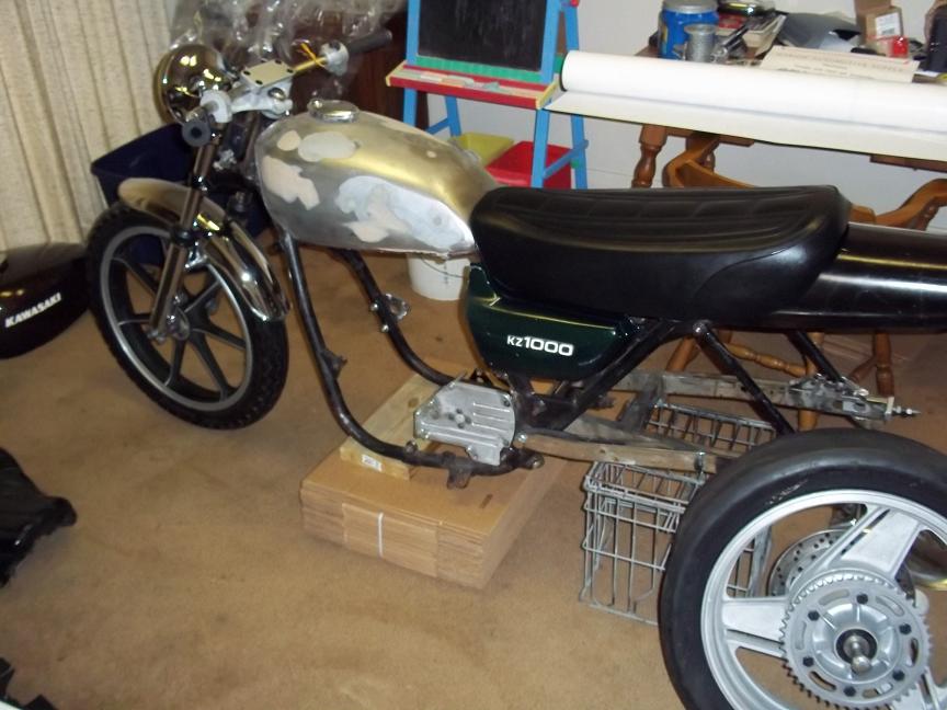

That's simple and COOL. I've been there a bunch of times with Z1's and KZ900's
I recall you were looking for a wider rear wheel?
I might be selling this one from a 89 ZX10, 4.5" x 18" it has a used 5.5" slick on it
with a 530 size chain, 45 tooth sprocket.
This pic was from the winter time.
I am waiting on a freind of a freind to buy this roller. If not I am going to part it out.
