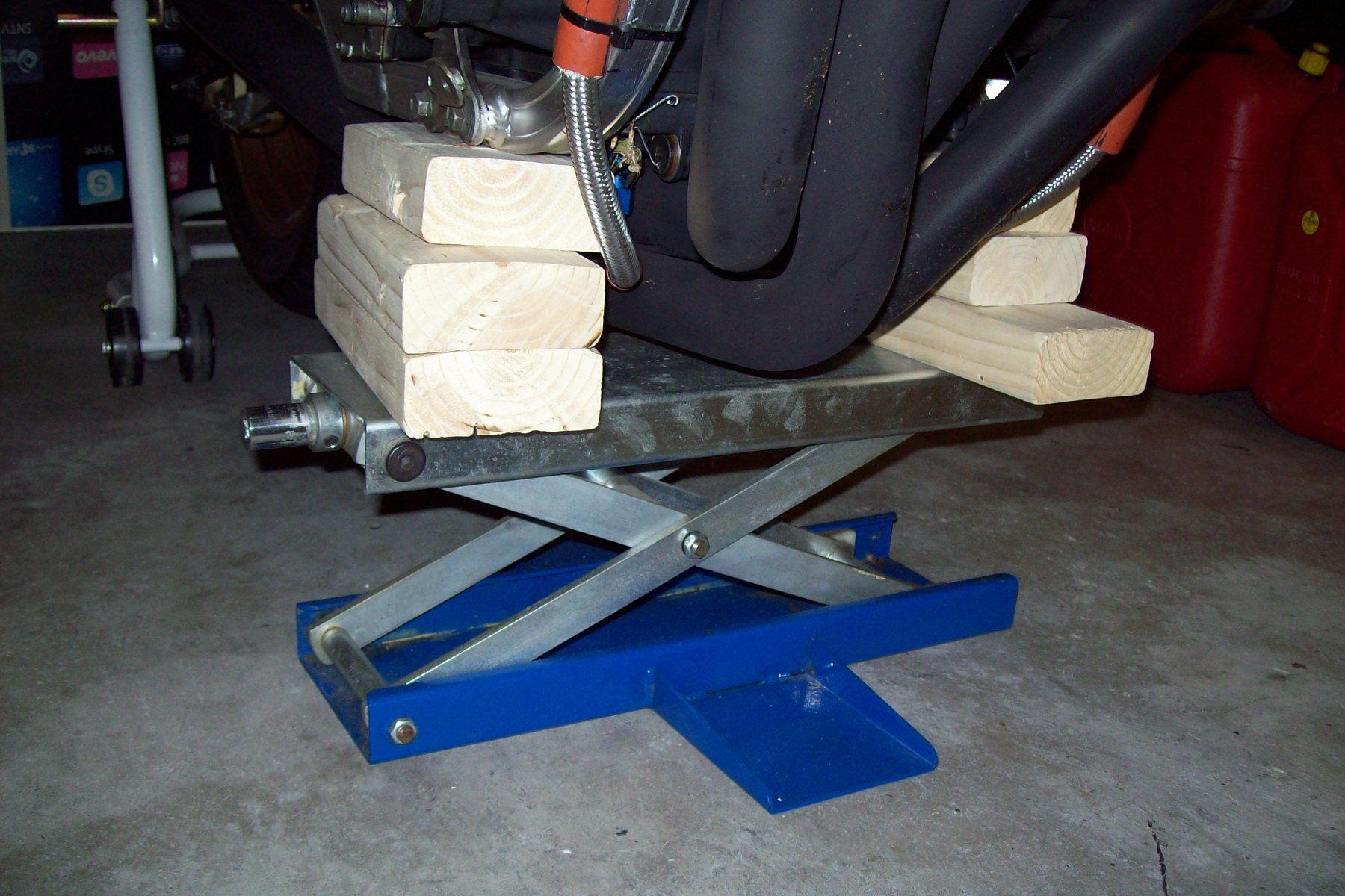

I have been using a jack real close to the Black Widow jack for the past 30 years or so. Never dropped a bike off of it while I had it under anyone of my bikes. I use pieces of 2X4's instead of those moveable adapters that comes with the jack, It makes the bike a lot more stable using the pieces of 2X4's. I stack the 2X4's to make sure my header is not touching the jack.
Here is the jack and the pieces of 2X4's holding up my GSXR pictured below.

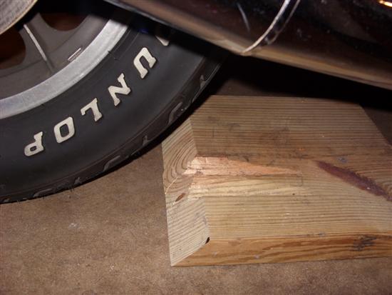

Rolling rear tire onto a wood block makes lifting bike onto center stand a piece of cake.

Many thanks Patton works like a charm. Saves my back and my wifes back....
