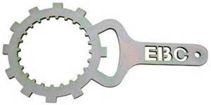

  • Thanks: 785
Re: rotor tool (alternator act) kawa part no 57001-308
19 Apr 2015 10:47
#668687
put it in 5th gear and have someone step on the rear brake. Or you can pull the clutch cover and hold the clutch basket with a clutch wrench. EBC makes those.
