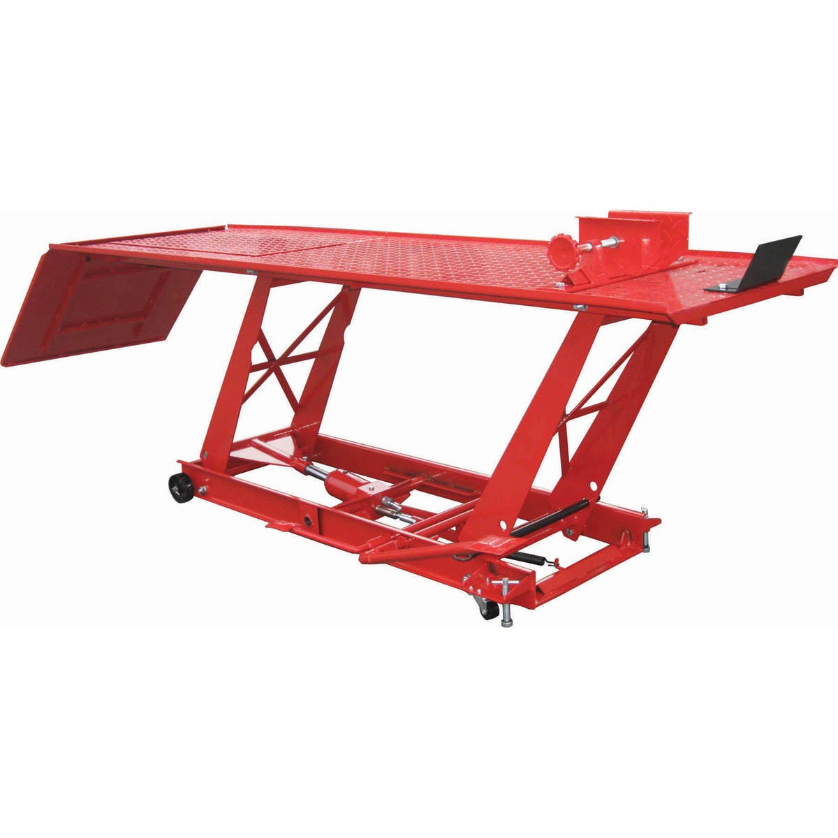

- jakedude
- Posts: 201
- Thanks: 30
Re: What lift do you like best for your KZ1000?
18 Jul 2014 12:59
The lift show by kaw-a-holic looks just like my harbor freight unit. I bought mine last year and paid $150 with a coupon I got on-line at their web site.
I added a few more tie downs. I have had my kz1000, dl650, and my gl1500 up on it. My only complaint is that when you ride the bike up onto the lift, if you center the bike on the lift, the bike side stand hangs over the edge of the lift. For my kz1000 and dl650 thats not such a big deal. I just leave a little more room on the left side so I can put the side stand down. Then I can get off the bike and put the bike on the center stand. For my gl1500 you need to have the bike centered because the bike weighs 900 lbs which is right a the limit of the lift (1000lbs). If the gl1500 is not centered, when you lift the bike the stand leans which is not safe. I plan on adding a small metal plate extension on the left side so I can put the side stand down.

- rstnick
- Posts: 4691
- Thanks: 577
18 Jul 2014 20:58 - 19 Jul 2014 18:14
I made this one out of wood I had laying around.
Used a ramp to get bikes up, 2x8x?
Not easy to store though.
Up in the rafters or on end maybe.
The small red lift below works well, with exhaust installed.

- madmatt1
- Posts: 220
- Thanks: 60
19 Jul 2014 09:54
rstnick- who makes the lift? the arms look to be adjustable, yes?

- rstnick
- Posts: 4691
- Thanks: 577
19 Jul 2014 18:07 - 19 Jul 2014 18:13madmatt1 wrote: rstnick- who makes the lift? the arms look to be adjustable, yes?
Some Chinese lift I bought at Princess Auto, a supply place.
The arms are adjustable, sliding to where you want when you loosen a nut.
I use 2X3 blocks to reach the frame with 4>1 exhaust on.
