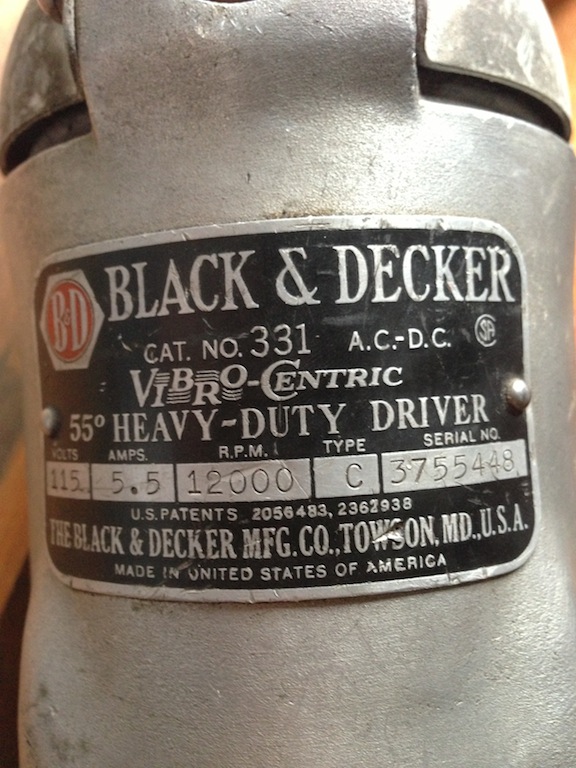

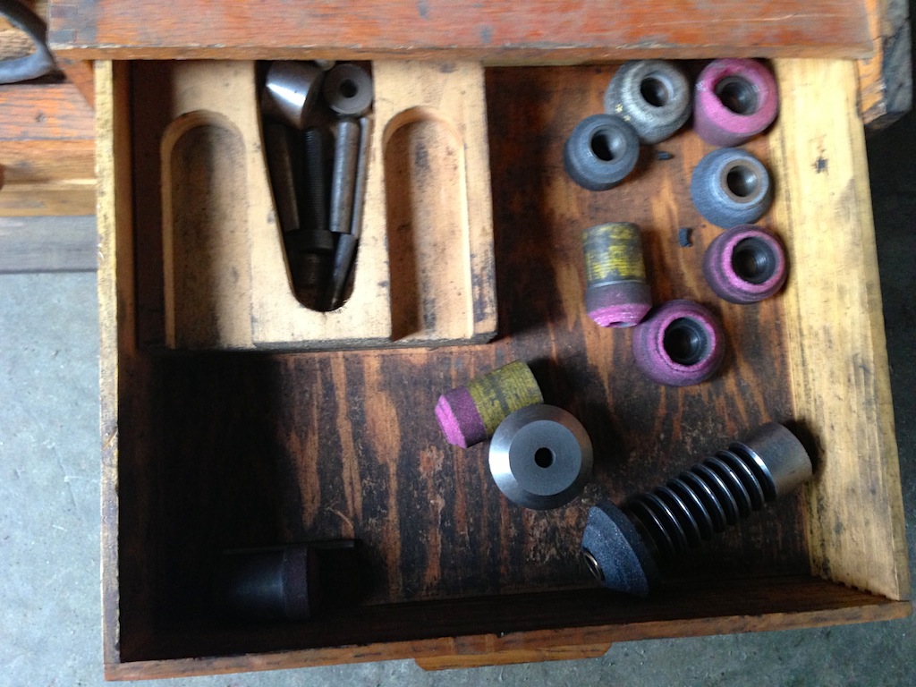

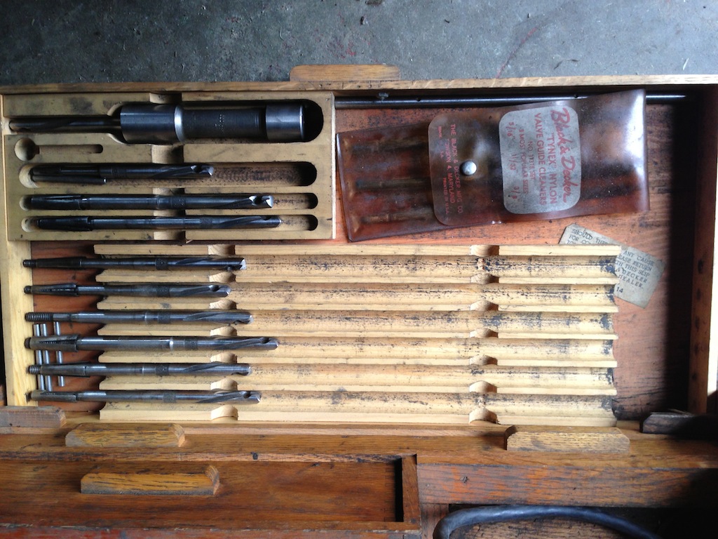

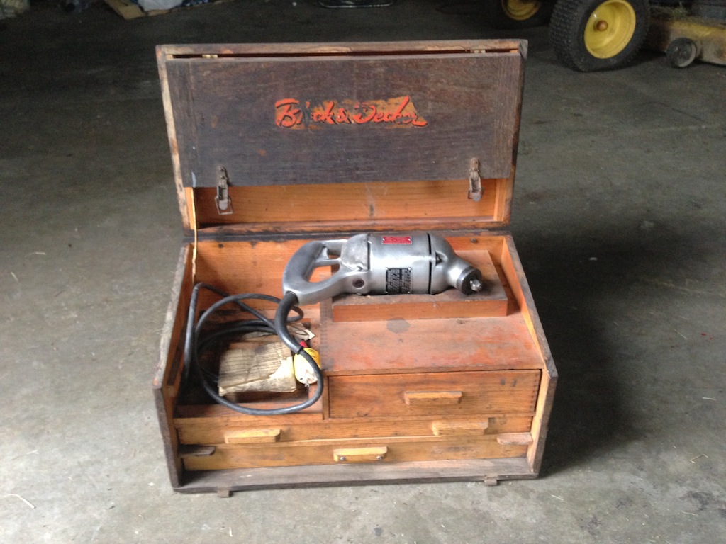

Friend of mine gave me old black and decker vibro centric valve seat grinder. I found 45° grinding stone but that's about it. Didn't see 30° and 60° stones and 7mm pilot for it. He also gave me a valve refacer that I will pick up this weekend.

You'll want more than one 7mm pilot. Get .274, .275 & .276.
Some suggestions, do with this as you please:
Stay away from expandable pilots.
Use a bounce spring.
Use Ruby stones.
Face every stone, every time you change one.
Don't even think about putting a top cut above the 45 using the grinder unless you're really practiced with it. 35 or 38 is better than 30.

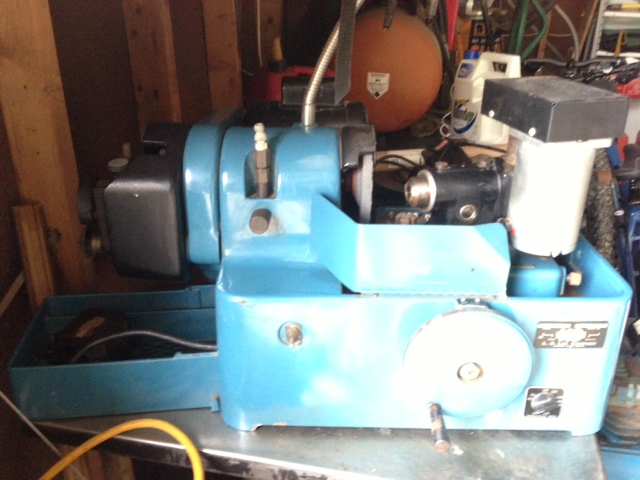

He also gave me this thing. Coolant nozzle is missing so I need to make one up. other than that looks like it is good shape. I need to learn how to use this thing too.

Looks like your missing coolant line is standard "loc-line". The stuff is common on most machine tools that need coolant.
www.loc-line.com/quarter-inch.php
I would guess that is the quarter inch size that I linked.

"40473 1/4" Mixed Element Kit $18.20". I will need elbow, straight, elbow and nozzle.

You might have to fiddle with the chuck a bit to get the valve to spin straight. Make sure you face the stone on that as well.
A spray bottle with water will work as a temporary setup. Go easy....
