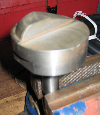

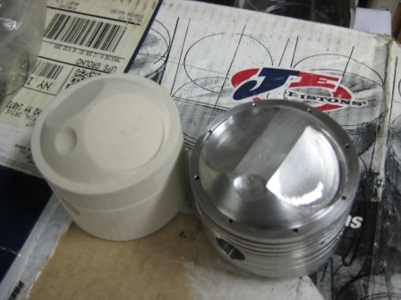

Back when I wanted to run injected alcohol I needed 16:1 or higher static to burn it efficiently. I used a off the shelf 13:1 MTC piston but found there was a lot of wasted room in the stock Kawi hemi head combustion chamber. I took Bondo casts and designed a better version of that piston then made a scraping tool that profiled the new piston crown shape by +1mm. I used the tool to scrape and remove material so the chamber just cleared the new piston achieving the higher ratio.
Custom scraping tool :
New piston 3D printed in corn starch next to old cut down 13:1 MTC :

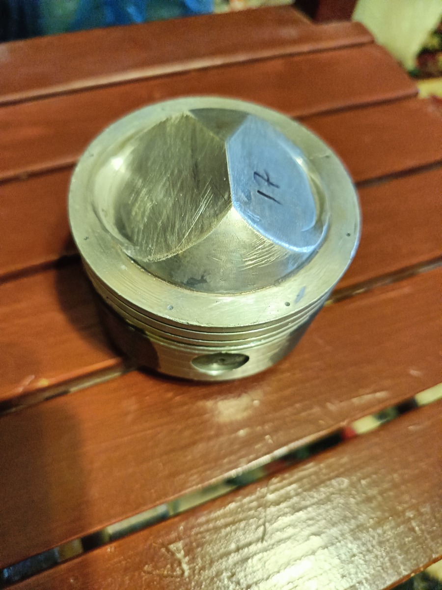

That’s top-notch work! 👍🏻 So, how did things turn out with the alcohol-fueled engine? I’ve just started working on the pistons; I decided to first eliminate potential detonation hotspots. It’s going to be a street bike, so I need good torque at low to mid-range RPMs. I might mount a cooling fan on the cylinder head, triggered by a sensor installed in the head itself—set to kick in at 115°C. Though, I’m not sure if it’ll actually make a difference.

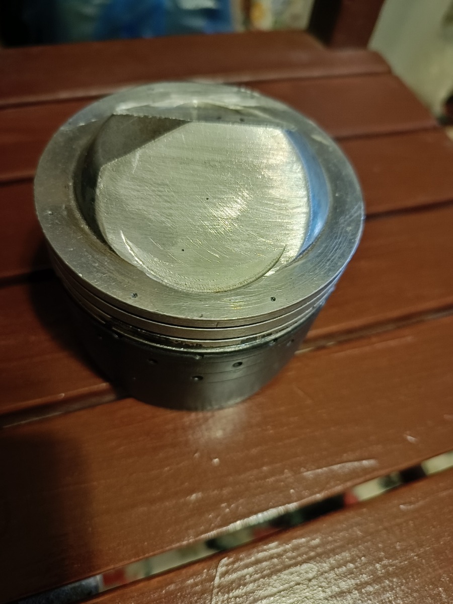

08 Oct 2026 12:14 - 08 Oct 2026 12:18That all happened about 25 years ago and the alcohol bike ran pretty good for a lot of years. I recently took it apart as I am done drag racing (check my posts on here) and that engine is going back to running on the street, so I will be tearing it down and returning back to 10:1 compression. No doubt I will be cutting down the piston domes (pretty similar to your photo) and reworking the combustion chamber or running a 6061 base spacer. For sure I have some work ahead of me.v.f. post=928318 userid=56273That’s top-notch work! 👍🏻 So, how did things turn out with the alcohol-fueled engine? I’ve just started working on the pistons; I decided to first eliminate potential detonation hotspots. It’s going to be a street bike, so I need good torque at low to mid-range RPMs.
If that is the piston your running you need to flatten that sharp ridge on the top and put some radii on all those sharp edges.
That picture I posted of the piston is currently in my street bike.
