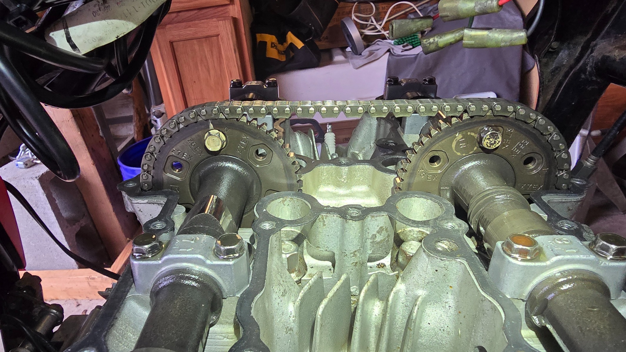

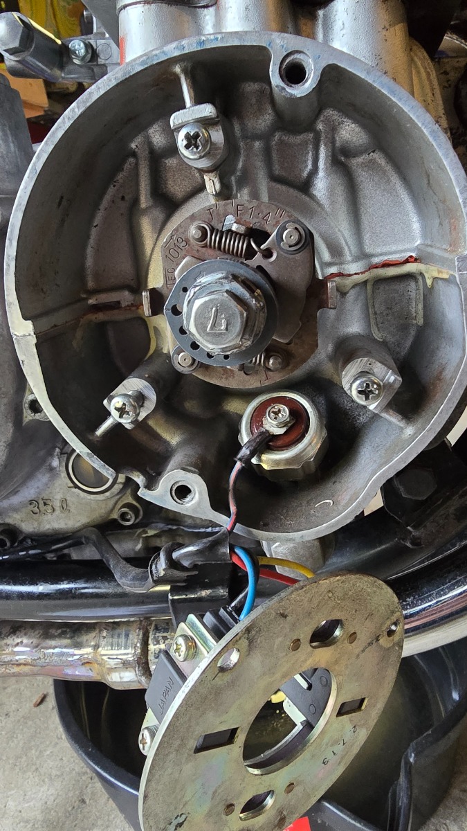

Ok so I have a 1983 Kawasaki KZ750 LTD H4 with a Wiseco big bore kit and pod filters on it, I rebuilt the entire engine, used the Dynojet stage 3 jet kit with 136 main jets, set the timing and got it idling very rough. but it could maintain idle and ride, but would have hang throttle, it would rev to 3k and then come down VERY slowly. so I figured there was an issue with timing. I pulled the top end apart and realized when tightening down the cam caps and timing chain tensioner that it advanced my timing by about 10 degrees. So I corrected it and reassembled, now that it is back together I have an issue with runaway idle, I start the bike and it wants to spike to over 3k. I checked for vacuum leaks with ether, and made sure my throttle cable was adjusted properly and not hung up on anything and made sure my bench sync on the carbs was set correctly. Given it has a big bore kit do I need to advance or retard the timing? Also I am setting timing base on my FSM on the T1 mark for TDC but see conflicting answers on forums saying to Set timing based on F1 mark. Some clarification would be great.
Added note when it was running before and even now with the runaway idle my vacuum sync gauges are pinging in the "late valve timing or leak at intake manifold" zone of the gauge. Again I checked for leaks and even replaced all my intake boots. If anybody has any idea I would be very grateful I have been running in circles with this thing.
EDIT: I included two photos of the static timing I set. And I made sure that the IN mark lands between the 45th and 46th pin as per the FSM.

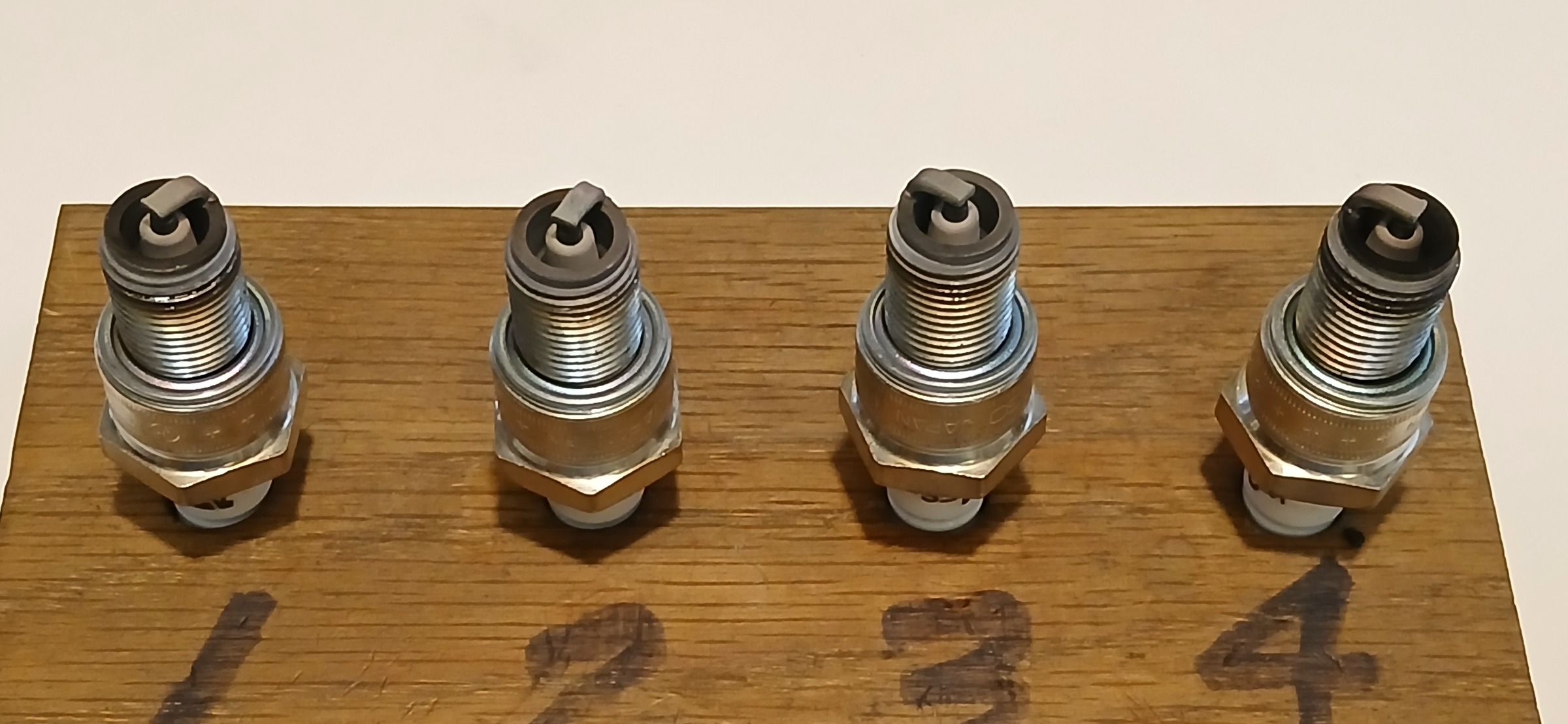

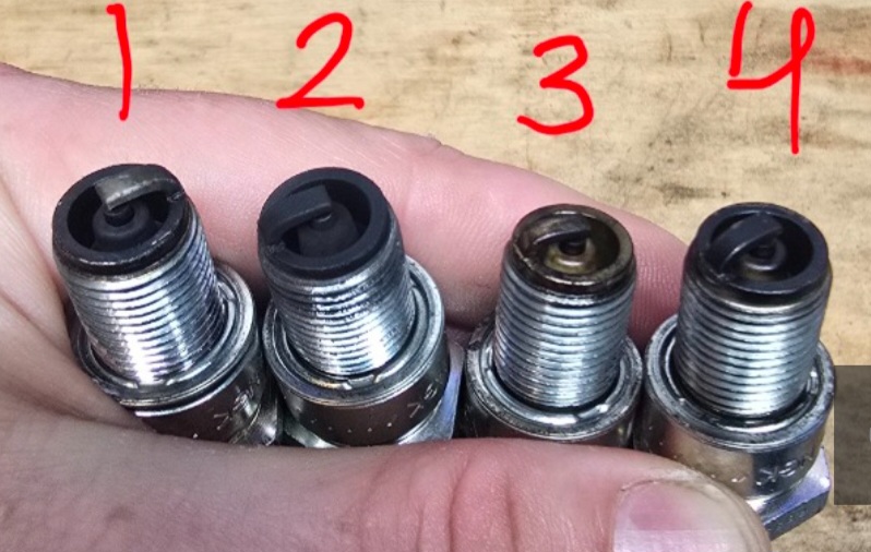

Please post an image that shows us the condition of the spark plugs.

Here you are good sir, all new plugs at time of rebuild they have probably 2 operating hours on them.

Others may disagree, but to me your plugs appear a little rich...

Also to me spark plug 3 looks wet... Are you getting strong spark?

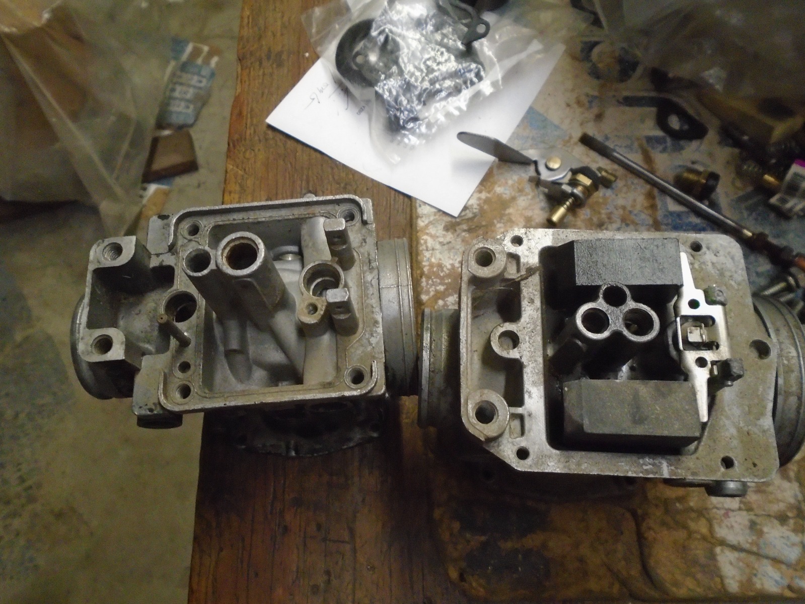

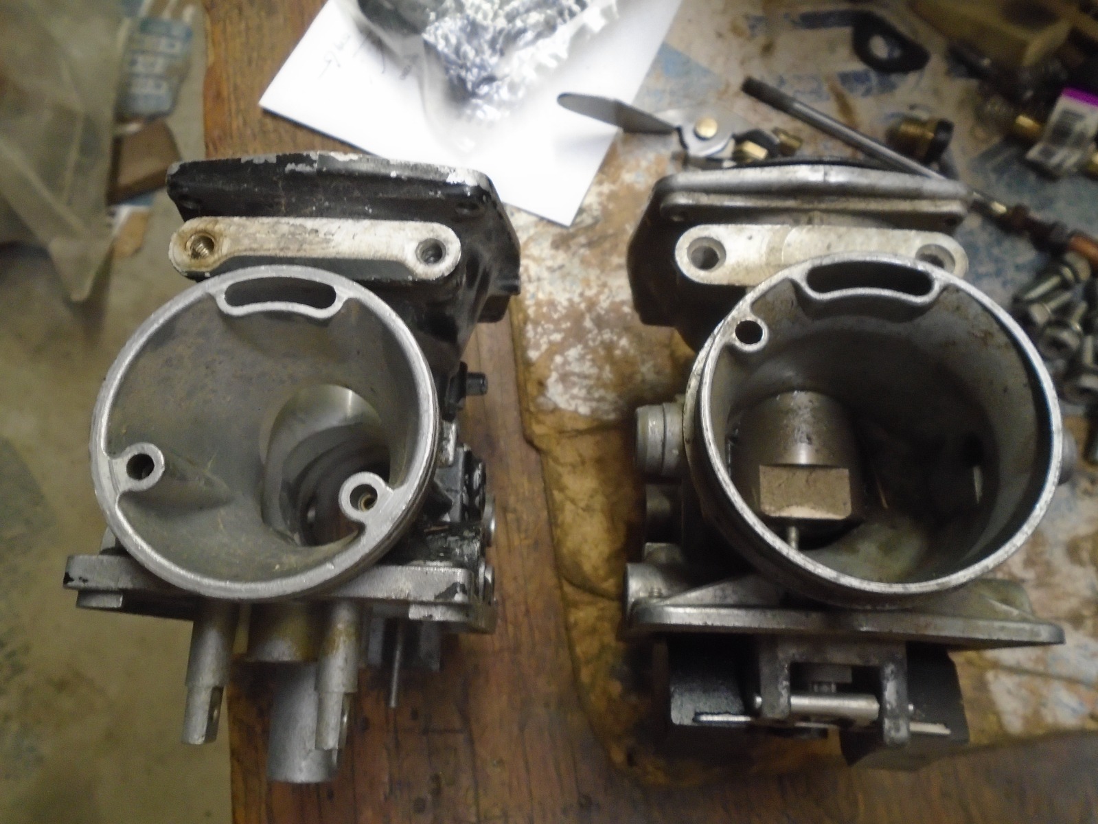

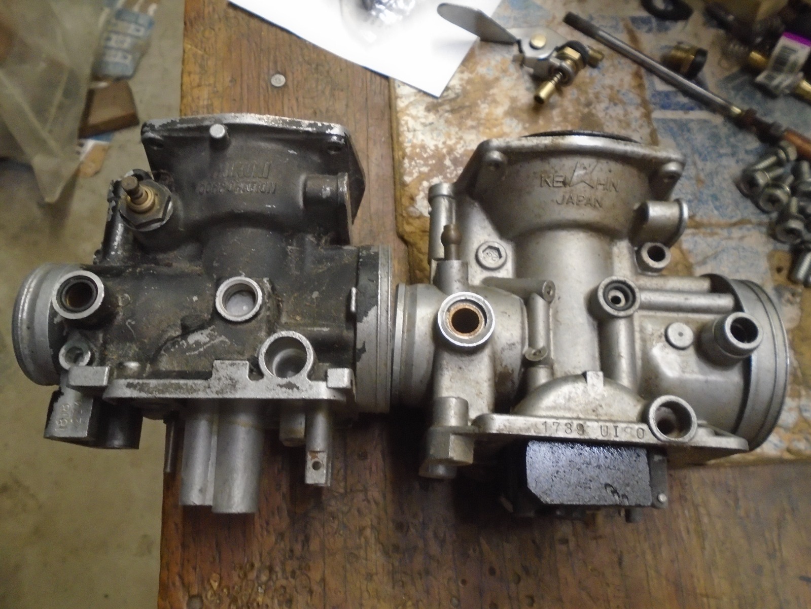

As noting this symptom happened previous to anything done. I know you bought the aftermarket kit with other jet sizes but what they supply as a stage 3 might be a bit much for other parameters your 750 doesn't have. Just because you bored it a little, vacuum dynamics won't be that much more then a stock engine. You didn't mention any other head work or change of cams? Intake restriction or pods generally affect lower running pilot, 4-1 exhaust mains. Because 1983 was a sorta transitionary era, using different brands of carbs. Do You have the Keihin CV34 or Mikuni BS34's?

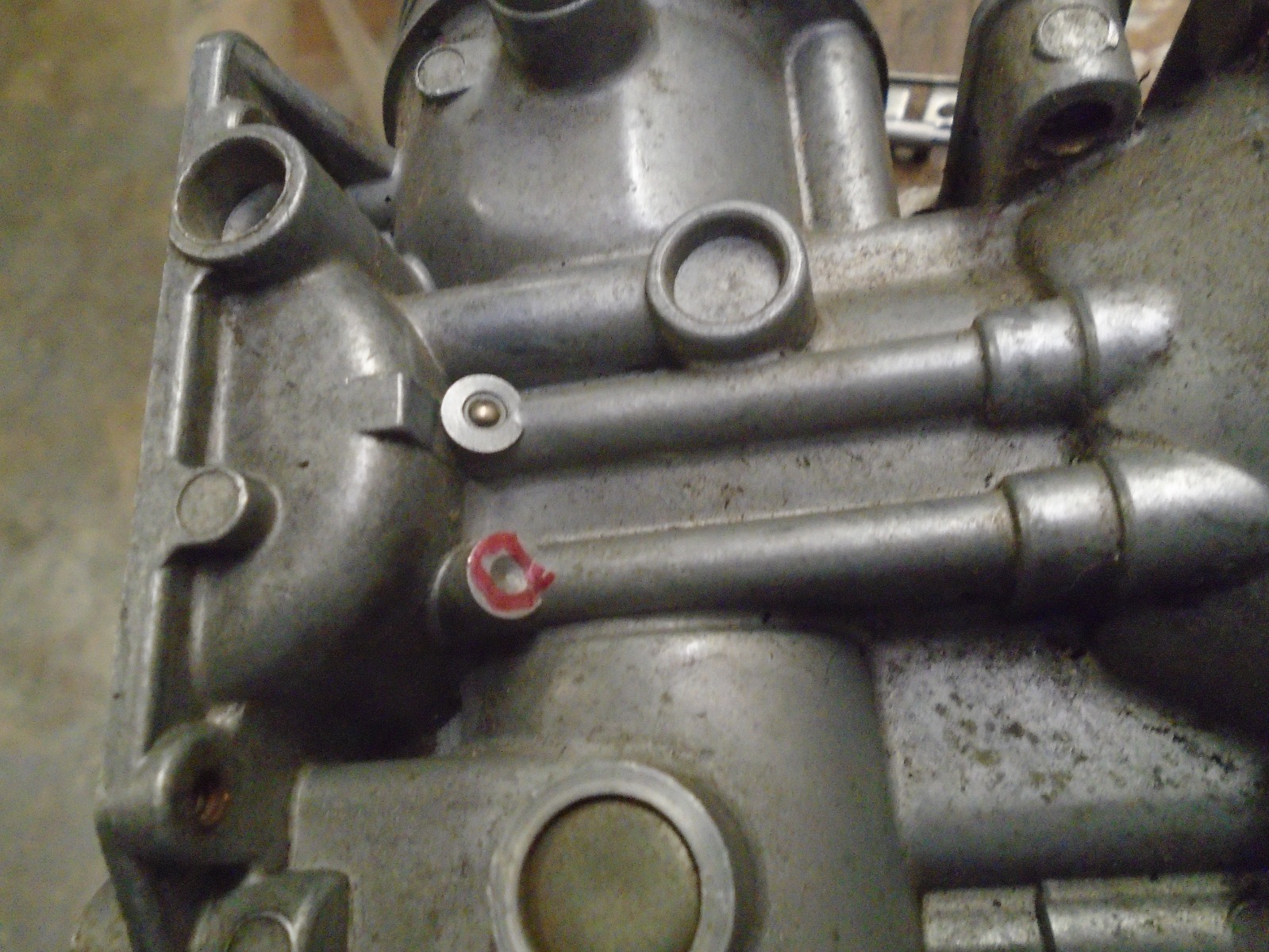

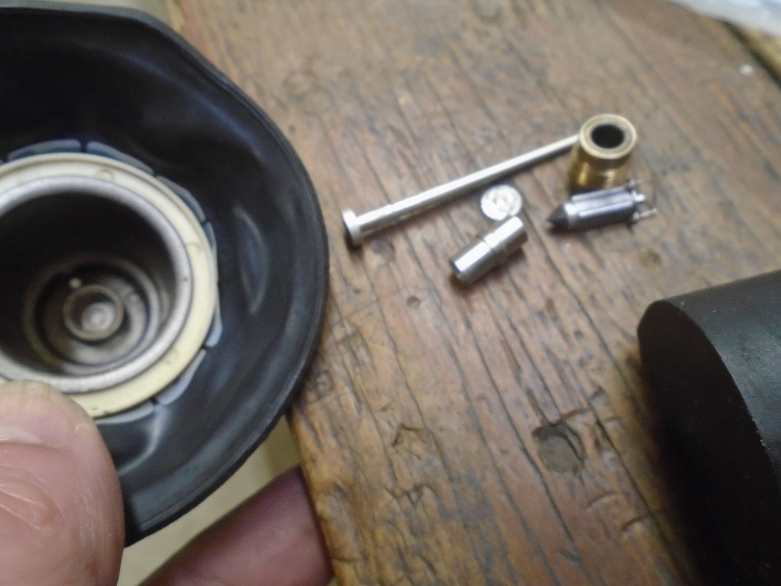

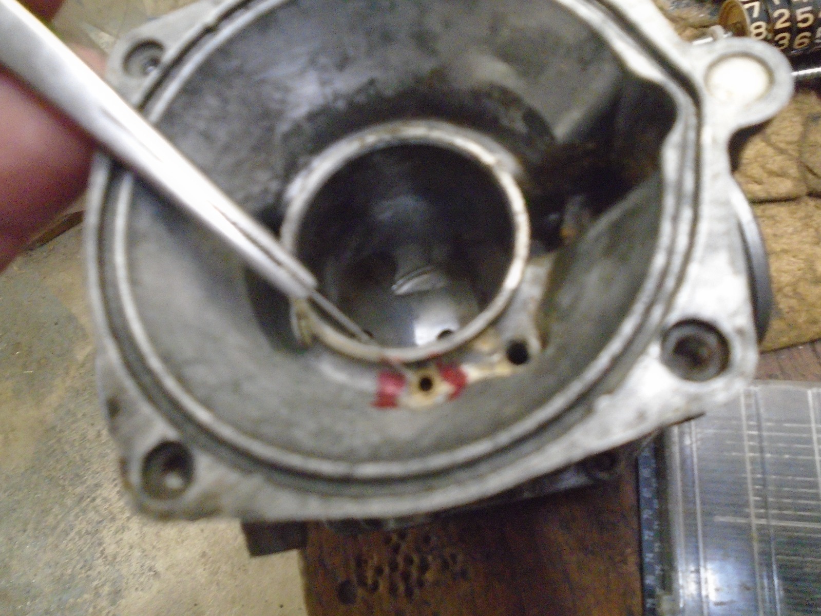

#927791
While gross looking, just grabbed them from a bin. These are BOTH the KZ750 brands/types used, Mikuni to the left in all photos. Mikuni is much easier to work on and a simpler design then the Keihin that started using 2 main jets in 1981. Once you establish your poison we can proceed further. I have a sneaking suspicion while you surely addressed the jets you might of overlooked the air correction jets or perhaps something you weren't familiar with.

I have the Keihin CV34 and had the head rebuilt, cleaned, valves seated and lashed with new stem seals. Plug 3 is wet, I have been getting an on and off miss-fire on that cylinder, I tested spark and it gets good spark but seems to not consistently fire, I set all the floats and verified with clear tubing they are all set properly and all cylinders get good compression and are within 10% of each other. It is just strange that I had it idling and rideable when the timing was off but it resulted in the hang in the throttle and now that the timing has been readjusted to the proper setting I'm getting the runaway again.

#928181
Sorry Boss, never received my time card, didn't realize i was on the clock?? Haha, just teasing YOU. Have been out prepping a gaggle of irrigation reels for winter storage. Winters coming, right JOE!! Don't want to replace thousands of feet of poly line because of water freezing and bursting lines. Anyhoot, You never mentioned which style of carb (Keihin) you had? Does it have 2 mains or just one? Pictures represent the just one main style. Lots more bits in the 2 main style. I know you concerned yourself with getting "bigger" mains and a jet kit. But does the jet needle clip support the larger hole in diaphragm? These original needles were non-adjustable and had a much larger "head"      on them. As far as a run away idle, double check your butterflies! Just recently had a similar situation topic here and he resolved it by correctly setting them. Also ALWAYS check your corresponding air correction jets per circuit! Yours are situated in two areas. Pilot air is in Venturi behind choke flap, main's (1 or 2) are underneath the diaphragm rubber. You say 10percent difference but 10 percent of what? If it were mine i would do a leak-down test to verify efficacy of build foremost and a plugged intake manifold vacuum test at TDC on compression stroke. As mentioned #3 does look oily.
