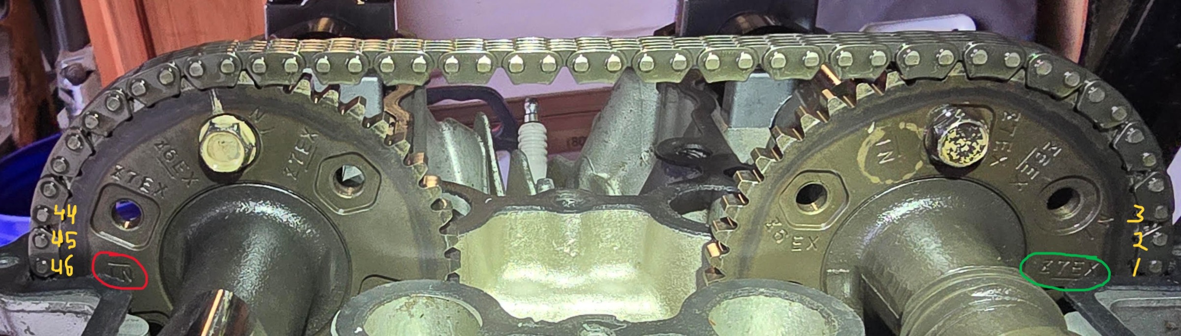

A couple of things, you say you corrected the cam timing and fitted the tensioner? It is my understanding that your bike has a hyvo chain and guide blade in the cam cover ? If so you need to set the cams with the marks aligned and the correct pin count between the cams then fit the cam cover before the tensioner- failure to do this will move the timing and over tighten the chain !! Also the timing reference I believe is a “red herring” I have never known cam timing to cause a hanging idle !

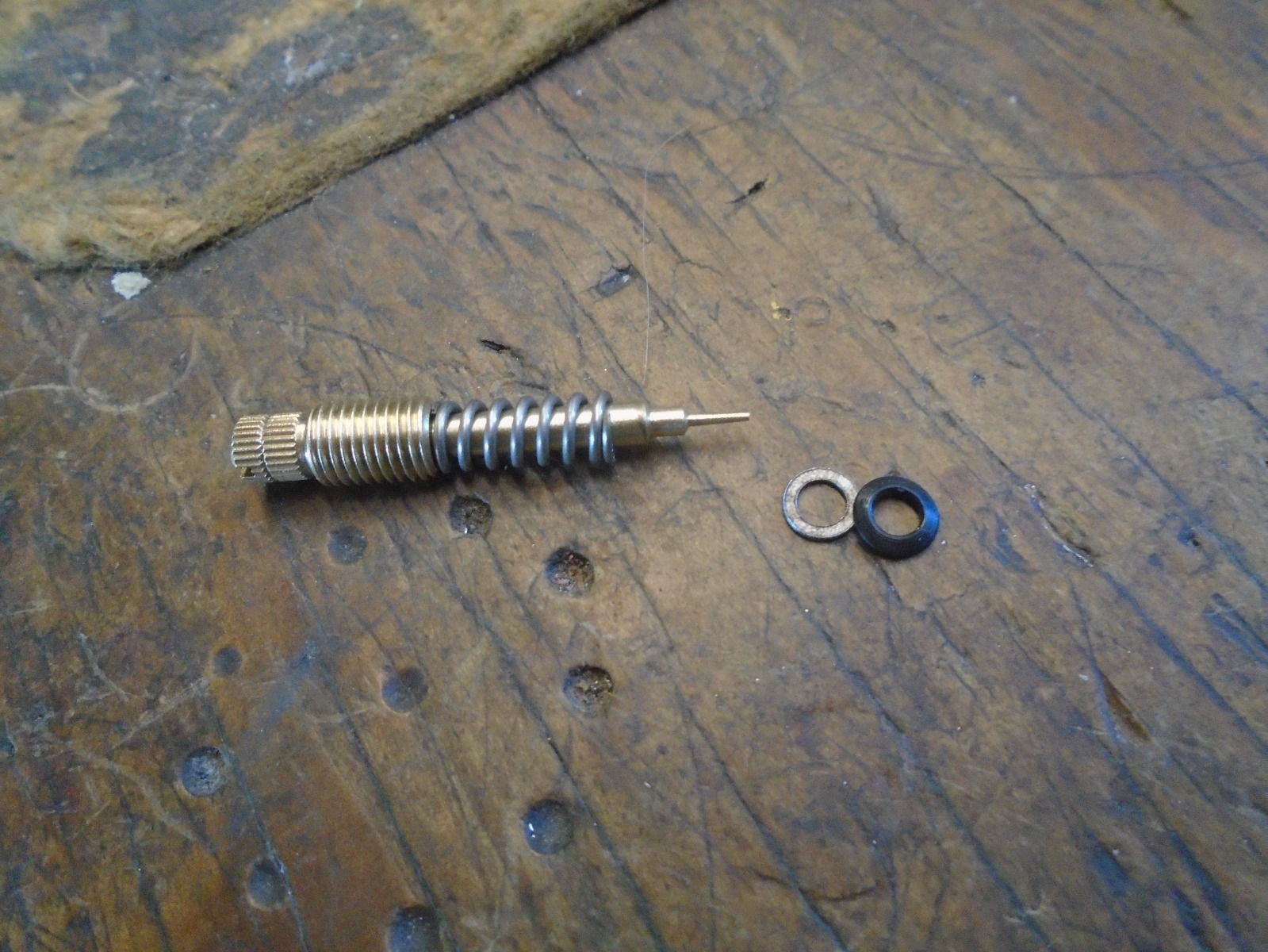

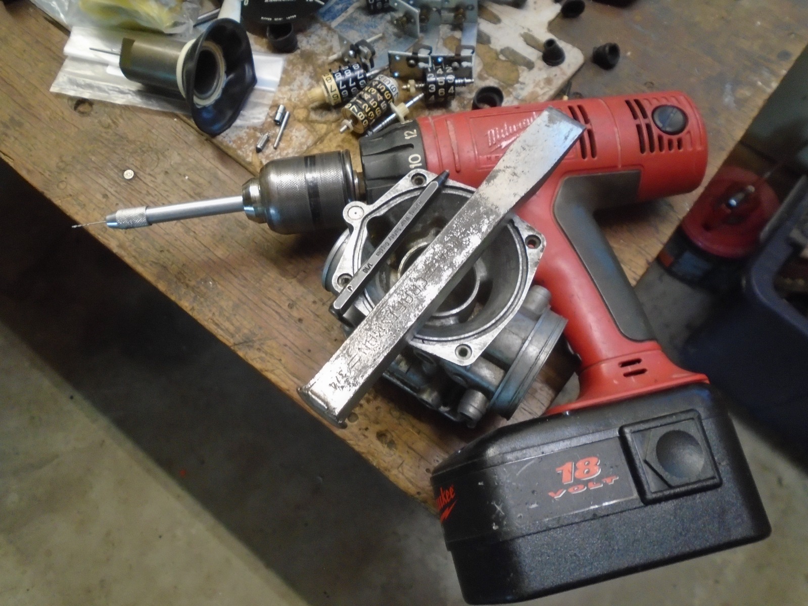

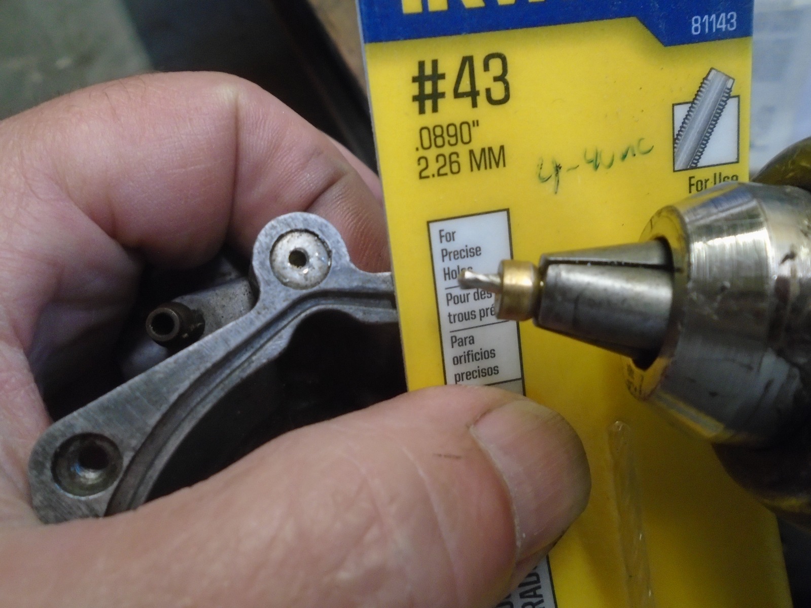

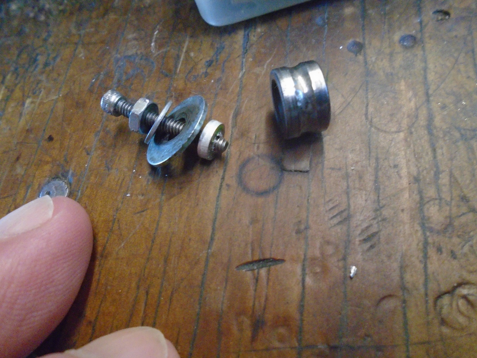

Absolutely Correct Wookie! You can change rpm with a "manual tensioner" though but would have no "hanging idle" behavior. That's a whole different bird. When you took these carbs down to base zero did you "STICK" casted holes or jets with incorrect sized cleaning crap laying around? Just cataloging procedures at this point, pics and such. I believe i know your issue Mlodge but i don't think you have the equipment to complete? I'm just farting around now but relevant to either carb version you have. This group of photos is to show proper removal of the pilot fuel screw plug without "screwing it up". I start with a chucked-up #70 twist bit in a holder mounted to a drill. This provides a pilot hole for the next #43 bit, collared so it doesn't go too far and hit the brass adjuster. Then just tap/ pull the plug out. I like the sae 4-40 tap/screw combo, course thread but easily sourced.

Pilot adjust brass screw should resemble this. Note the original screws had a shoulder milled into them so you couldn't jam them down soo far as to get the "tip" wedged into the casting hole. Aftermarket crap never takes this into account and where a lot of person's get into trouble unknowingly.

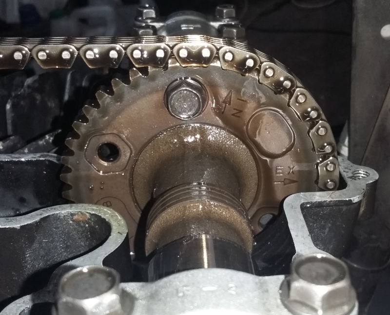

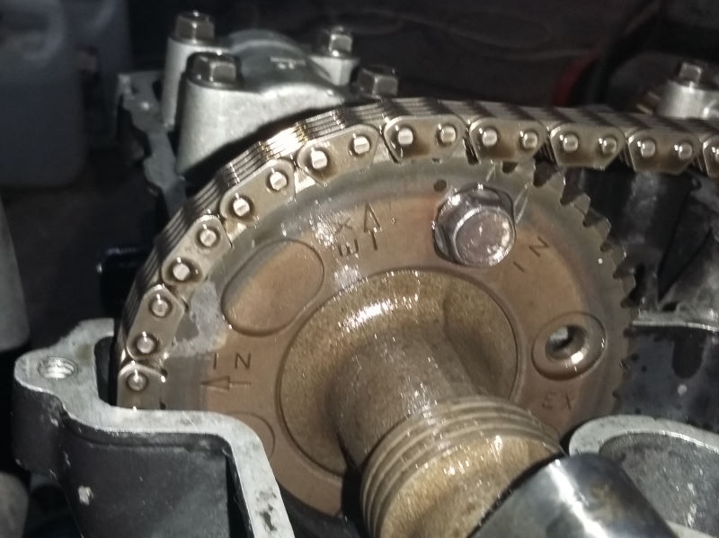

Thank you everyone for the overwhelming response so Wookie you may be on to something because I was putting the tensioner in before the valve cover so that could be a source of one of my issues. So I did take some photos of my carbs, I do have the correct pilot screw, and I have it adjusted to 3.5 turns out according to the jet kit I already used. The jet kit did come with new needles and washers/ C clips to adjust the height on them. The Style carb I have is the two main jet carb, I took some photos of my carbs so show the intake blade adjustment, the inside of the upper cover where the CV boot is, the needle and holes, I only enlarged one hole (again according to the kit and the service reps instructions). There is also a photo of the DynoJet Kits instructions I used for reference.

To be clear, the automatic cam chain tensioner operates on the "slack" side of the camshaft "drivetrain", so it can never have any influence on the "timing" relationship between the crankshaft and camshafts.
The curved Hyvo chain guide in the cam cover does indeed rotate the two cams "towards" each other, but this is taken care of by the timing arrows on each of the can sprockets.
The two timing arrows must be horizontal, opposing each other, parallel to the top of the cylinder head - when the crank is at TDC cylinder 1...

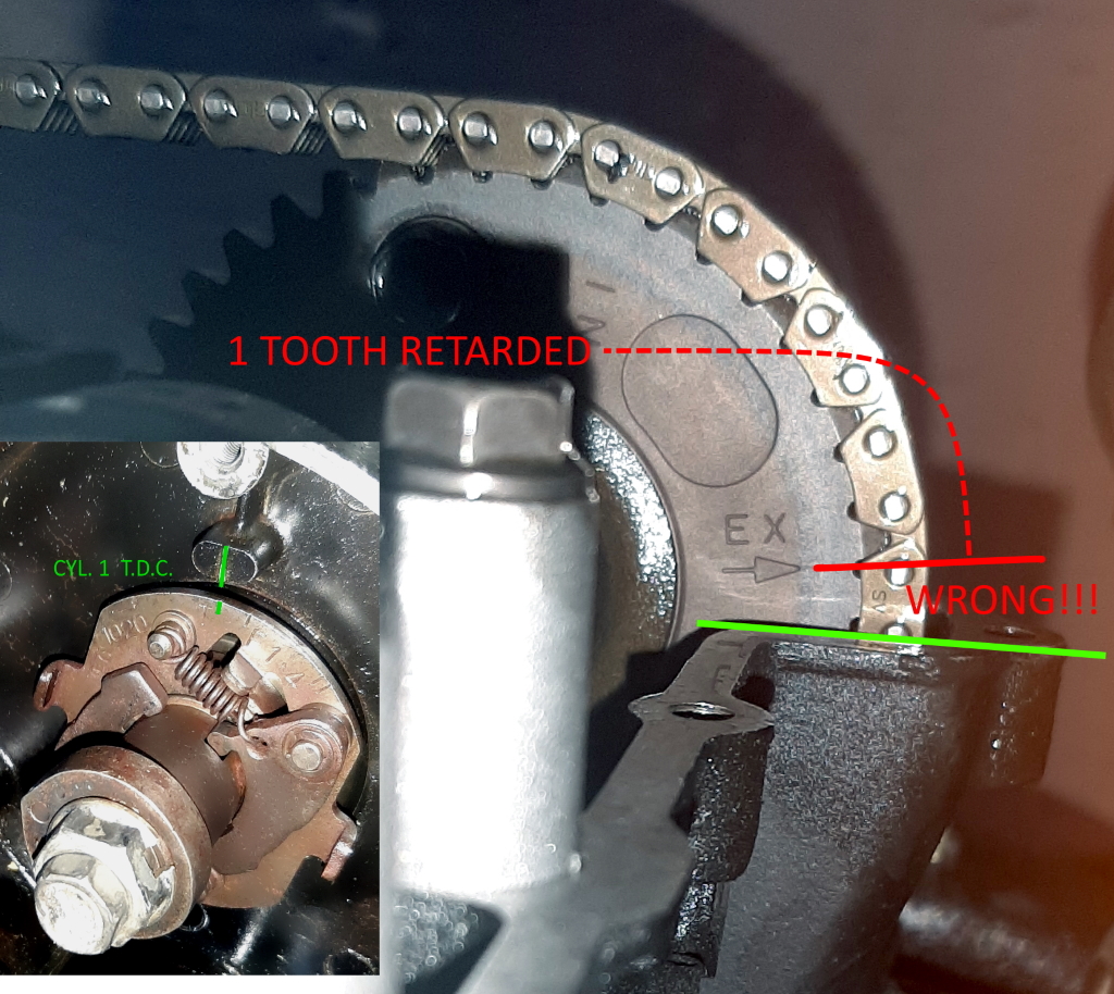

Can I add that you should rotate the engine forwards through two full turns of the crank and re-check the marks to ensure that there wasn't slack in the front of the chain when the timing was initially set

So this last time I assembled it that's what I did, made sure there was no slack ran through a few rotations and set it exactly according to the manual. This was the results and in the video I shared a link to you can hear how it runs now.
