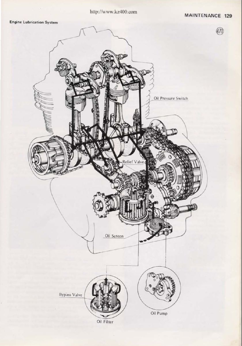

Re: Oil leak at crankshaft behind starter clutch
09 Jul 2026 21:32This has been brought up on the forum previously here .This area is supposed to be dry. No oil passage or return.
1975 kz400
Here is an oil routing diagram. See how an arrow points into the left cover area.
I just dont want you wasting your money and time.
10 Jul 2026 16:09 - 10 Jul 2026 16:15
Yes, I’ve seen that diagram. It is very hard to see, but I think it’s pointing to the end of the crankshaft inside the crank case. Again, there are no oil passages inside the stater cover and no returns.
I have also read the thread on this, and I disagree with their conclusion. In addition to this, there is a mechanic on YouTube that completely rebuilt one of these engines and also states that this area is supposed to be dry. I ran the engine with the cover off and got no oil at all.
there is an oil seal behind the dynamo/generator. I believe this is leaking on mine and I am in the process of ordering a new one to get it replaced. Must only be leaking when it’s under load or when it gets hot.
