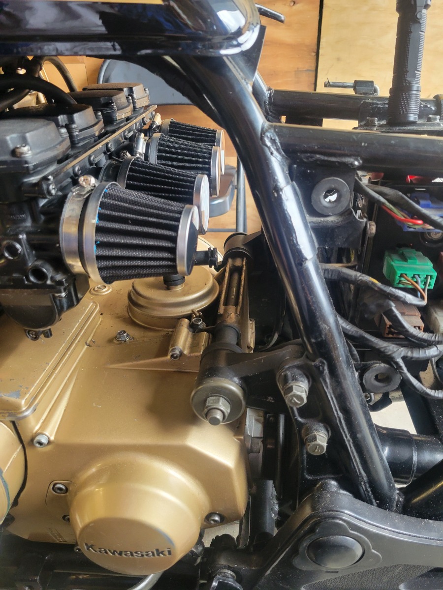

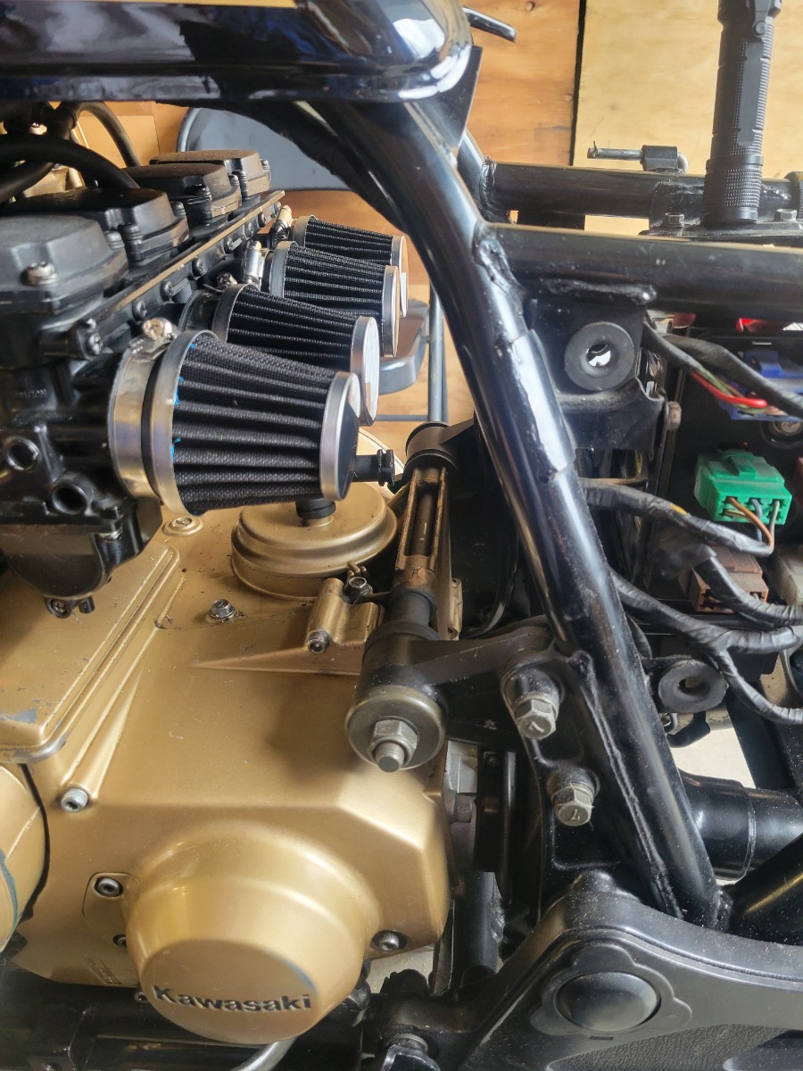

She don't sound like she did last year one issue I think is I put the pods on and it's running like crap I believe it's the pods I got to go to the stock air filter.
I got the boots soaking and wintergreen oil and alcohol it says that will soften the rubber in three or four days I will see and I will let you guys know.

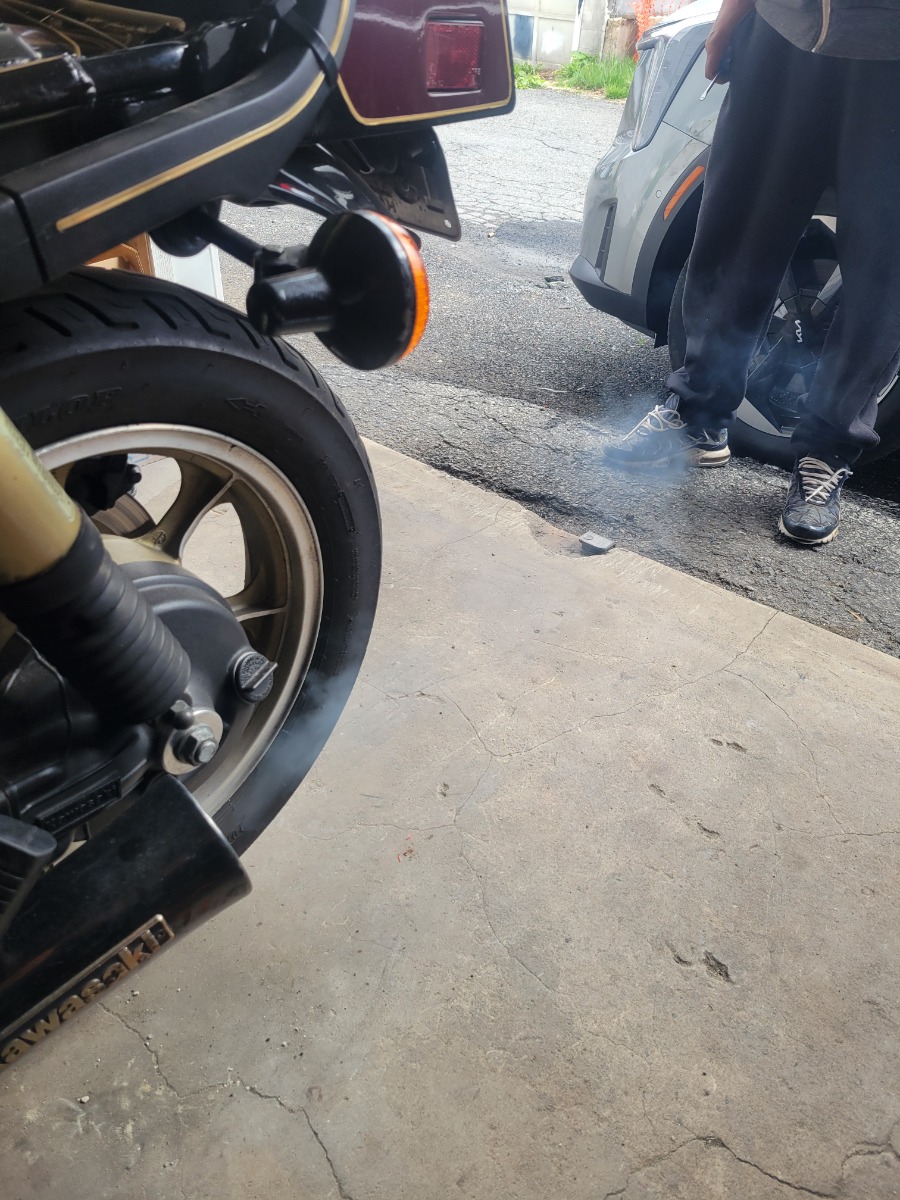

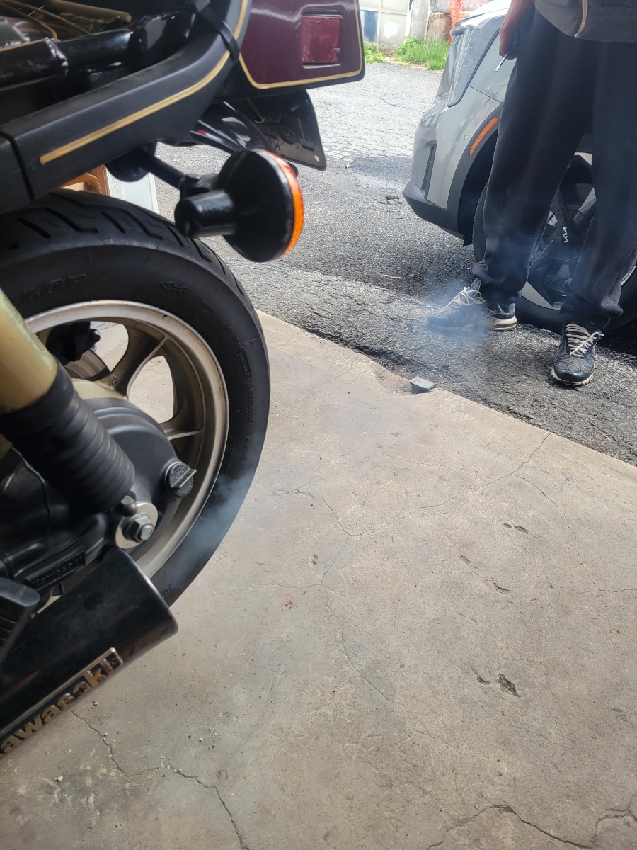

But she's smoking a little bit out of the exhaust and I'm just concerned I hope it ain't from the new rings I hope it ain't from the new valve guide seals so my problem is I got to wait till the boots soften up so I can put the stock air filter on so I got a picture of the smoke maybe it's normal cuz it's the first time after a rebuild I don't know I didn't want to run it long.

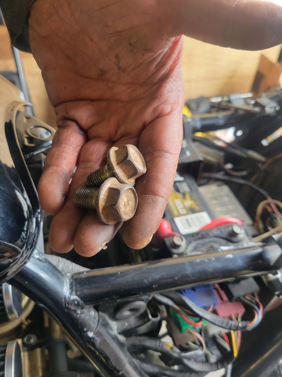

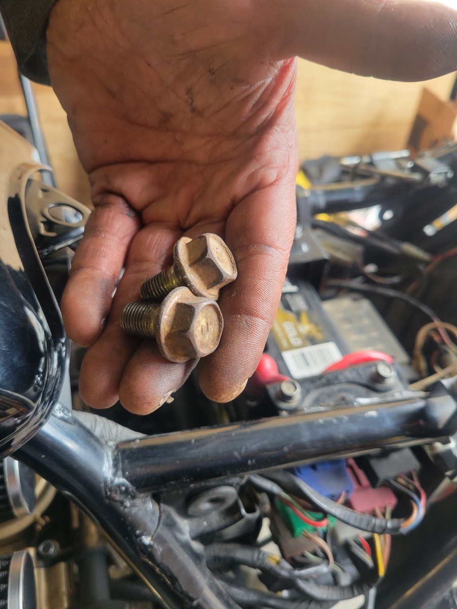

And there's two bolts that I don't know where the hell they came from and if somebody can tell me I would appreciate it I will post pictures of everything thank you in advance

A little smoke while the assembly lube burns off is normal

Yes, how much and how long will depend on the amount of lube you used during assembly

Wookie is this little bit of smoke normal well I can't seem to get it to upload I tried converting it and even a converted file and compressed is too large I'm going to put a link to Facebook and if you can look at that and tell me if that's too much smoke which I think it is let me know please

Until you have put some miles on it I wouldn’t worry too much- everything needs to bed in (I did watch the video)

Thank you I did use a lot of assembly Lube and I will be putting back the original air box one question I think I got the reeds in upside down basically the air travels from the engine up out back into the airbox correct I think I have the opposite
