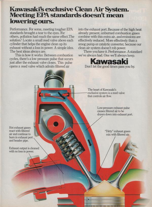

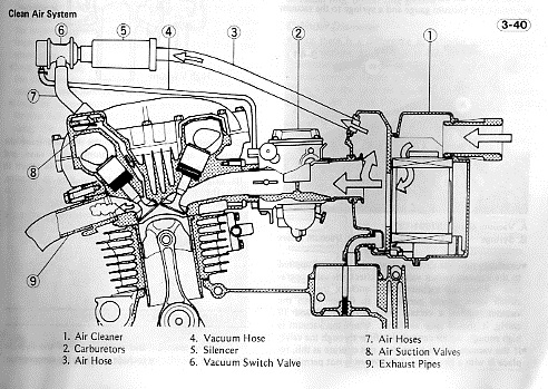

01 May 2026 09:56 - 01 May 2026 10:01No!Thank you I did use a lot of assembly Lube and I will be putting back the original air box one question I think I got the reeds in upside down basically the air travels from the engine up out back into the airbox correct I think I have the opposite
The air should travel from the airbox to the engine.
It actually bleeds air from the airbox into the exhaust .
It is not an engine breather or egr system.
It is a cheat which allowed the bike to comply with strict Californian emissions regs by diluting the exhaust gasses with fresh air to reduce the parts per million count.

Yes thank you said I just finished looking at the diagram and I see that I got a PDF manual and I wasn't 100% sure but I did get it correct and going into the engine I was second guessing thinking the air was coming from the crankcase into the breather box back into the carburetor to be reburned

No, air bleeds from the air box into the exhaust to reduce emissions. The reeds should stop exhaust gasses going into the air box
