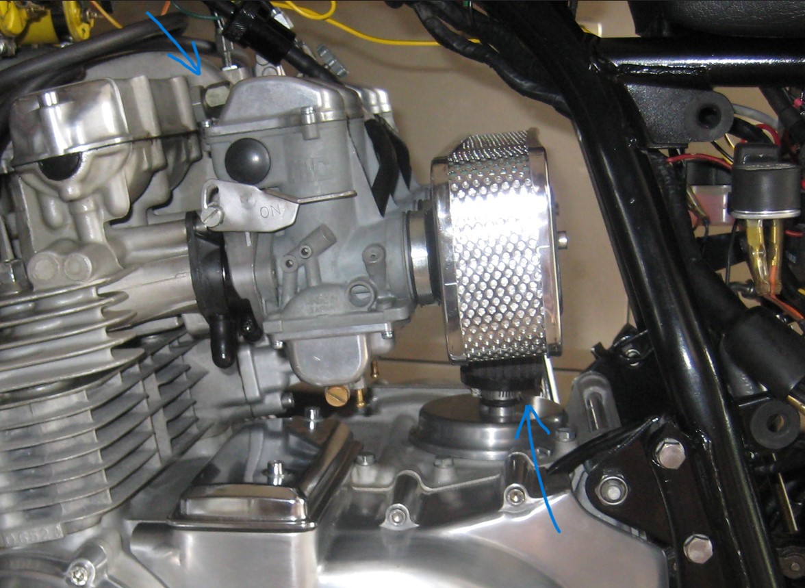

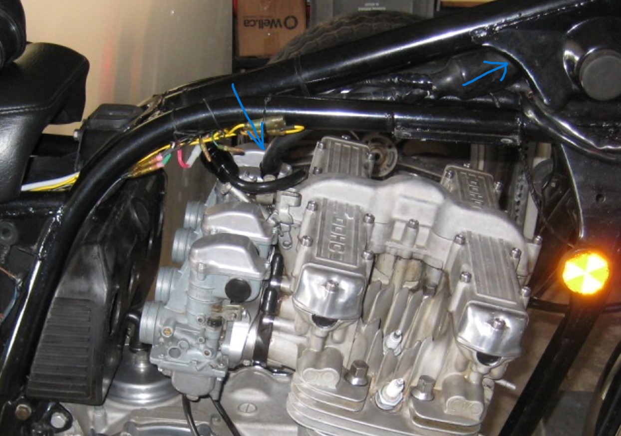

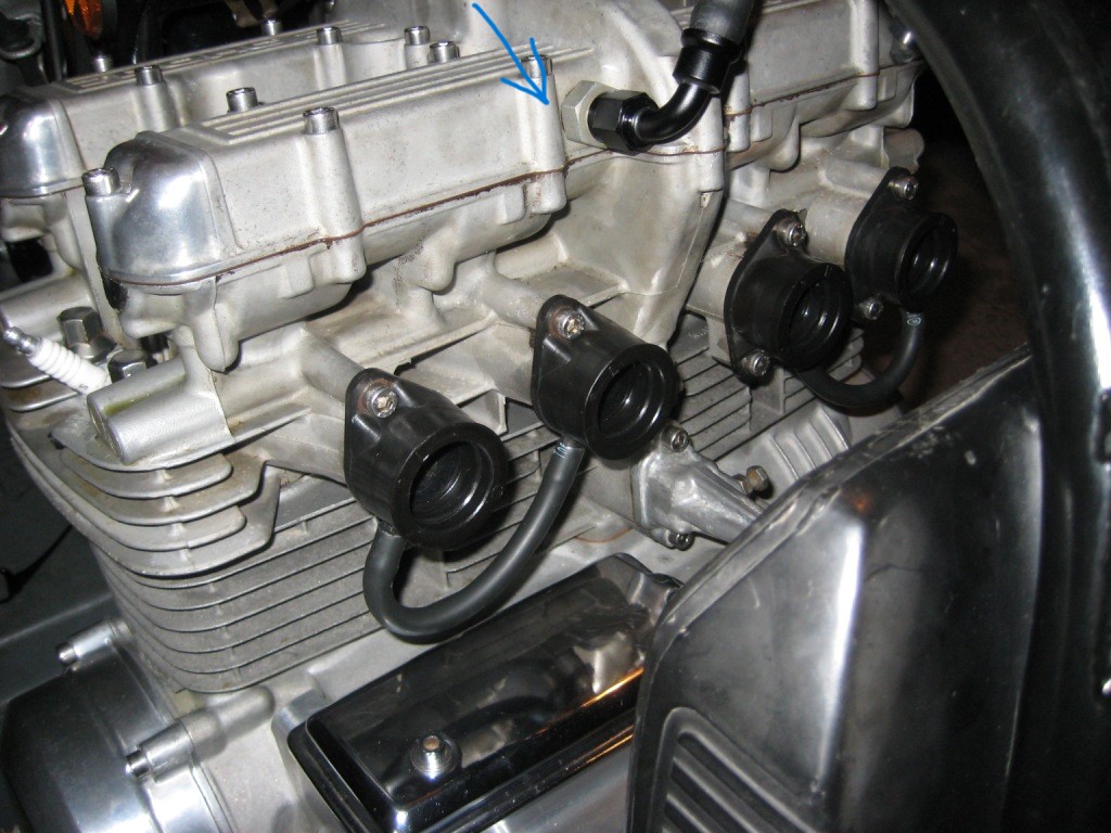

I have always run extra vents on my enlarged engines, no pcv just straight to atmosphre thru a small K&N type filter.
On my 831cc 650 engine I run a -6AN fitting on the cam cover in addition to the air box vent. You can enlarge the stock vent fitting outlet slightly. The cam cover vent runs a hose up under the top frame tube and terminates with a filter hidden next to the frame neck gussets.

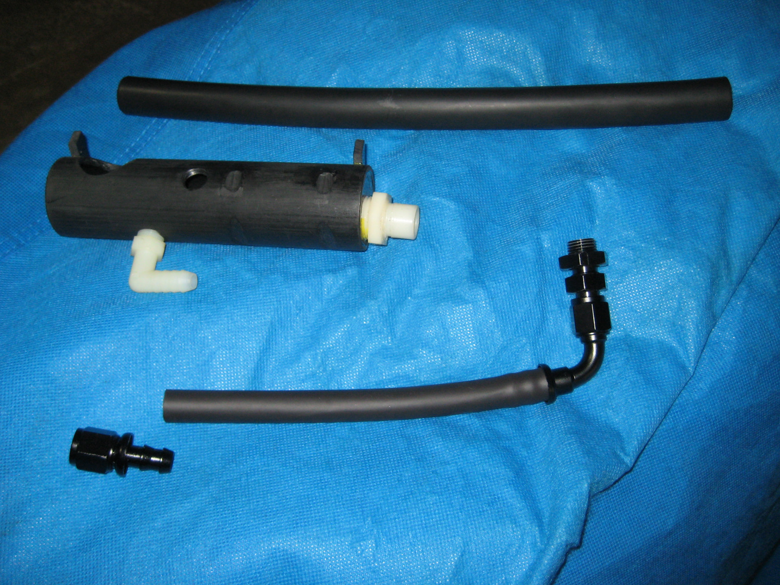

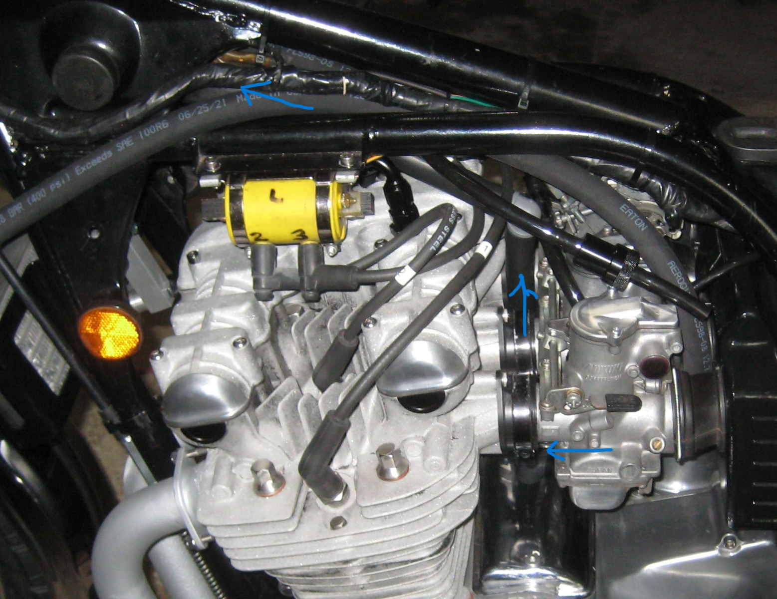

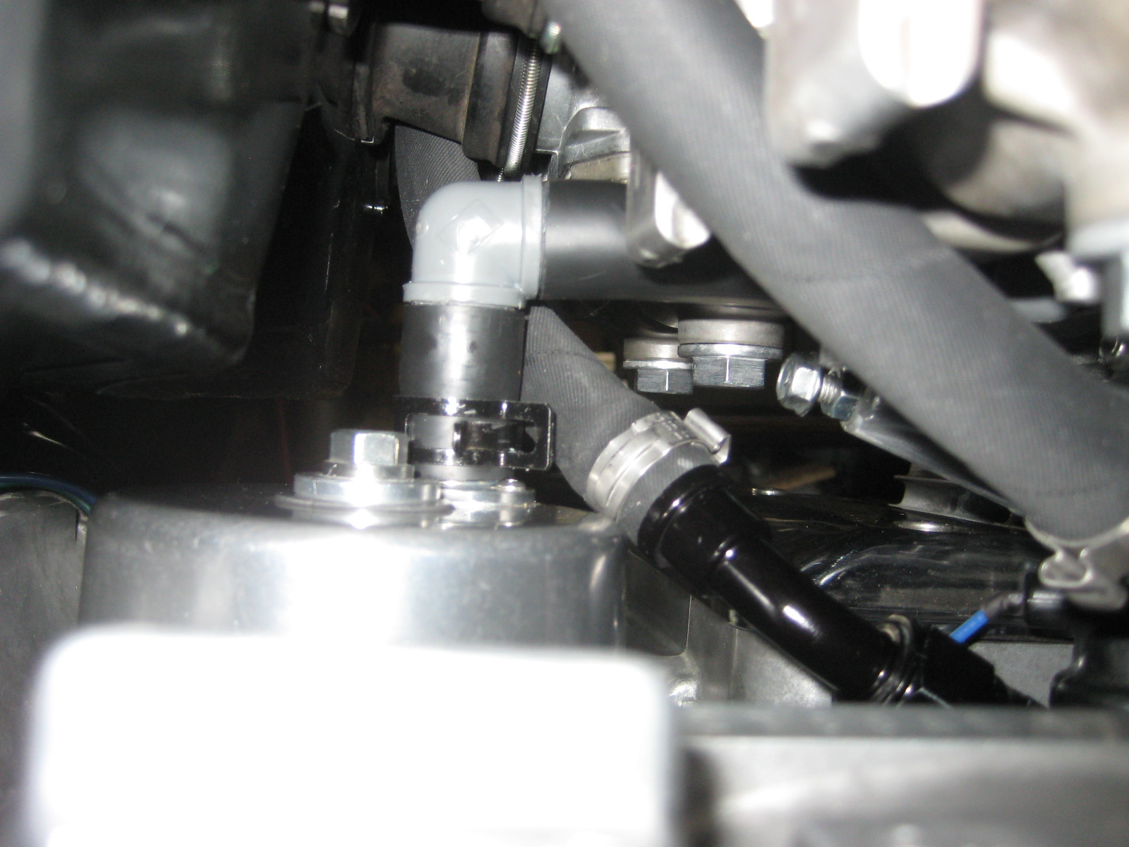

I don't have great pics of the install. That engine was pulled and a 1197cc Z1 replaced it with a different vent system that has two lines terminating into a ABS pipe.
The Z1 is vented from a fitting bolted to the modified top breather cover and a fitting on the cam cover. Both vent lines terminate next to the steering tube behind the frame neck gussets.
I see your engine has a Zephyr top end and a air box. When using the stock air box the cam cover is the only other option unless you want to drill and tap the stock cover for another fitting then have it run to a small breather.
Just leave the air box setup as is and put a -6AN bulkhead fitting on the top of the cam cover like I did with my Z1 build. You don't need to build a ABS catch can like I did, just install a tiny filter on the end of the vent hose.

Hey Injected, I notice in one of your pics you have the carb manifold vacuum fittings tied in pairs.  Is that a carb balance thing?
I did not have any proper rubber caps at that time, so sorted it out later. It was a quick fix that works, but I don't like how it looks.

Did it seem to have any effect on the sync of the carbs?
No and I did not notice any difference in the way it ran with those ports joined.
