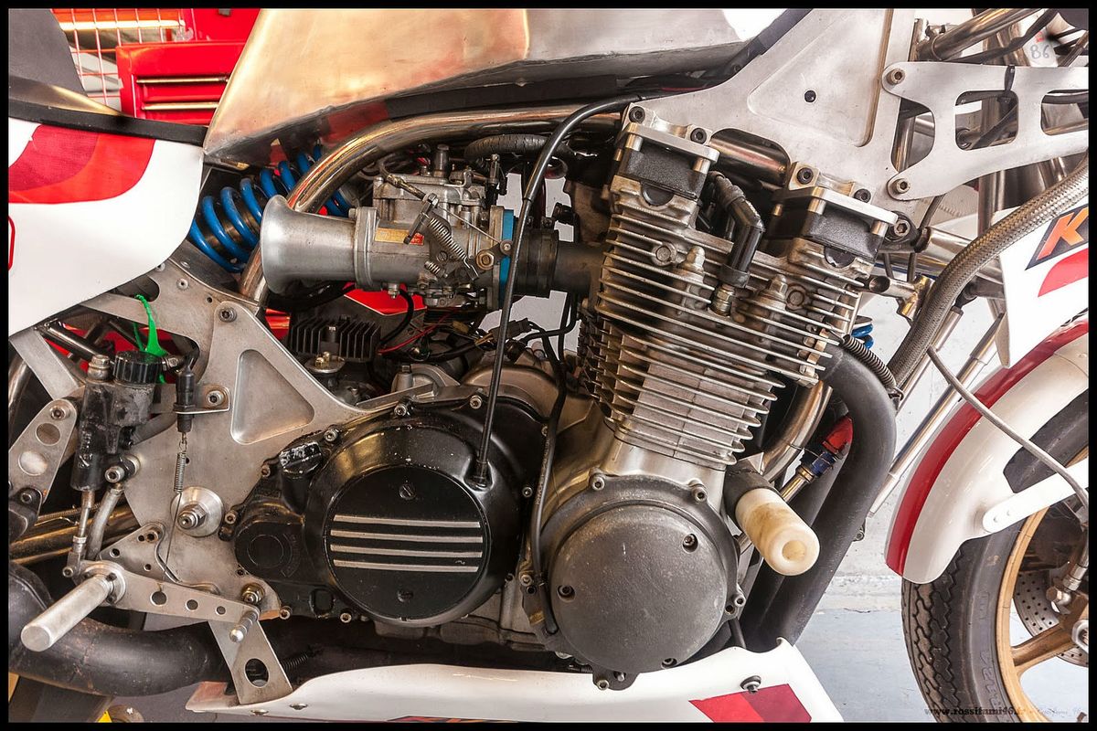

I'm jealous. I have thought about doing that as I've I had DCOE's on two cars. They are not easy to set up, the best way is an expert with a dyno. I have a CNC router an could easily cut the end plates out of aluminum. probably some 1-1/4" aluminum conduit for the tubes. On Webers on a car adjustments are easy all the jets are available from a plate on the top of the carb.
