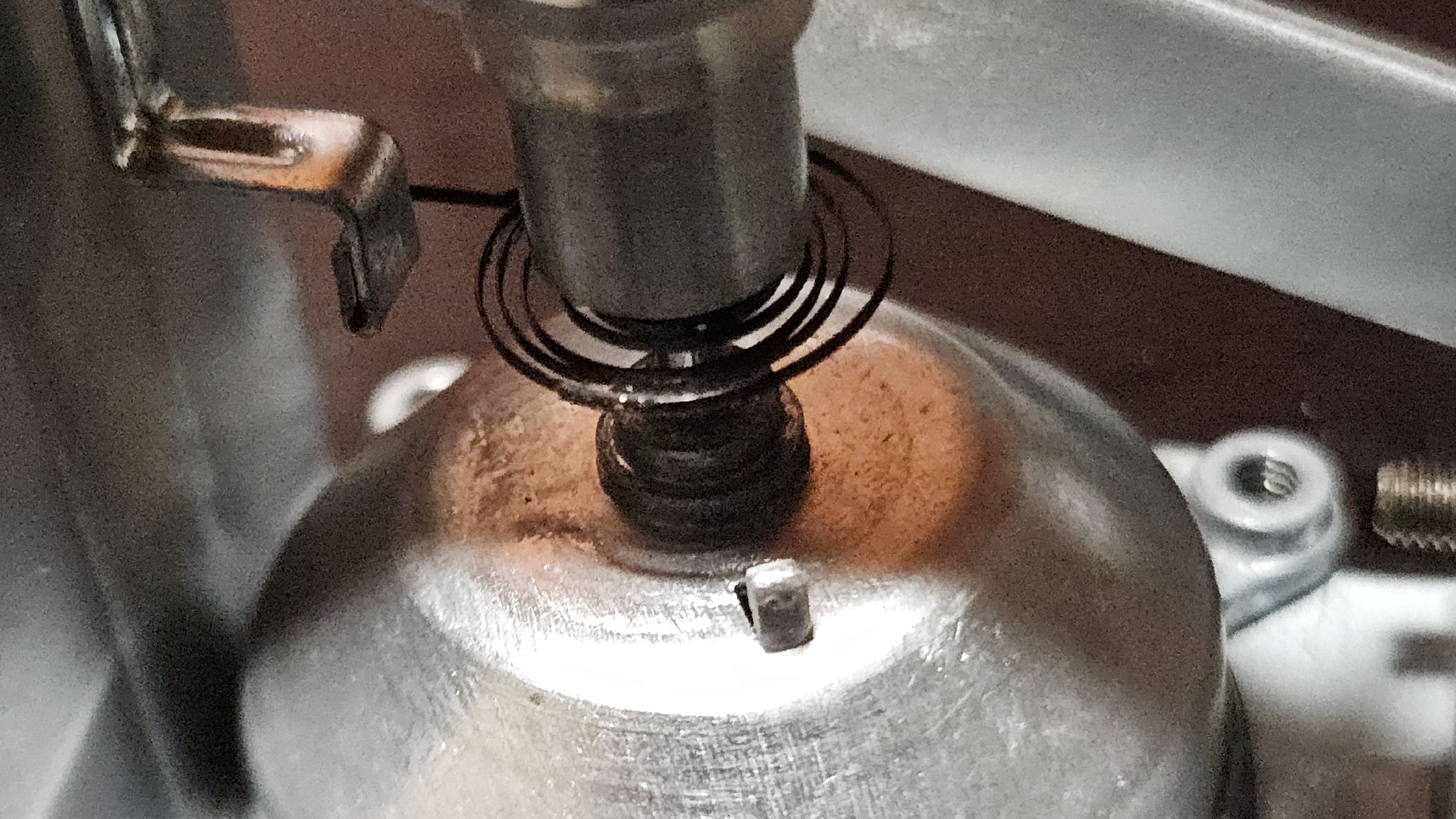

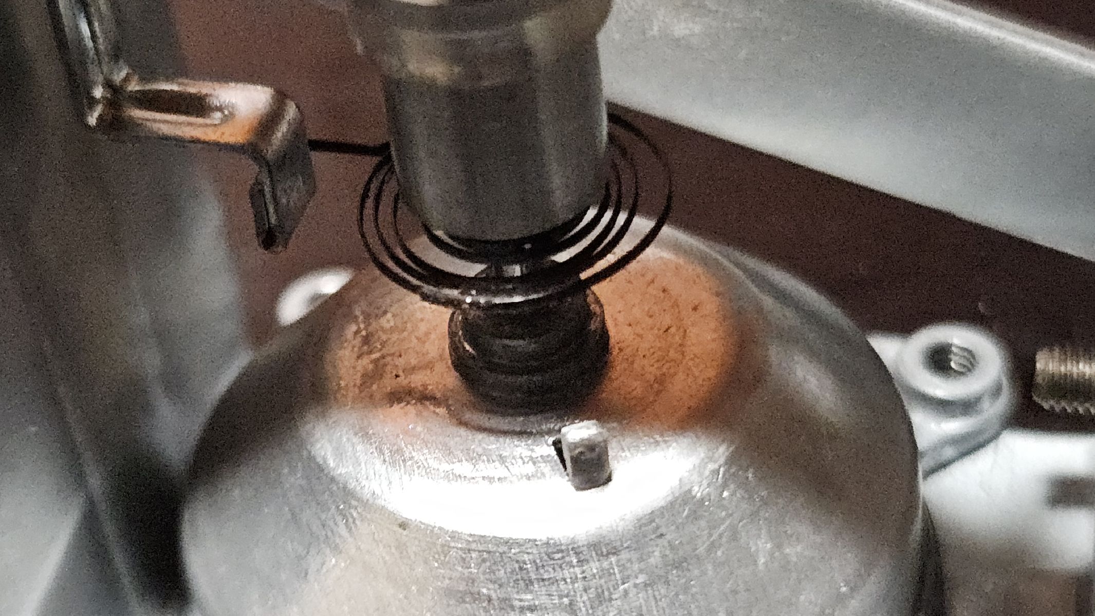

Alright... so ummm... i was right about the spring being weak... it's broke when I was messing with it carefully. Im currently jb welding it so hope that's a good temporary solution. It'll have to wait for tomorrow...

Alright, so I couldn't update you guys cause the power went out but I did manage to learn that the spring in the center really affects the reading of the needle. After repairing the spring, the needle moved back to 0 way faster since the spring was essentially shortened. From reading 10.5k rpm before at max drill speed it now reads 8.5k rpm which is way too low. I broke the needle again, repaired it, and messed with it to make it "longer" and now it reads about 10.5k rpm again.
Basically what I learned is that by making the spring have more force bringing the needle back to 0, the lower your reading will be. So in theory if those people who have optimistic speedometers wind the spring counter-clockwise (I used the needle to do this) to stretch the spring more open to cause the needle to wind back more, their reading should be closer to home (or too far). However this is just my guess and someone else would have to verify what I'm saying by trying it. It's too bad that my spring broke cause there was a kink in it.
