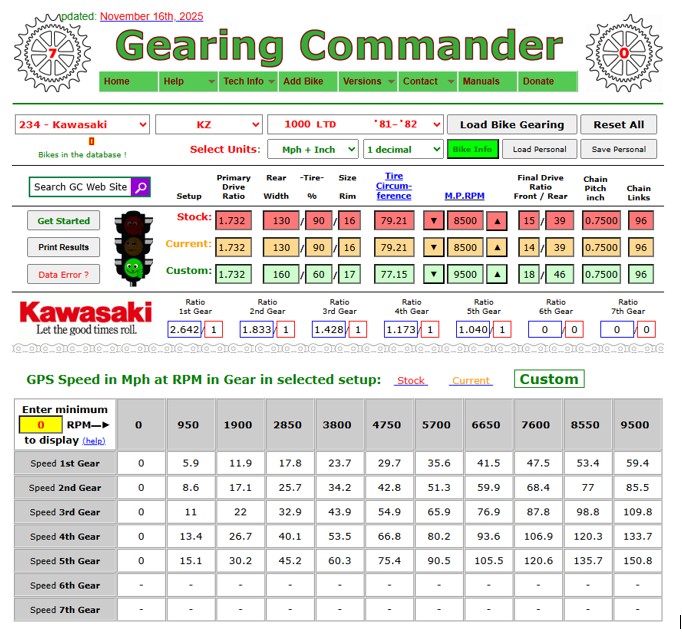

24 Nov 2025 08:10Sounds about right (the calculator will confirm) I am running (when it's finished) 18 - 46 on my 82 Ltd but that has 17inch zx9r/Bandit 600 wheelsThanks! I was thinking of going 18 in front and 44 in rear which would drop my rpm by 200 at 70mph. I don't want anything to crazy so I'm keeping the front sprocket the same diameter. Please let me know if there is anything to be wary of concerning the sprockets.

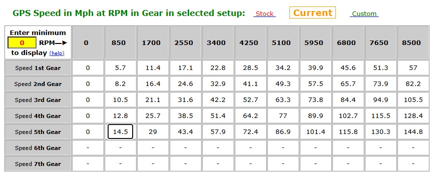

24 Nov 2025 08:50Your are only dropping from 2.6:1 down to 2.44:1 so I can't see it being an issueI'm curious, where does that put you at for rpms and acceleration? My concern in lowering my rpms is making it too hard to take off in first.
My set-up
Your set-up with 18-44

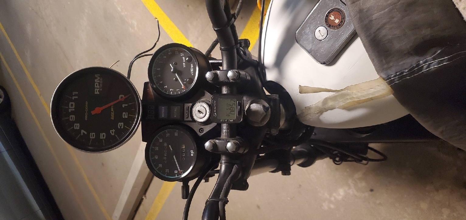

I had a similar issue with my tach.
It would be accurate to 5000rpm then it would read high.
I always thought I was at redline when I wasn't even close.
I mounted a Autometer Monster tach(got it for $24) just to verify my rpm.
The stock tach reads high by at least 2000rpm.
Anyway, I bought a Uni-T non-contact laser tachometer(UT373--about $30). Put a small dot of included reflective tape on the timing advance bolt and checked the tach against it (take off the clear plastic on the reflective tape).
The Autometer tach is good---old Kawa tach bad.
I have a feeling a lot of old bikes with cable driven tachs suffer the same problem---inaccurate as the engine spins faster.
ps... on the handlebar is a Sigma BC 5.12 bicycle computer($30).
I use this for checking my speedometer as well as having a clock.
It can measure up to 199.8 kmh/ 124.15mph.
meters.uni-trend.com/product/ut373/

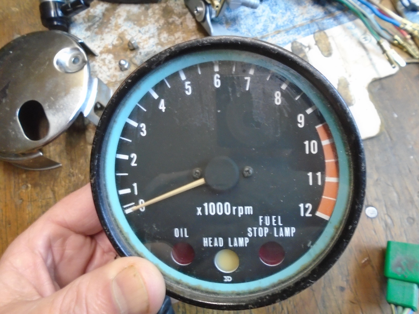

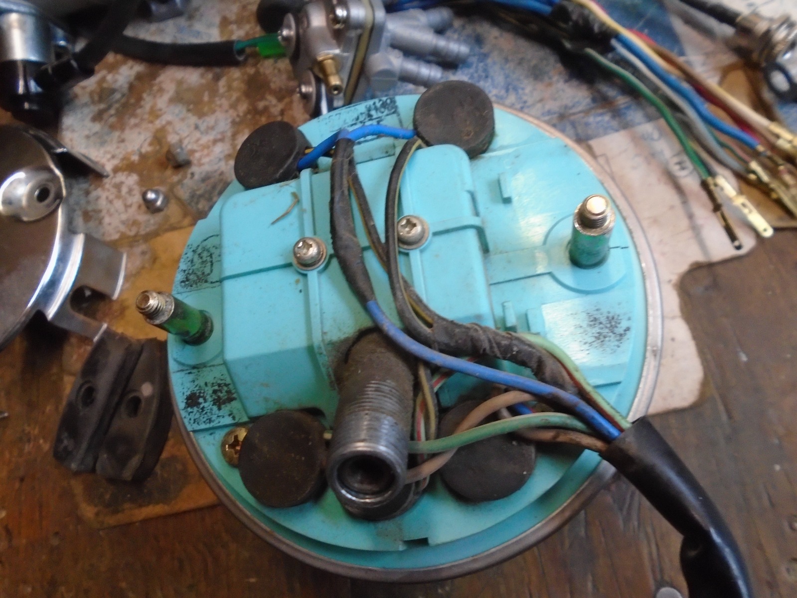

Bound i do a lot of gauge work and those numbers you're reading are often times merely suggestive and not a true indicator of either engine or road speed. Looked up thru ebay what a CSR1000 gaugeset looks like. You should have the "green" plastic back and fuel gauge built-in. Have fun taking those apart, experiment if you will! I do although see one for 30ish USD on ebay that's not too shabby looking but it still has the chrome cover on the back so you can't see of the Green plastic is cracked and they DO crack!

Thanks for the clarity Asphalt. I do understand that these mechanical speedos are never going to indicate a true speed or rpm and not just at the fault of age and wear. The ebay option might be a good option if I can't fix this. My main goal through this experiment is to better understand how these gauges work, which I already have a basic understanding of how magnets create electricity. I'll let you know how this goes tonight!

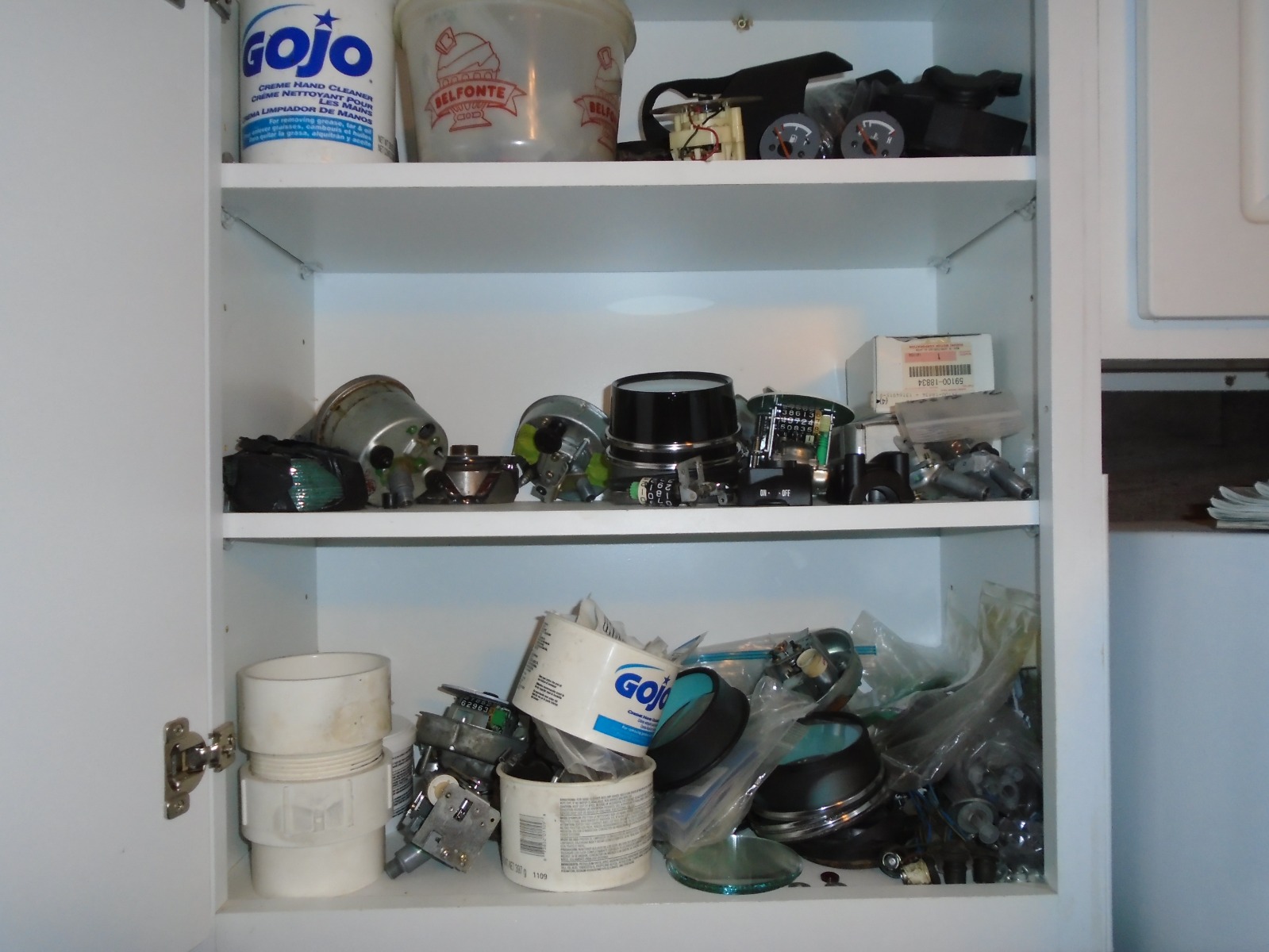

25 Nov 2025 07:34
