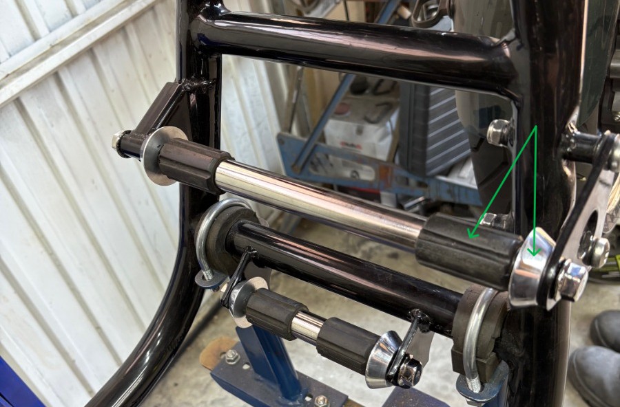

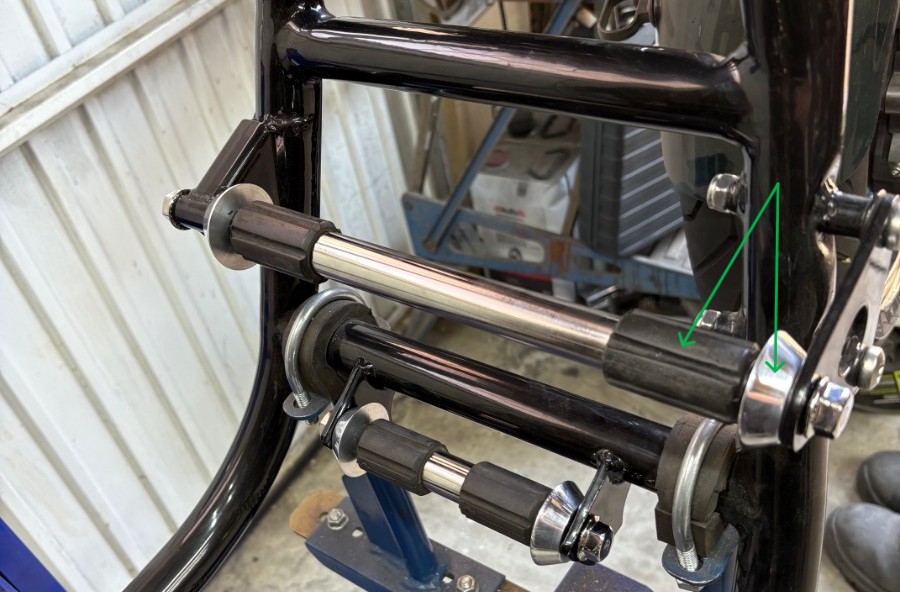

That's spooky, your painted frame has the same mounting set up as my rubber mounted "J" motor !!

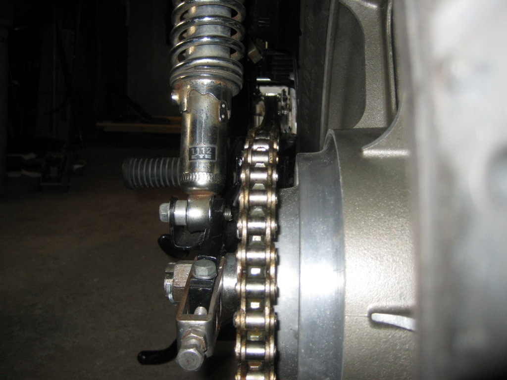

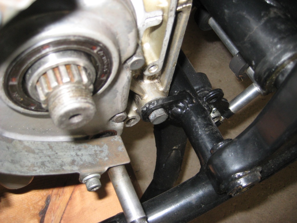

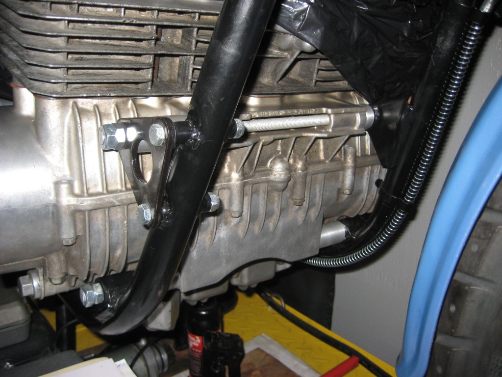

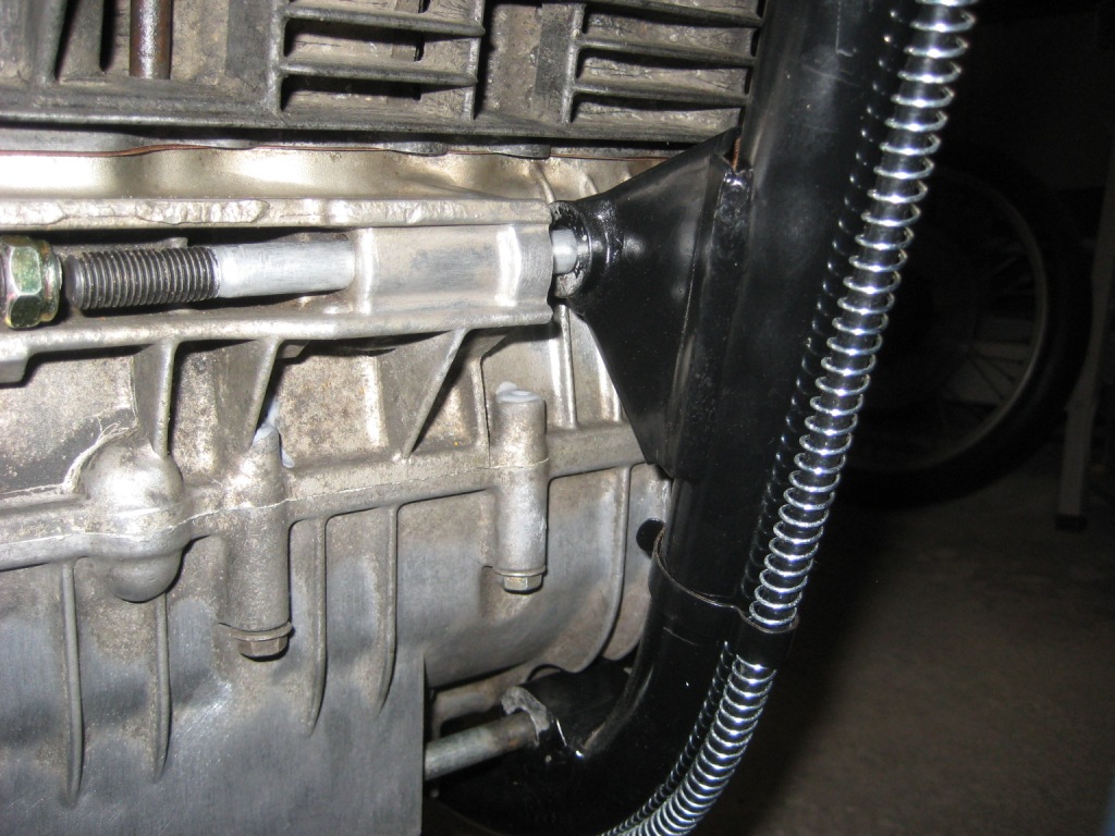

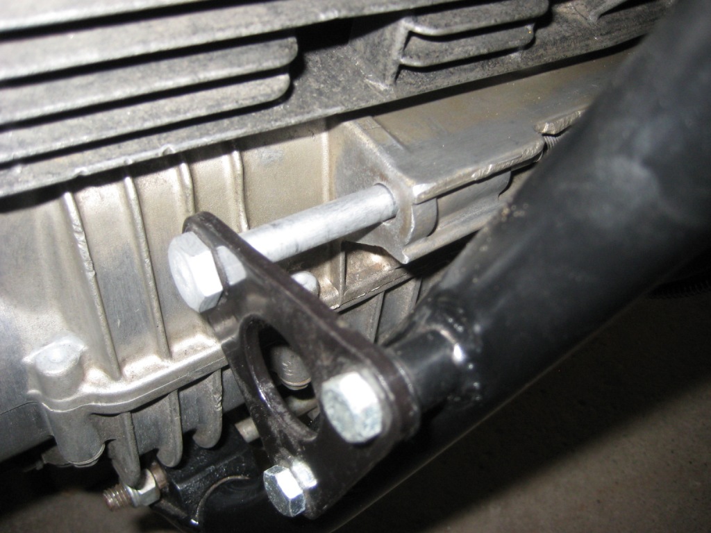

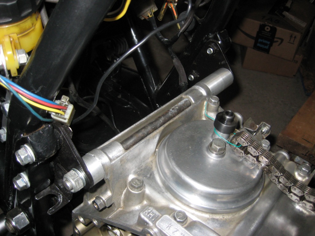

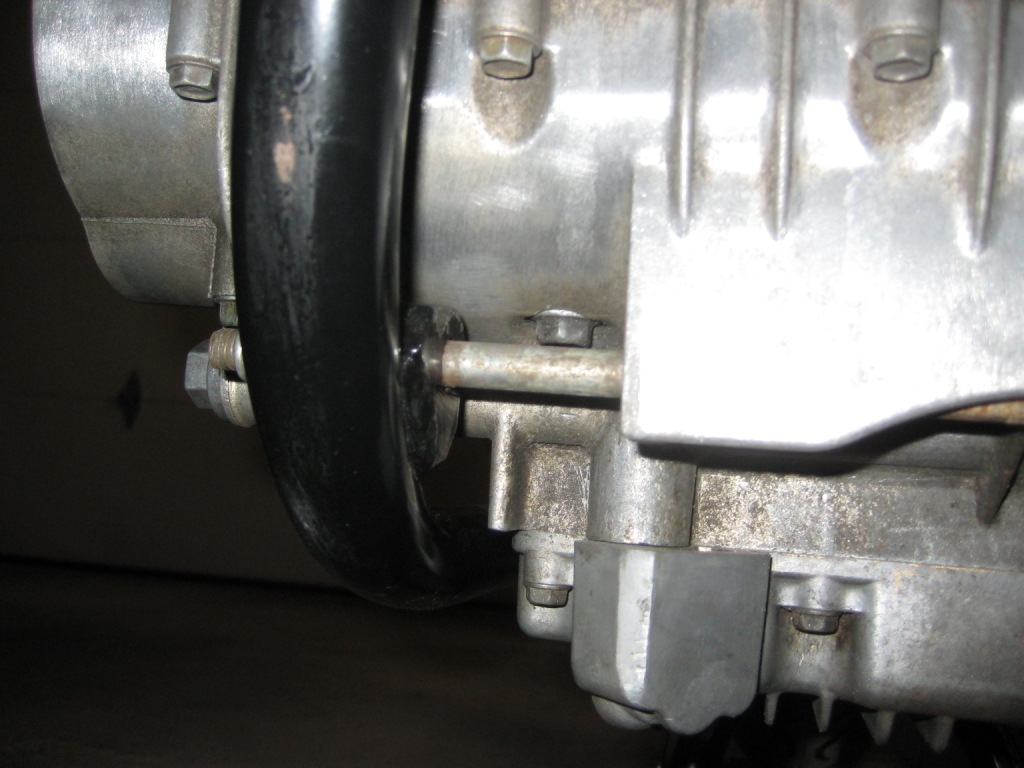

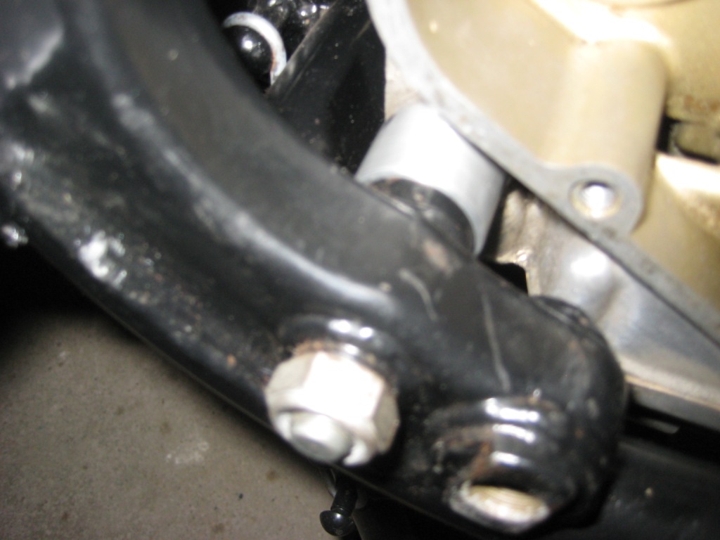

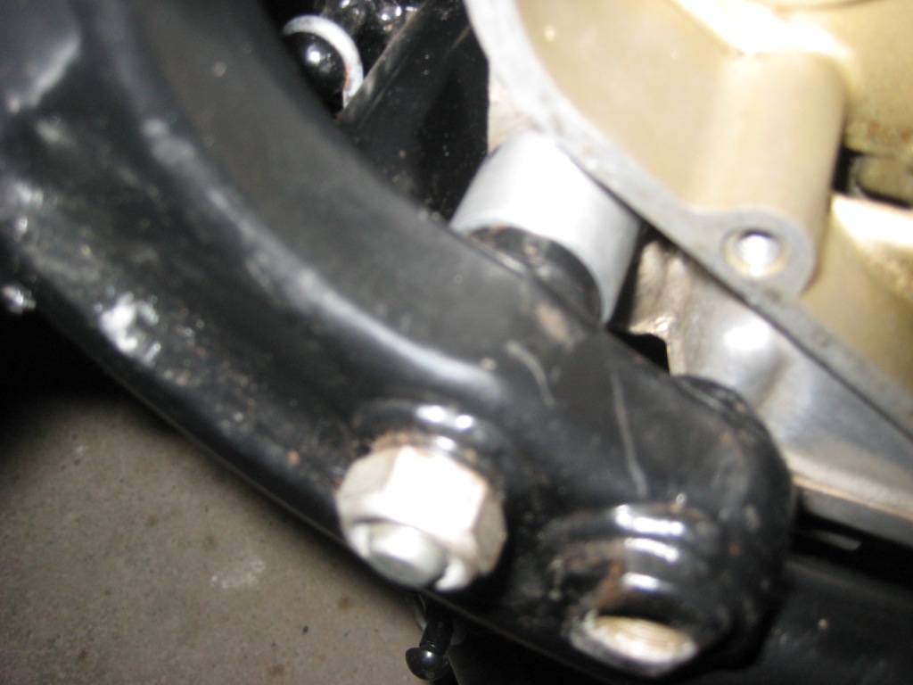

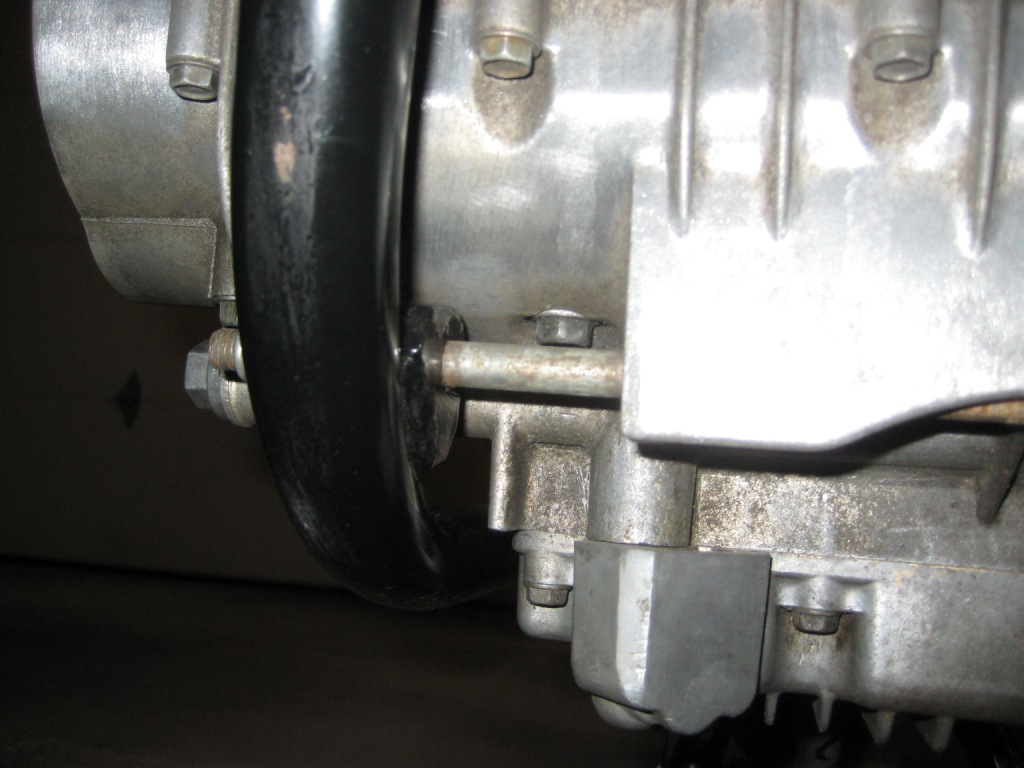

My conversion to swap a '82 Spectre engine was done to a 650 frame so it might be a tiny bit different. Any rubber mounting provisions need to be removed so its like a solid mount frame.
Here are some pics without the spacers:
Here are some pics with 1" OD 6061 spacers:
The only mount without a spacer was the welded frame mount tab under the front sprocket (lower rear) I started by making sure the engine was tight against this frame tab (clamp it) then I went around and measure how long to make the spacers.
There are 7 spacers required between the frame and engine. You can make motor mount bolts out of threaded rod or source new fine threaded bolts.

I went for a half/half option but you could make the two pieces (green arrows) as a single solid alloy part
