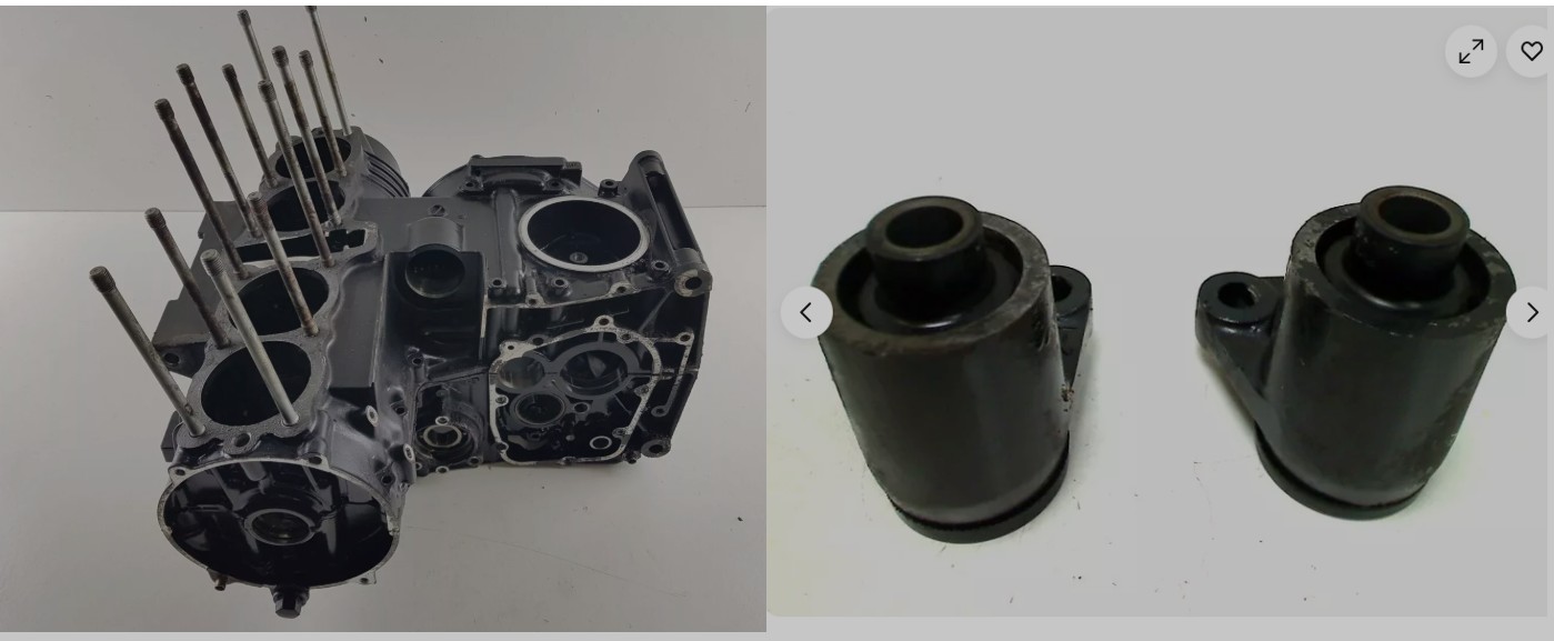

The ZR7 looks to have the rubber in the mount rather than the crankcase as in my "J" so it looks like it would be straight forward

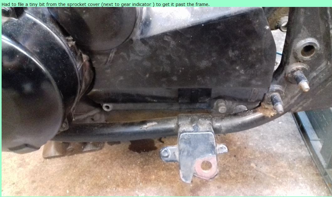

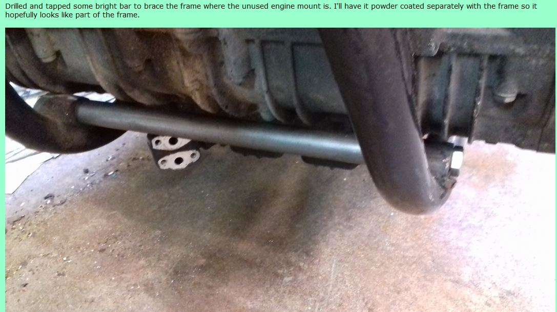

05 Nov 2025 09:41A guy on the UK Z650 site did a ZR-7 engine in a 650 frame, same engine spacers but had make a tubular brace between the lower frame rails. The other mod he had to make was to grind material off the lower portion of the sprocket cover to clear the frame.Thanks for the photos. They reminded me that some engines have rubber mounts on the front, and others at both front and rear. Maybe it's the shaft drive bikes with both? ZR-7 seems to be front rubber mount only, but the rear mount looks different compared to the earlier frames so not sure there.
