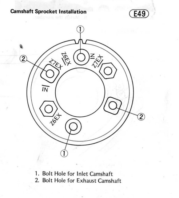

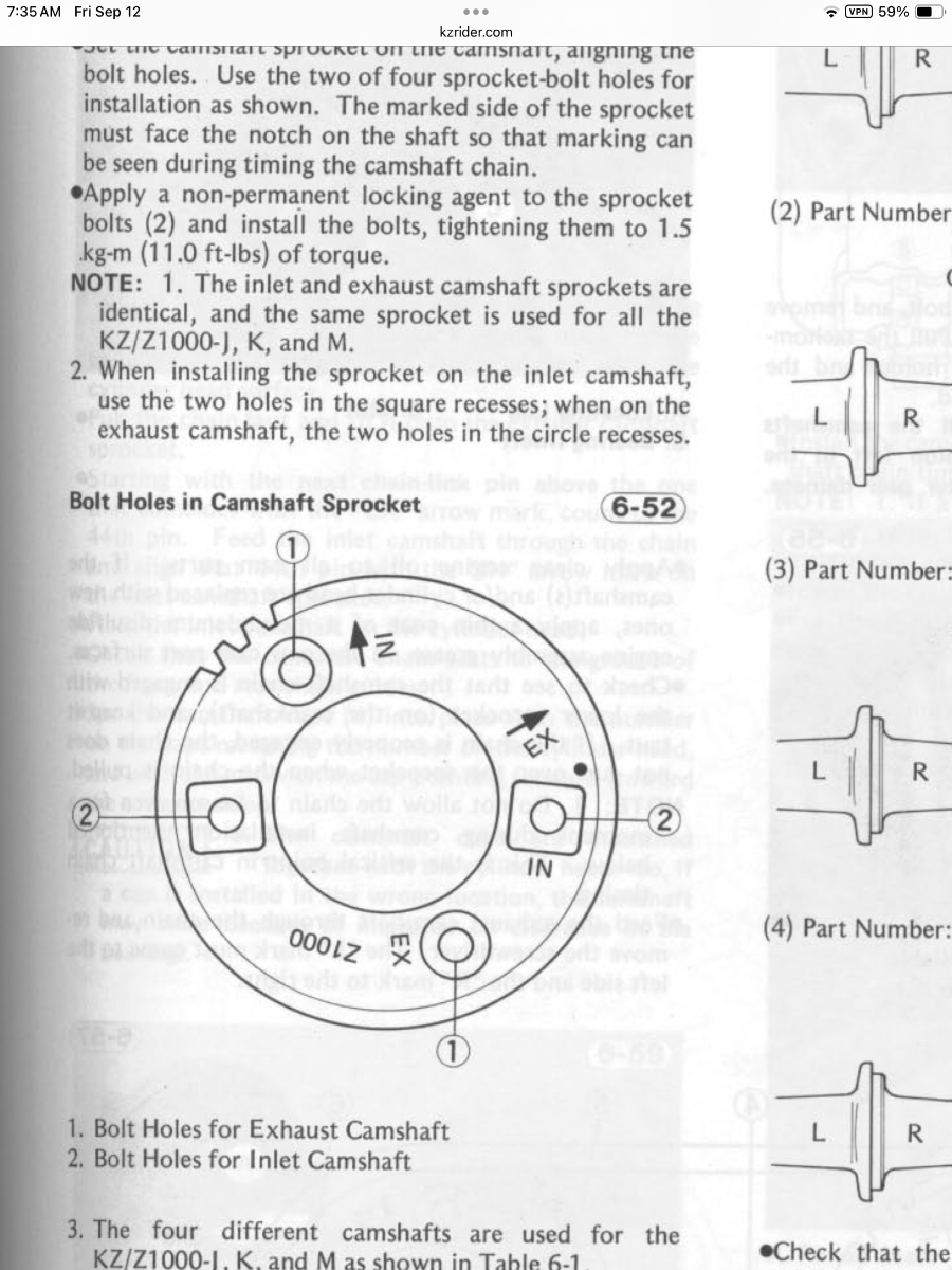

Looks like the cam sprockets are installed incorrectly. The intake cam sprocket should be installed with the bolts in the square holes and the exhaust sprocket with 5e bolts in the round holes.

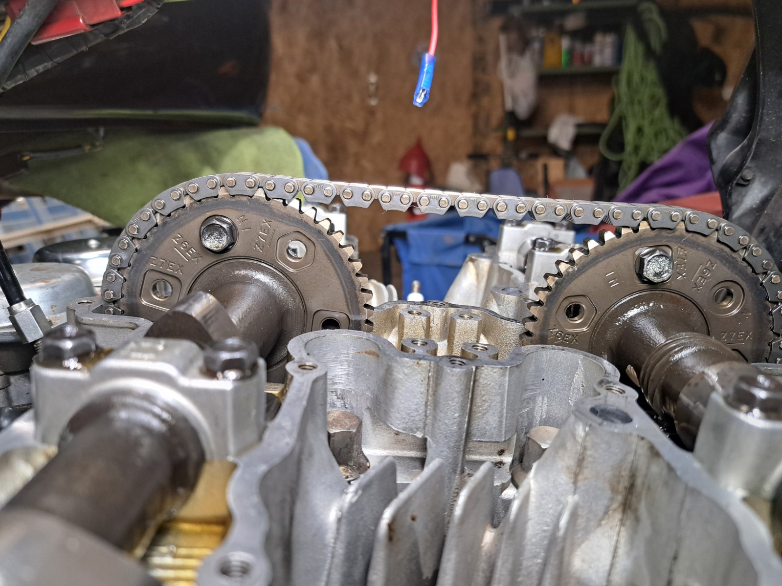

I believe what you are seeing in the picture is glare now that I look at the picture. Sorry bad Pic trying to get a good one og cam sprockets.    The pic here is  on t mark for 1 and 4 is this o.k ? Or do I need to fiddle and try to line them parallel? In on intake is between 45 and 46 pin

Ok update . I pulled valve cover off and double checked timing and made sure marks lined up which they did when I assembled first time and they were not lined up so I did the process again and reassembled and seems to sound much better but still lacking power . All pipes read same temp now which  is good. So must be carb issue?
