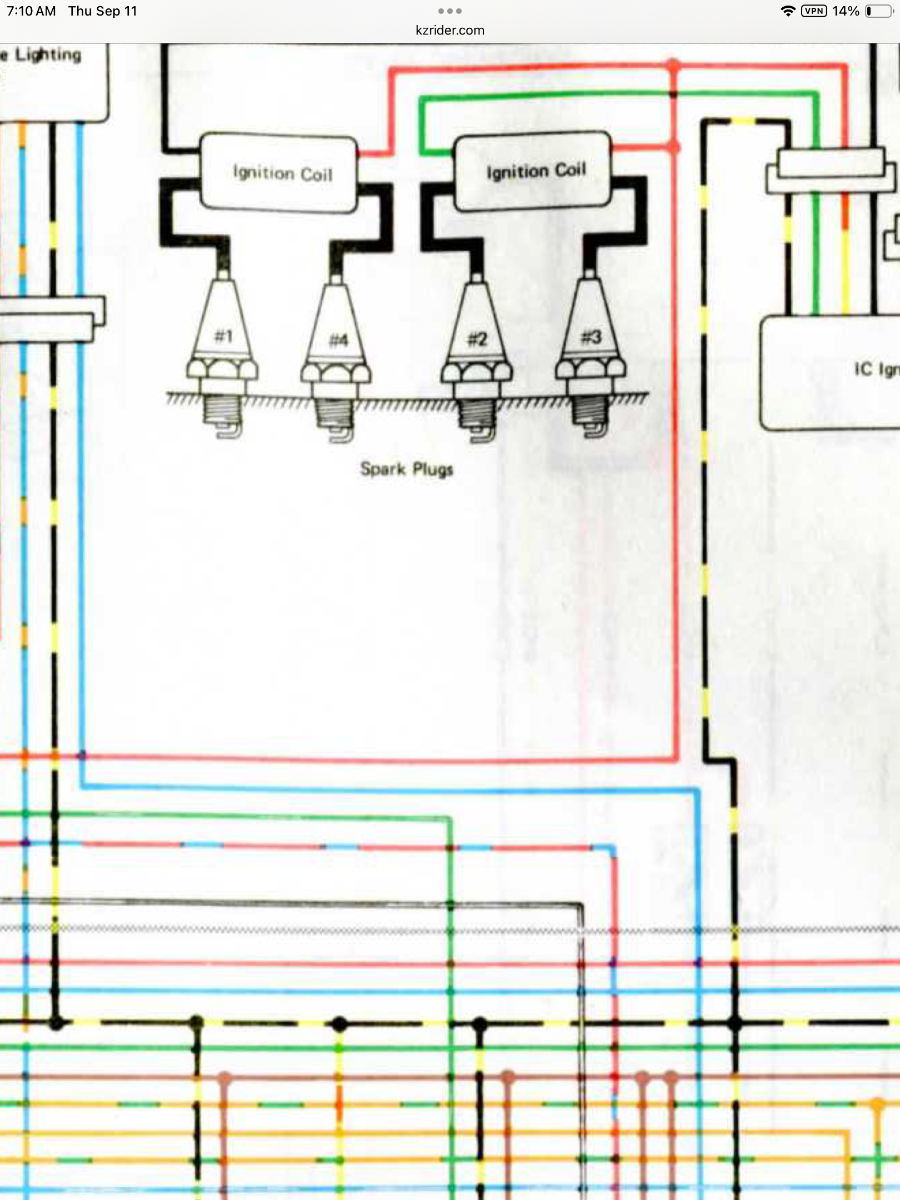

Are the coils connected to the correct plugs? One coil fires 1 & 4, while the other fires 2 & 3.

Yes . It dont matter top or bottom as long as clutch side is 2 and 3 and throttle is 1 and 4 correct? How bout the primary and secondary wires, I know g and r left and b and r right.

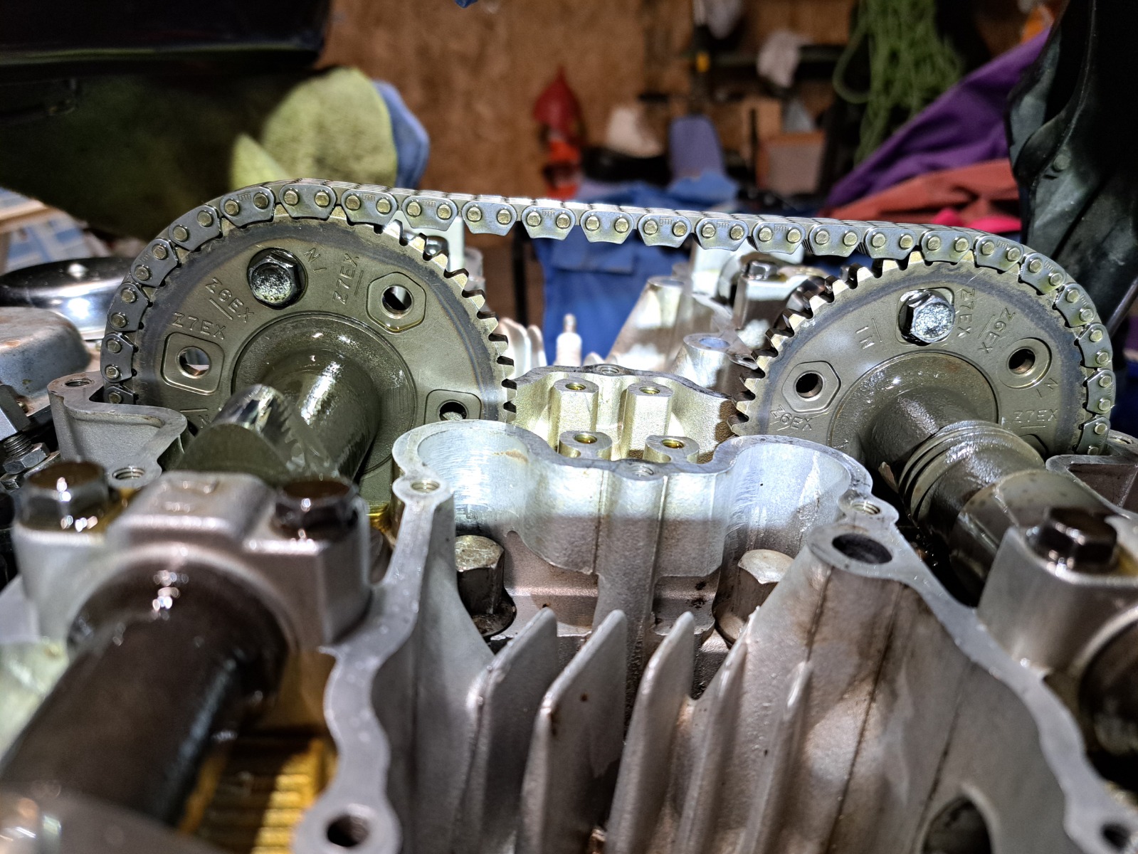

- kanexx
- Posts: 38
Re: Cylinder 3 hot, other 3 not.
11 Sep 2025 21:48
Beyond the coils I am putting the old ones back on, I replaced with new oe coils then the problem started. So I have valve cover off again, I had it set on t mark and not lined up exactly parallel with each mark as you can see in photo. I am good on my number of links for sure.
- Posts: 8163
- Thanks: 2663
12 Sep 2025 05:17 - 12 Sep 2025 05:19Either coil can do either set of cylinders. What matters is the wiring. Assuming (dangerous) that everythinh around the advancer at the end of the crank is set up according th the factory, the green and red wires go to the coil that is connected to 2 & 3. The black and red go to the 1 & 4 coil.Yes . It dont matter top or bottom as long as clutch side is 2 and 3 and throttle is 1 and 4 correct? How bout the primary and secondary wires, I know g and r left and b and r right.
Has any part of the timing mechanism been taken apart? If so, be certain everything is in the right spot,.

Why is the bolt on the exhaust cam in the square hole?
- Posts: 8163
- Thanks: 2663
12 Sep 2025 05:38
Looks like the cam sprockets are installed incorrectly. The intake cam sprocket should be installed with the bolts in the square holes and the exhaust sprocket with 5e bolts in the round holes.
- kanexx
- Posts: 38
12 Sep 2025 07:01
That i have not touched , I have just done valve clearance in which I have not touched those bolts. I will look in my manual, I see you are looking at kz1000, would it be the same as kz750
