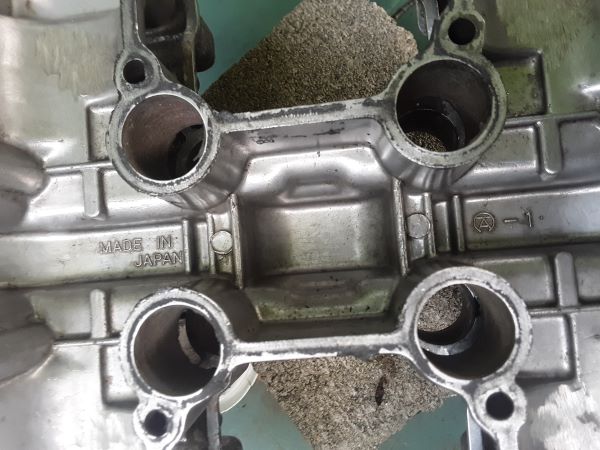

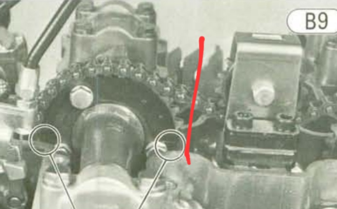

The witness marks on your cam cover webbings are positioned about where the red lines are on the picsbelow. The cam chain should be well clear of the cam cover at that point.

Yes i replaced the old top idler be sure that the sprocket was good by this one on my rebuild.
on torque for the cams i m at 87 so under specs.
the top cover look to be from a 900
i will try to double the head gasket tomorrow and listen

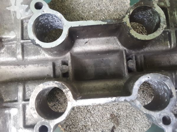

Yes, that's a 900 cover which is why it doesn't fit properly and is the cause of your issue.
If your going to use it then remove some of the webbing to clear the chain.
This is a 1000a1 cover. I believe yours should be the same.

Just happen to have 900 and 1000 valve covers to compare...
the two covers don't appear to be different where your scrape marks are. The difference between them seems to be only in the sides of the "tower" where there are reliefs in the 1000 cover for the axle bolt thru the idler. (the other difference is external - on the ends of the 1000 cover there is a half moon shaped feature which is not on the 900 cover. Not relative here.)
But as Warren showed, the chain shouldn't be near the cover in the area where the scrapes are. Maybe something else is going on.

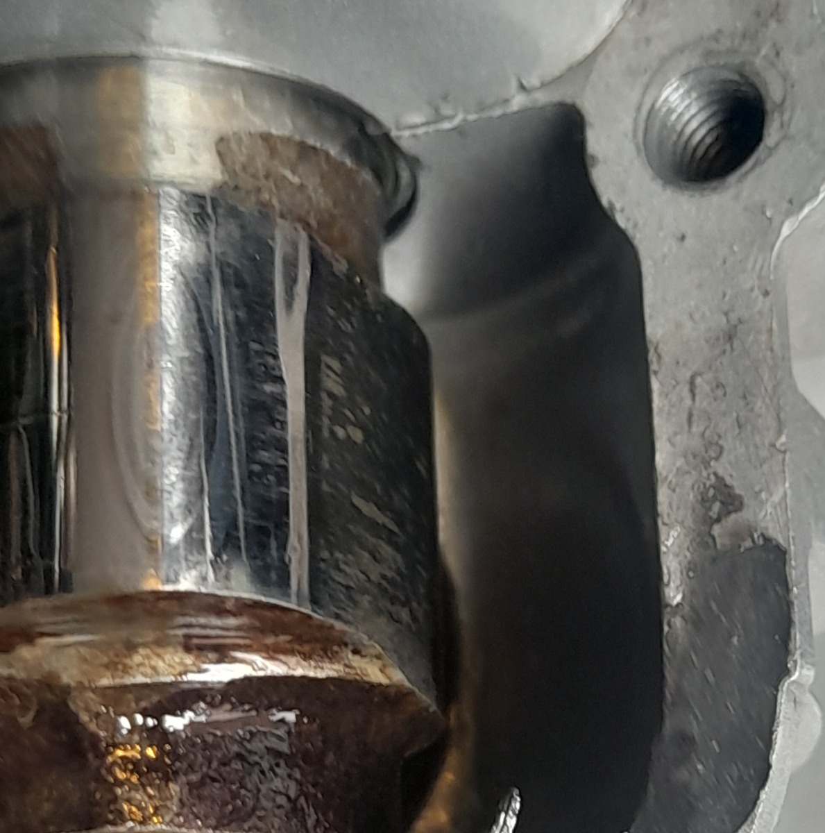

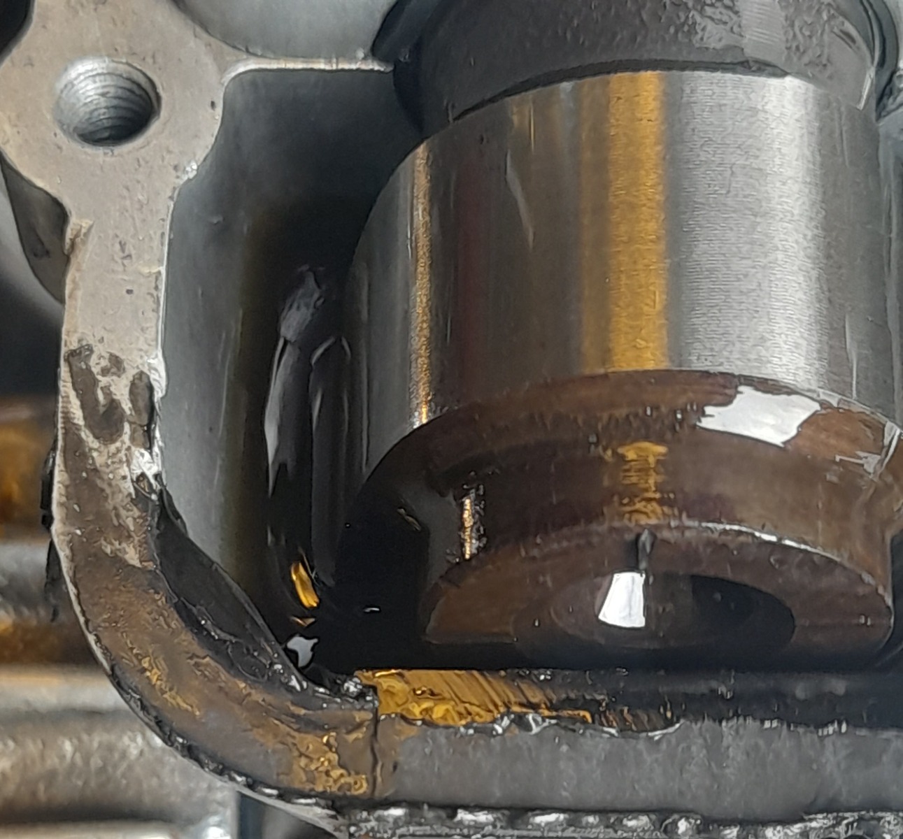

On your new video it sounds like it could just be excessive valve gaps and cam lobe slap. When you shimmed the gaps what measurement did you set them to.?
Confirm you have oil pools around each bucket.
See pictures below. The second pic shows lubrication of the bucket by an oil pool.
The first shows a dry bucket.
If yours are dry then the cross drill oil gallery could be blocked.
