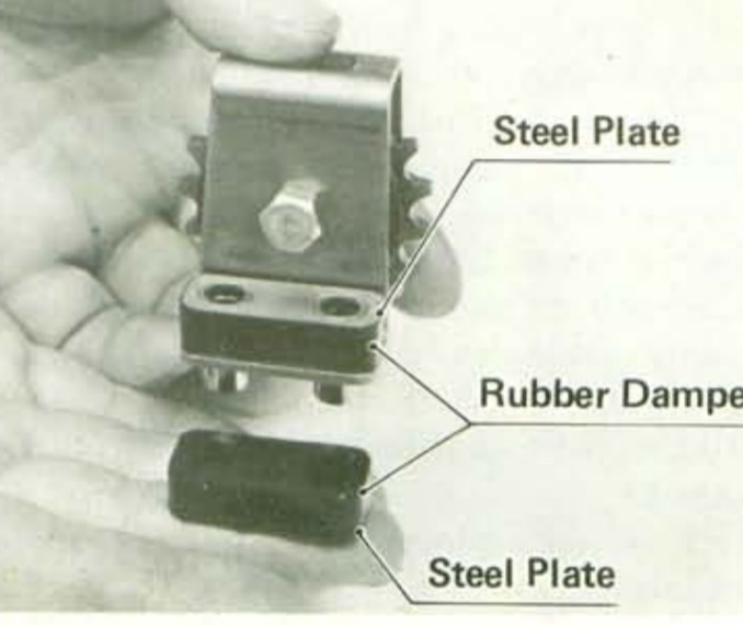

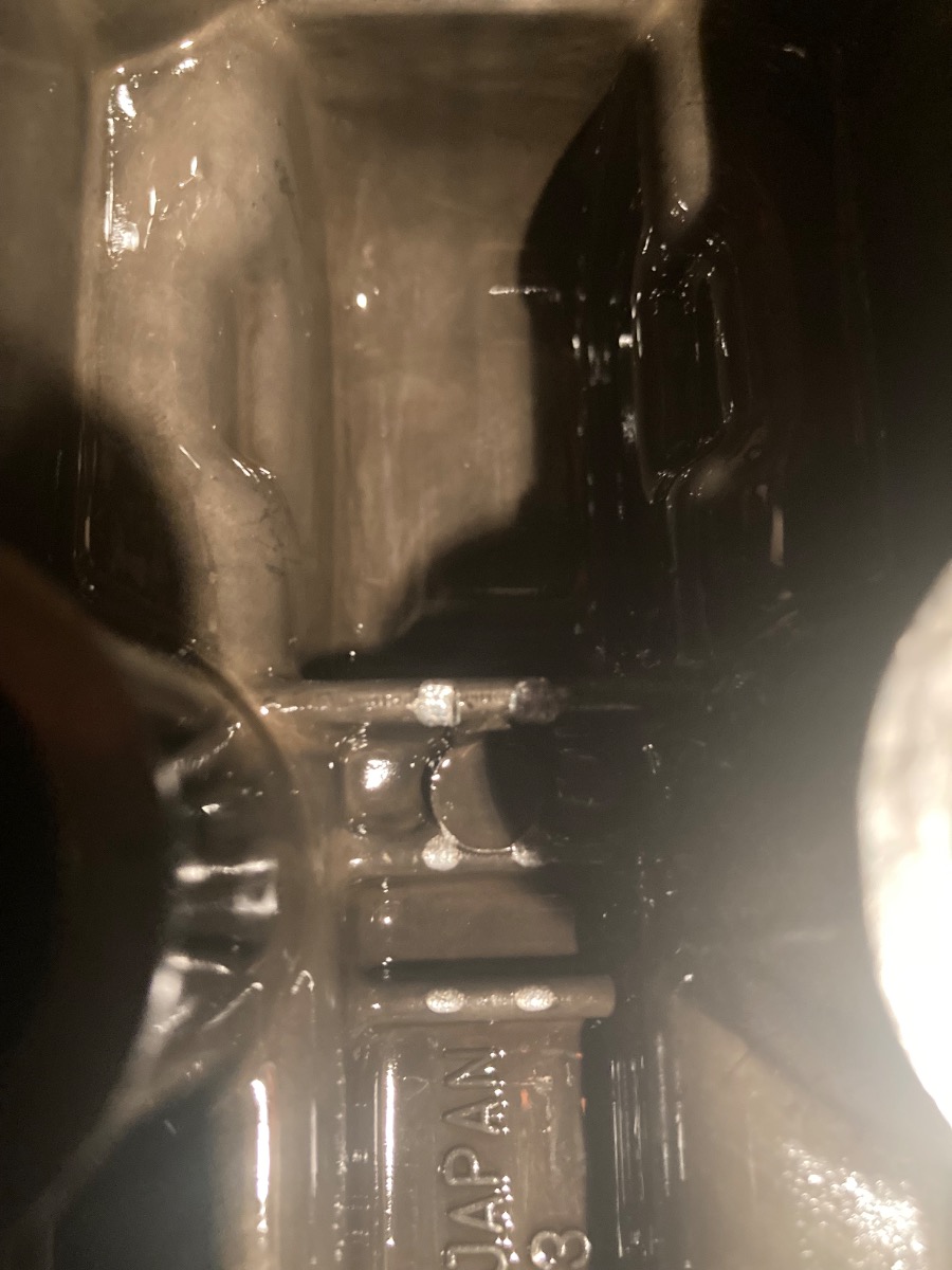

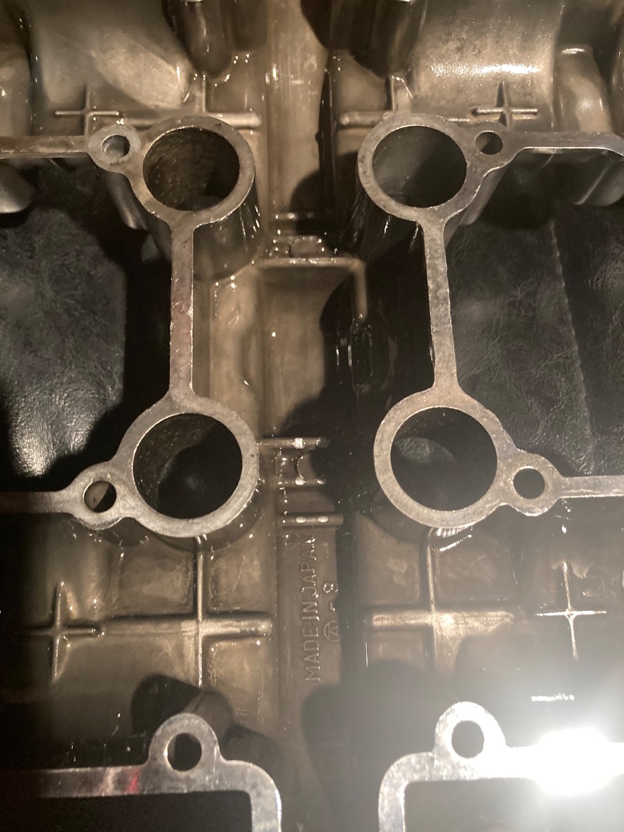

Oh oh … i was looking the cams and i just see that in fact my cam chain is grinding my cover ( thank @ street fighter ltd)
…worn rubbers ?
…worn rubbers ?

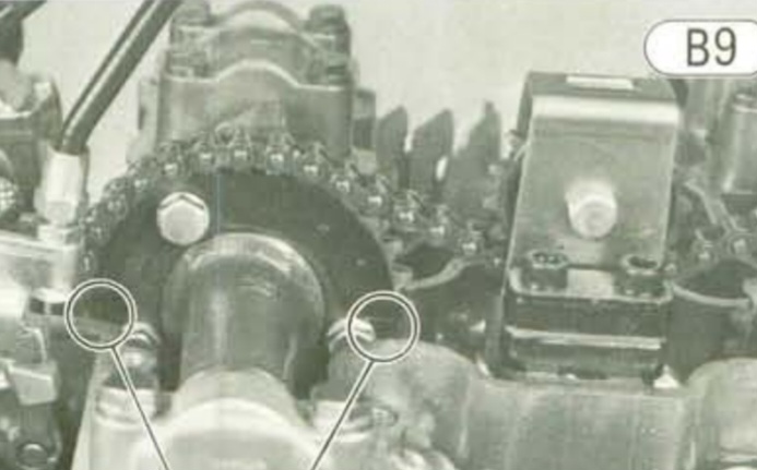

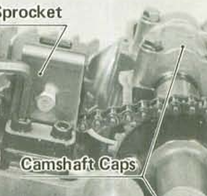

Re: Click on top engine
05 Aug 2025 19:25 - 05 Aug 2025 20:19
Post a picture of your head without the cam cover on.
your idler sprocket should be holding the chain down in the centre so the cam chain shouldn't be that close to the cam cover.
So if your idler is as per the pic below the cam chain should well clear of the cover.
Assuming you have a cam cover gasket fitted you could double it up or file a bit of clearance in the webbing.
