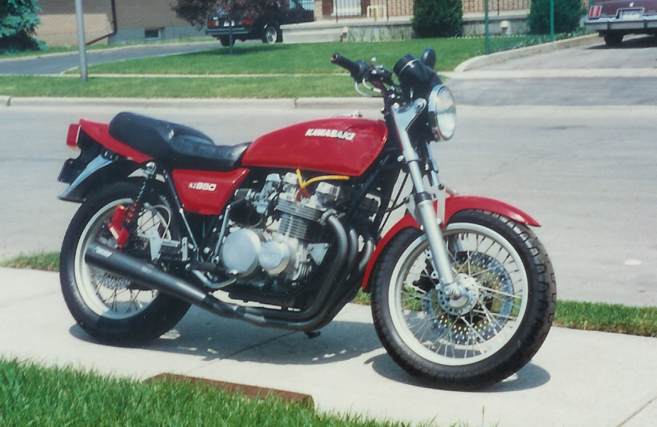

I measured the primary tubes on the pipe I have on the outside bends at 21" (to the collector) which is a lot shorter than a typical Kerker or V&H street pipe.
A pic of my 650 from 1986 with a V&H pipe, notice the long primarys and long collector. That pipe is basically a copy of the earlier RC pipe.

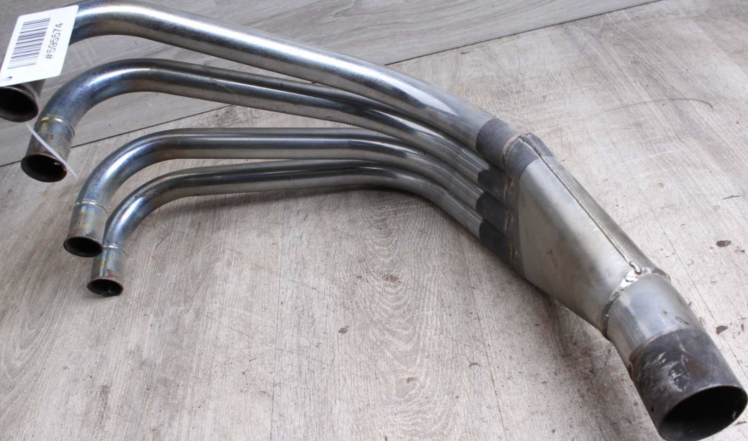

11 Aug 2025 12:04Thanks for the leg work and advice on this exhaust system. You have convinced me that this system is indeed a race system, which frankly, is not what I need for my bike. Guess I got lured in by the stainless Supertrapp unicorn business. Ha ha.I measured the primary tubes on the pipe I have on the outside bends at 21" (to the collector) which is a lot shorter than a typical Kerker or V&H street pipe.

I'm still going to stay the course of cleaning and refurbishing this pipe. I'll trial fit, but if the center stand is blocked, that will most likely mean it doesn't stay on the bike.

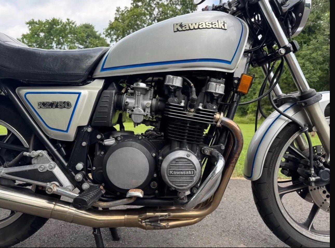

Came across this header on ebay a while back. It's apparently from Germany. Based on the collector, it seems closer to what I want for my bike; it should tuck up close under the sump. Anyway, it's all good. The search continues...

I believe that pipe you bought will be just fine even on a stock engine.
When I mentioned "race system", I meant it would probably be most "efficient" at higher RPM's and probably not make as much torque as a longer tube street orientated pipe. Would you be able to notice the difference? probably not enough to tell on the seat. Were only talking about a very small difference in HP and torque between the two types of pipes.
Its the combination of bigger CC engine, more CFM cylinder head, higher lift cams, and bigger carbs where pipes like that actually push you back in the seat.
If you are running a stock air box the jetting will most likely not have to be altered.
That pipe probably rocks at +7000 RPM +100 MPH
