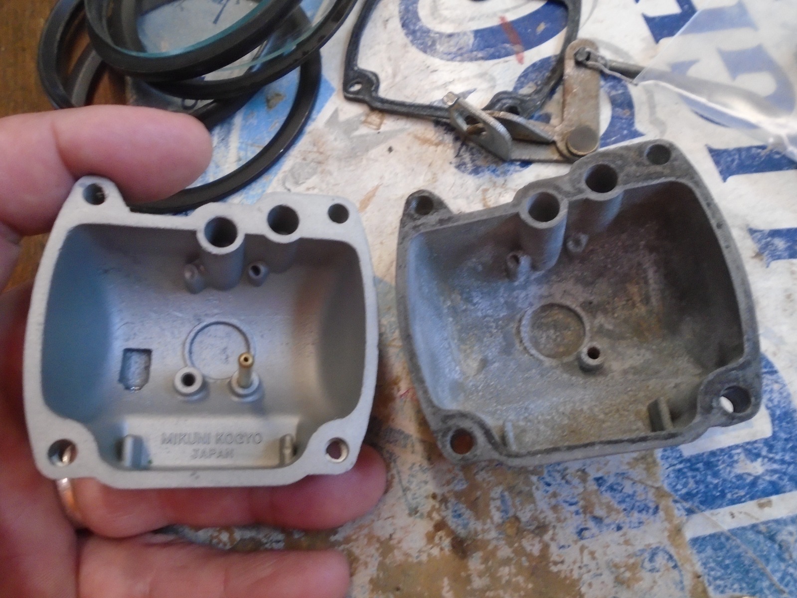

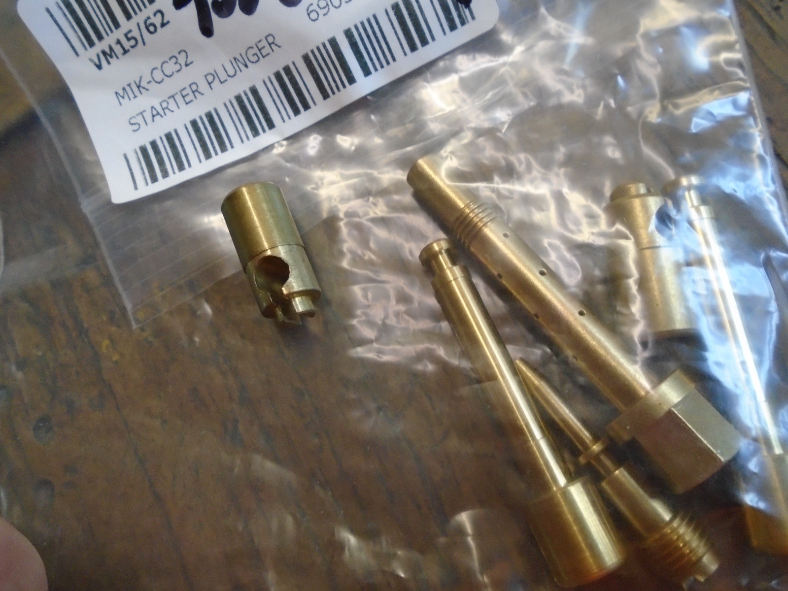

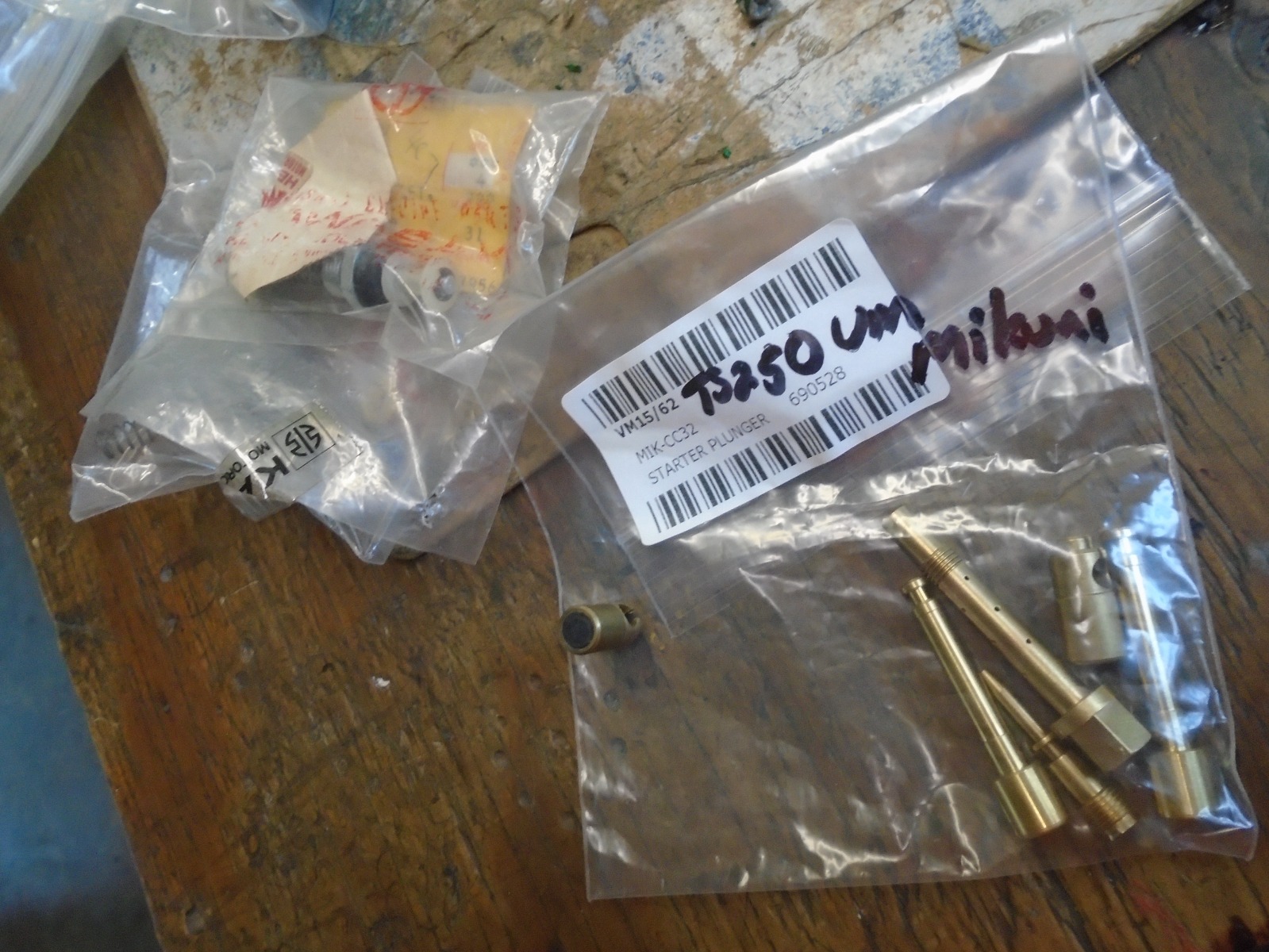

Compression is one thing but have You, as suggested, preformed a lower-end leakdown test yet? These are not 4-strokes so 2 tests are required. Also i ALWAYS replace the choke plungers on these. Note your style shown. Also look down the casting where the plunger goes, is the "proud" seat pitted or messed-up? I do a lot of the Suzuki TS T250-305 and super-six-hustlers etc. Check this stuff!! It's the road to success! Gotta Open that door and quit running into it. Also, though Highly regarded by many folks. Don't replace this plunger with a Keyster Brand!! I've seen several that the pad just falls out of them.They are NOT crimped like the original, just glued. And final, make sure you adjust the choke cable correctly so plunger seats fully with a bit of freeplay. Have Fun!

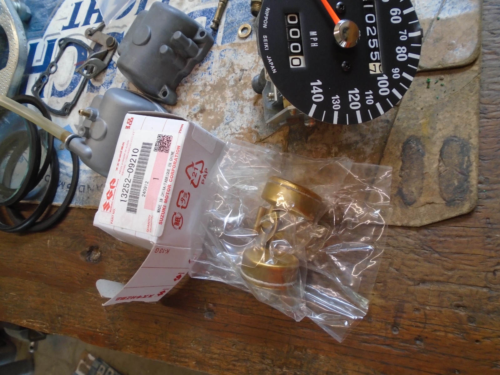

Another consideration, Float/Float Needle Seat. They made a gazillion different type floats for these little Mikuni supplied bikes. Make sure Your
floats and doesn't sink. You can rattle it close to your ear and hear the sloshing if "often" pin holed/rotted thru the brass. And..Float needle seat and needle. While might seem fine at first glance, is it actually doing it's job? Does the compression pin on needle have strong/decent "springy" action? These are buzzy little machines and the sealing can suffer from such activity.
