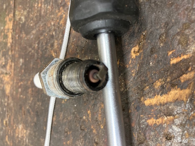

I went for a honey-do list ride today. First stop. Home Depot. in store for 20 minuites. Got back on the bike and it would not start. Put in fresh spark plug and it started first kick. Next stop the grocery store. Same thing, bike would not start when done shopping. Replaced spark plug, and it started first kick. This is nothing new, I carry 8 spark plugs with me. I had the carb off and cleaned twice Jet sizes, float height, air screw setting all comply to service manual. see pic of plug. Looks rich to me, bur not sure how a 2 stroke plug should look.

The colour doesn't look too bad, is it "over oiling" ? (2 stroke pump setting)

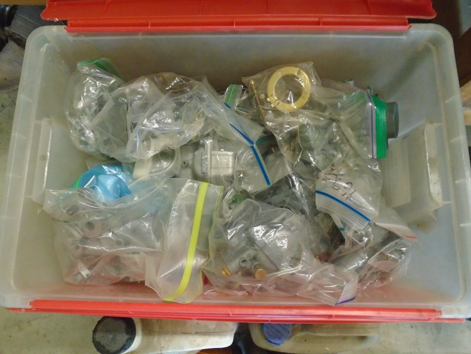

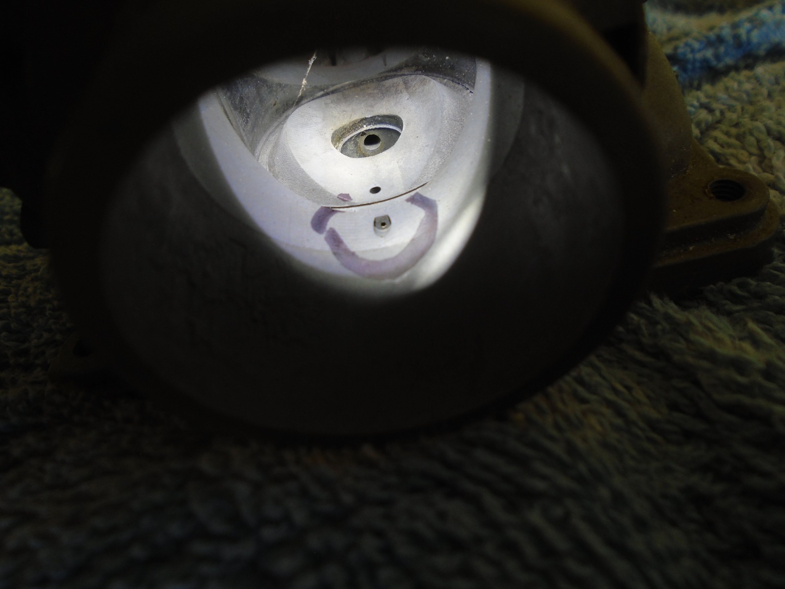

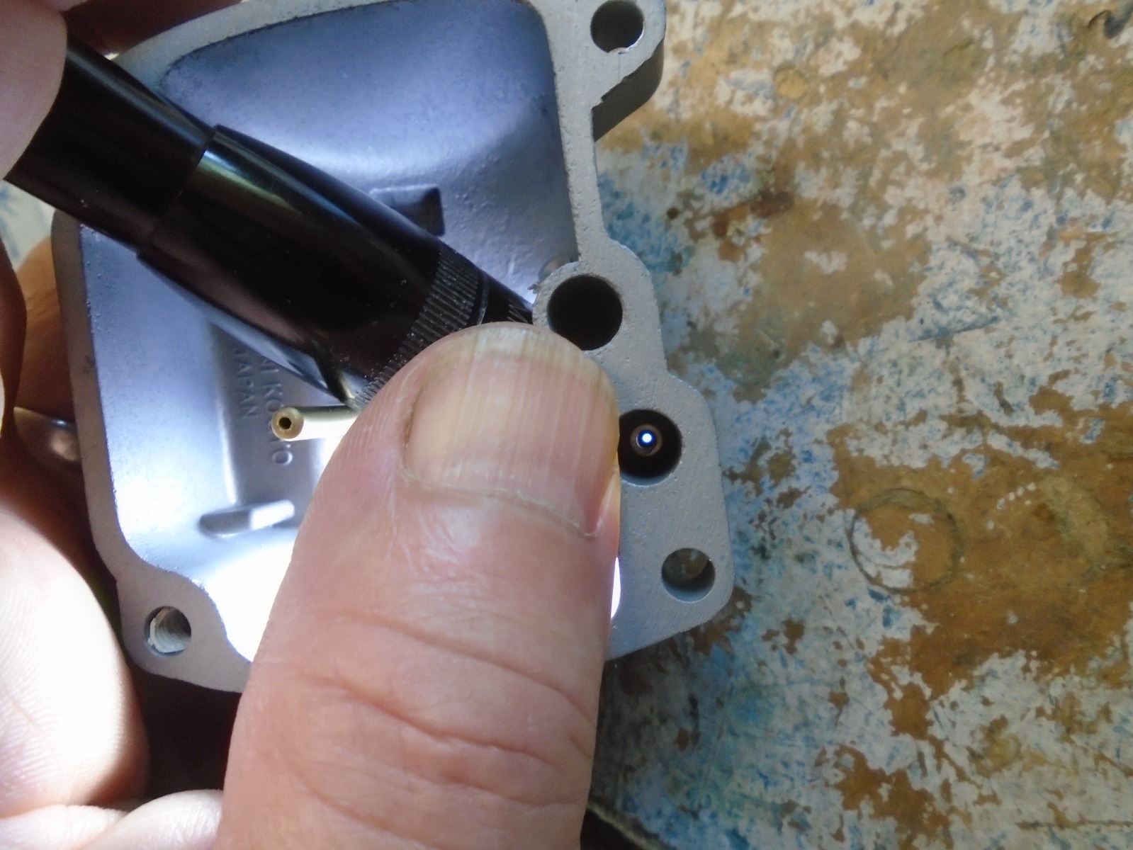

Before You find Yourself stranded and Nerdy has to loft your little bike to a safe depot, check some stuff ya might of missed. That tiny bypass hole circled in marker, has to be clear, essential!! Should be able to shine a light thru the pilot jet hole and clearly see a ROUND hole. Gotta emphasize Magnifying glass!! Without it all you will see is a glimmer of light, Really focus the glass on it!! I have containers of this stuff, isn't above Your pay-grade, just look better. You cats have fun up there!!!

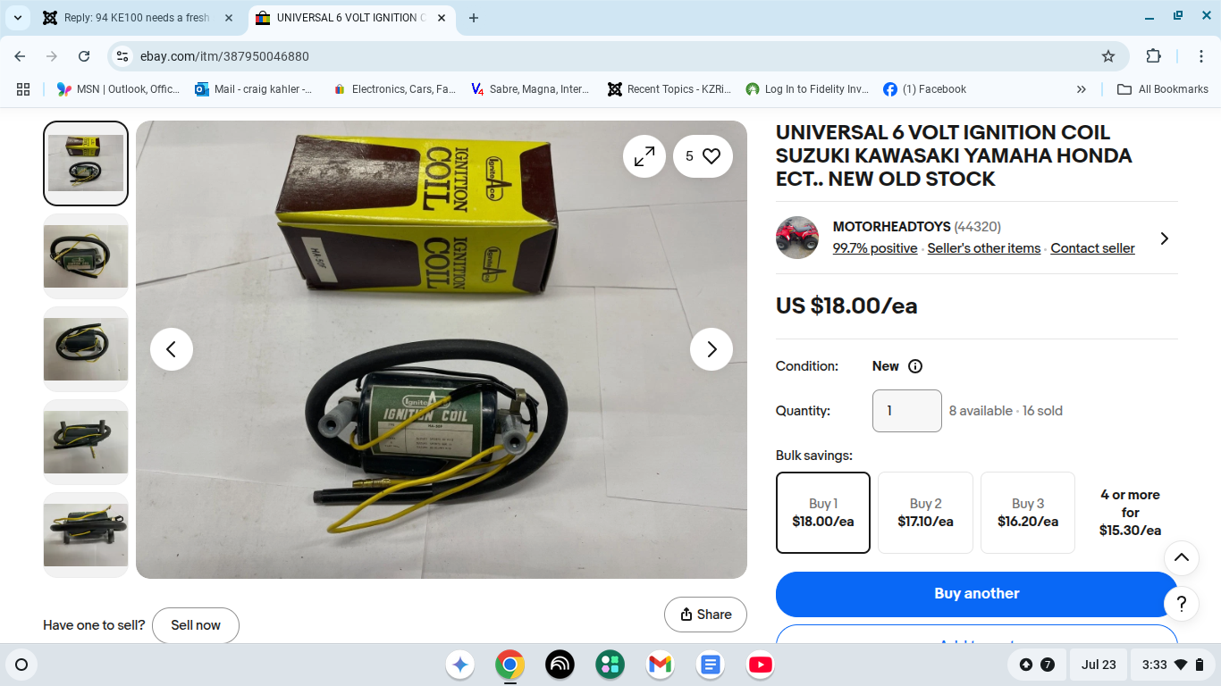

23 Jul 2025 13:07 - 23 Jul 2025 13:08I replaced the ignition coil with the one in the attached pic.(the origional one would fail when it got wet). checked wiring from points to ignition coil , resistance of coils behind rotor, cleaned and set points for correct ignition timing. There is no spark when the bike will not start, but I can still shock myself real good. All it takes to get the plug working again, is spraying carb cleaner in it and drying it out. I'd go broke always putting in new plugs, so I have been cleaning and rotating the same plugs.So... dumb question: is it possible that there is a poor connection in the coil / wire / plug cap that fails after sitting with a hot engine, giving you no spark, and then the act of removing / replacing the cap pushes the poor connection back together?
Also when it doesn't start, do you check for spark before replacing the plug? I didn't see that in your description.
