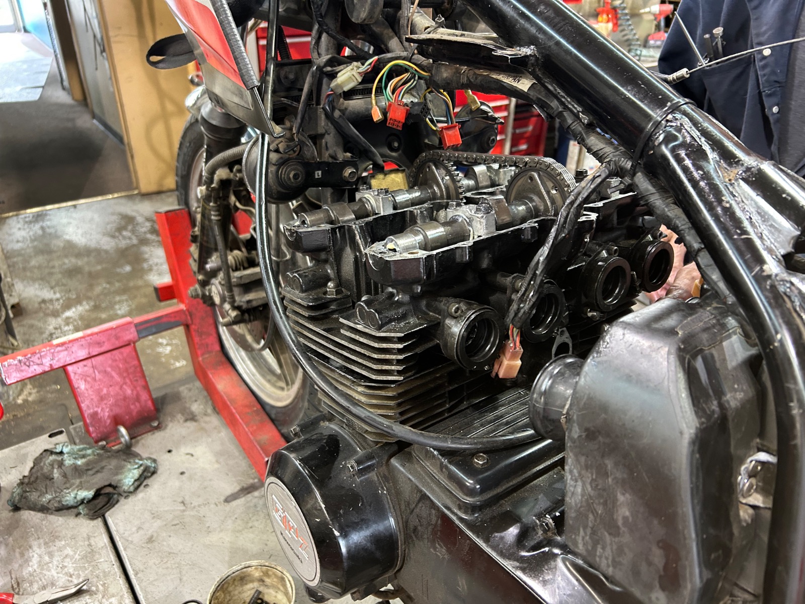

09 Jul 2025 08:55 - 09 Jul 2025 08:581985 GPZ 550. Long story short, sent the bike in to get the carbs rebuilt as they were pouring fuel out the overflow as well as into the cylinders. Carbs rebuilt, and the bike ran great, however, cylinder #4 is completely dead. ZERO compression so it was only running on 3 cylinders. Cams came out to find the retainer or something was wedging an exhaust valve open. Then that part made it's way into the engine, so the head had to come off. They found whoever had the engine apart previously completely butchered cylinder #3 trying to hone it and it looked horrible. We discussed getting honed and re-ringed but the costs for the current repair are already exceeding the value of the bike. Because it ran well before, I said to put it together and we'll look at honing and ringing the engine over winter in a year or two.
I went to visit the mechanic and every step of the bike is fighting him. This is someone who has been fixing the Jap bikes since the 90's, so he's older and typically grumpy (
), anyway, when setting the valves, the engine spins great until he installs the exhaust cam and then the engine is really tight and doesn't want to spin, and that is with 2 caps on. He is not sure why it would be tight, but has anyone every ran into this and figured out the solution, or know what the cause was? I appreciate all your input. Thanks!

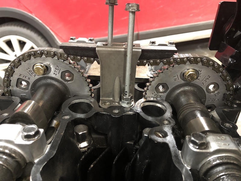

If you want to rotate the later series engines with Hyvo chain to check shim clearances/cam timing you need something like these :
Its maybe only pressing down about 4-6mm but it makes all the difference in the world (first one is mine)

10 Jul 2025 00:26The items in injecteds pictures ae "workshop tools" that have been created to simulate the cover being fitted, you aren't "missing" anything. The guide I was referring to is a rubber block in the cover itself. If it was running when you took it into the shop it would suggest the "tightness" has been created by something they have/haven't done. Be careful you don't end up paying for "their mistakes"I never did see a cam or chain cover/guide. They tightened the cam caps, installed the chain tensioner, then spun the cam to get to the base circle to check clearance. Someone was in the engine before I bought it so would it be possible that the guide could be missing? I don’t recall seeing something like that on the table.
