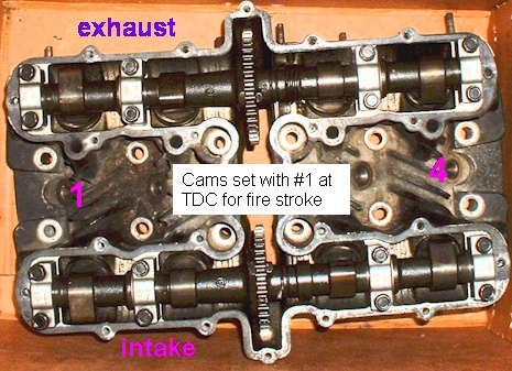

I mean, anything is possible.  I did install them in this orientation at TDC for 1&4, with the #1 lobes pointing out (the pic is from Loudvx's kz550 Amazon page).
One thing I can be confident in is that the engine has compression. I'm seeing spark but maybe the spark timing is out, either because I have the cams installed 180 degrees out, or because there is a fault in the ignition system.  I do have an spare ignition system I might try swapping that in. I'm 99% confident the carbs are clean (never say 100%) and it's getting fuel, but it's always possible they aren't.  I'm wondering if I can try spraying some starter fluid into the airbox to check that aspect.  Or do I remove the airbox and spray directly into the carb throats?
Frustrating but there must be a solution...
Edit: asked about swapping the 1&4 coil and 2&3 coils to address 180 degrees out cams but realized that wouldn't work

Is it really possible for cams to be 180 out on these bikes given that it’s a wasted spark system? Like 1&4 and 2&3 get spark at the same time, so you’re going to get spark to the cylinder at the compression stroke even if it’s 180 off…

to be honest I would think if cam timing was more than even a "few teeth" out damage would occur !!
