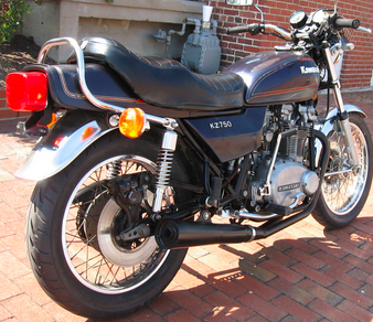

Is it worth taking on this bike? This is it, a photo from when he first bought it a long time ago, from a private seller. :
