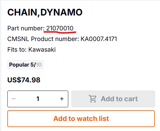

This is the chain you are looking for (listed for 77 B2 on CMNSL) although I would question why it was re moved

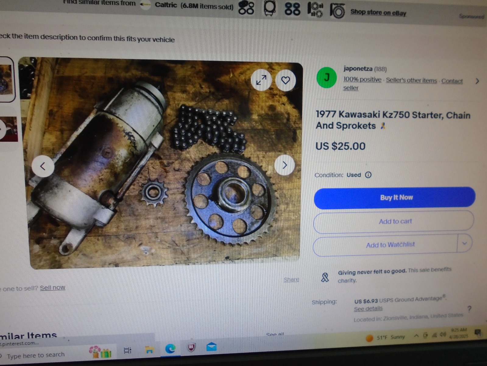

Those 750Twins are renowned for starter clutch issues. Often the sprag clutch behind the rotor. As Wookie mentioned, could of been binding-up in the past and dragging the "reduction" starter along for the ride. NOT GOOD.
Honda CB450/500 twin used similar and they used a peanut 219 or 8mm chain. But one in photo of used ebay items looks beefier then a 219? Anyway a nice collection for 25bucks plus shipping?? If it helps.

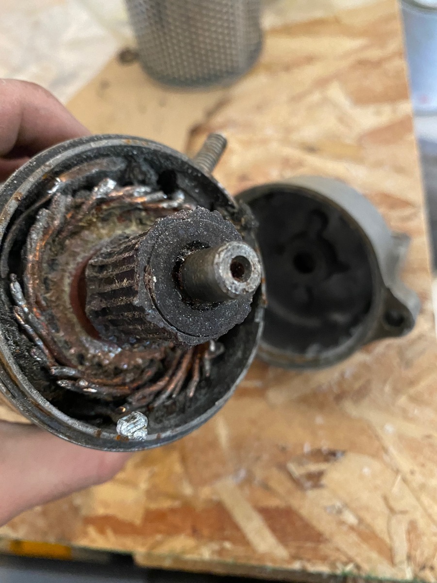

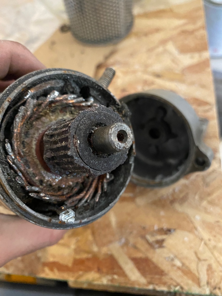

The below link relates to a similar situation and the pic is what happens to a starter if it becomes driven by the motor (this one is from a 750 twin !!!)
1982 KZ750 Twin Starter Motor Not Turning Engine - KZRider Forum - KZRider, KZ, Z1 & Z Motorcycle Enthusiast's Forum

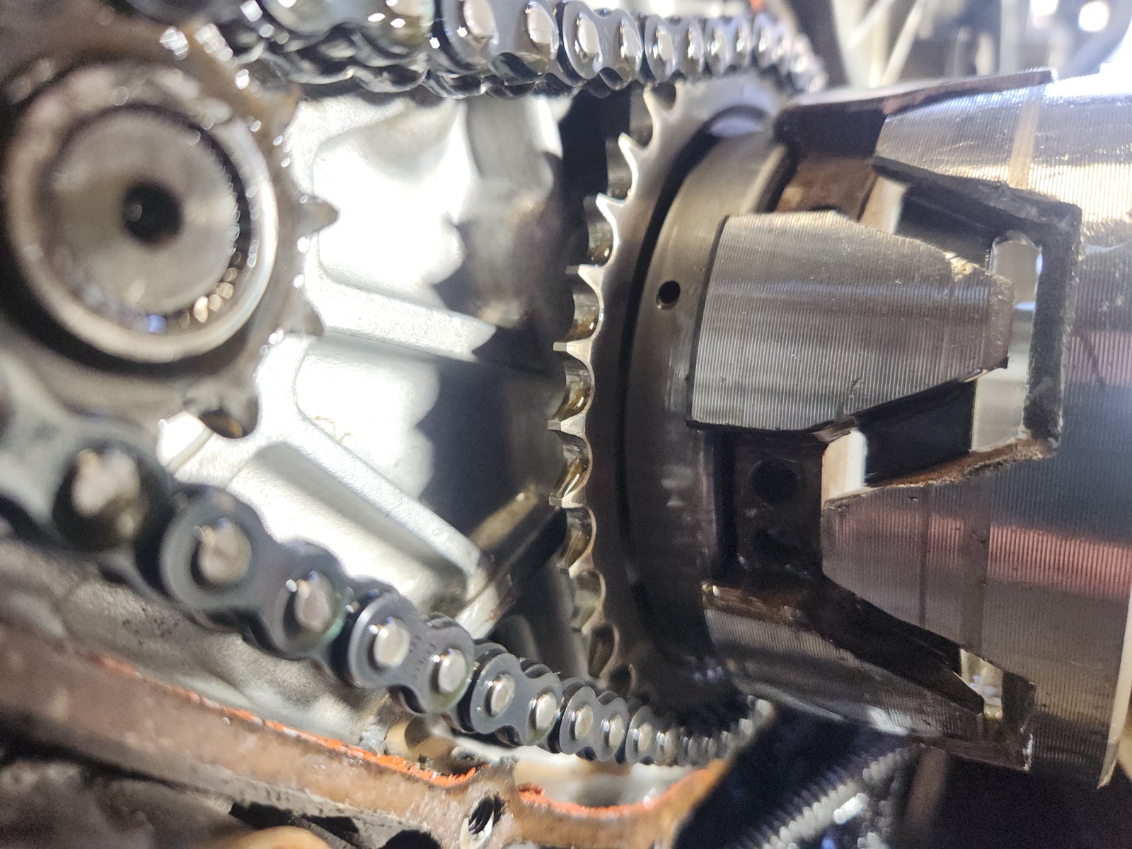

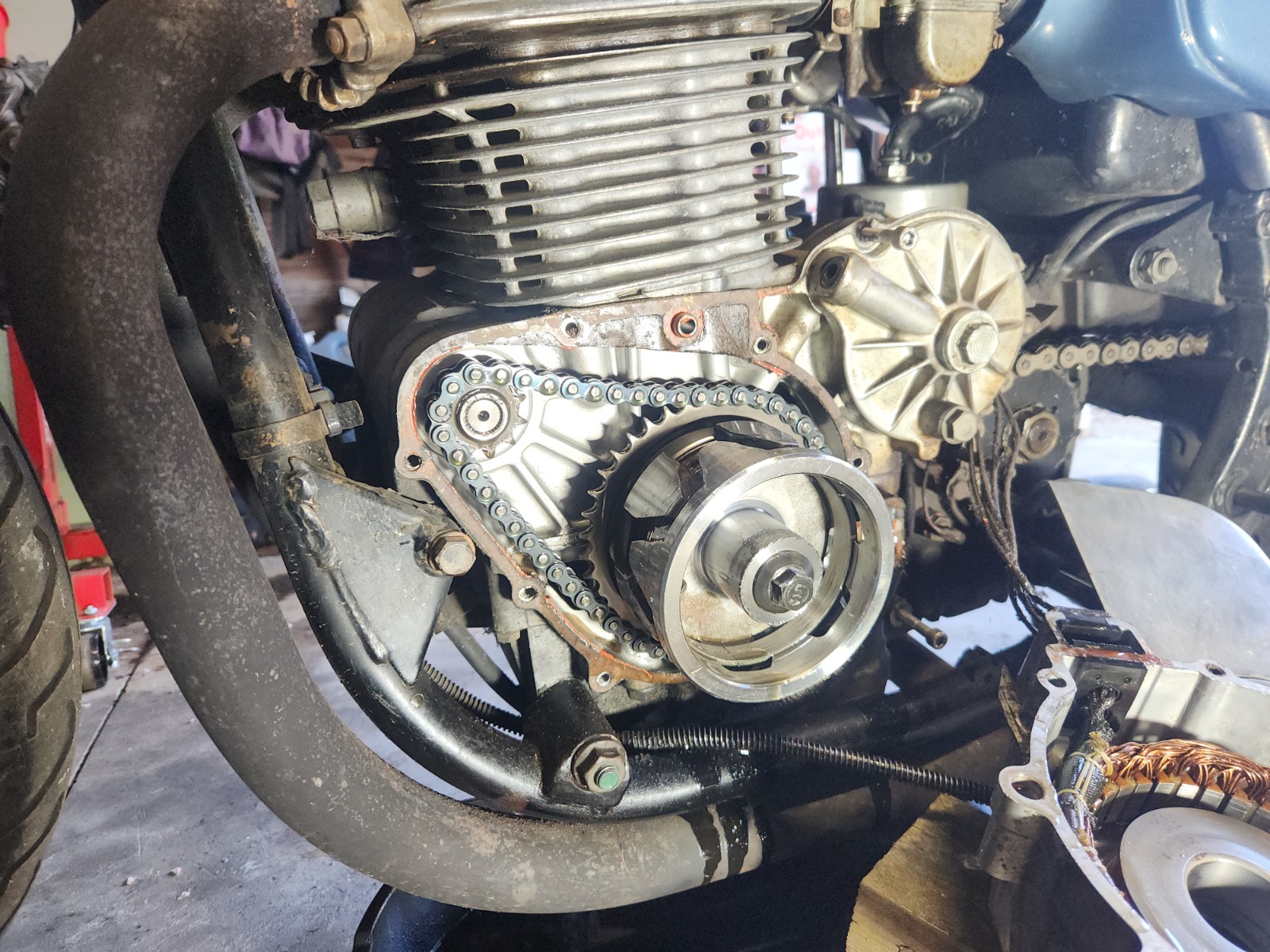

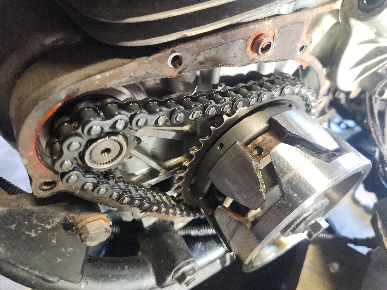

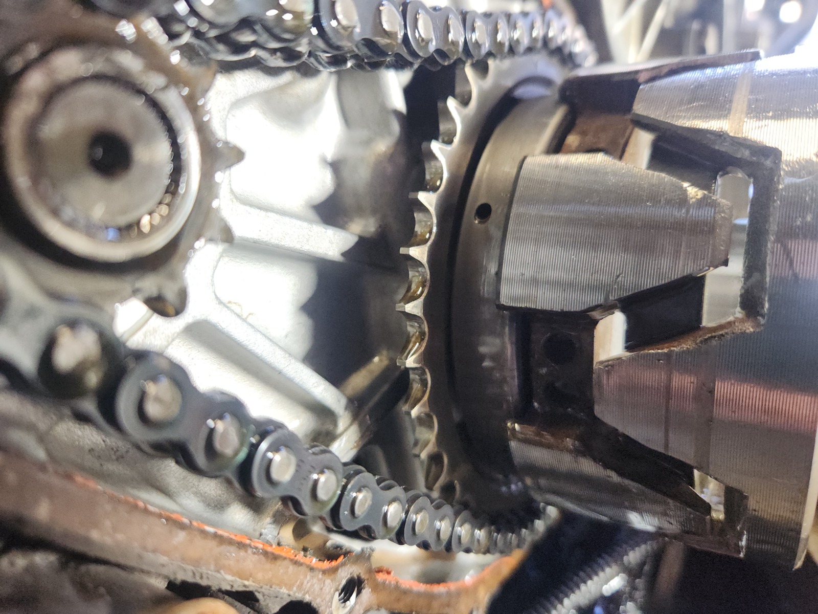

So it looks like you all were right so far, the seller was incorrect about the chain being missing. It's clearly there....
Ive only quickly bumped the starter using jumper cables a few years ago to confirm it would spin, previous owner cut the wiring going to the kill switch and starter button and I haven't touched it yet as all other controls work. Any harm in pulling the plug wires and trying to turn the starter with the dynamo cover removed?

Probably be kinda messy with oil everywhere and as I understand it there is a chain guide in the cover, can you rotate the starter gear on the rotor by hand (you should only be able to rotate it one way) If you can turn it both ways then you can save yourself a clean-up as the starter clutch will need attention

Thanks that confirmed the starter clutch does not properly engage
