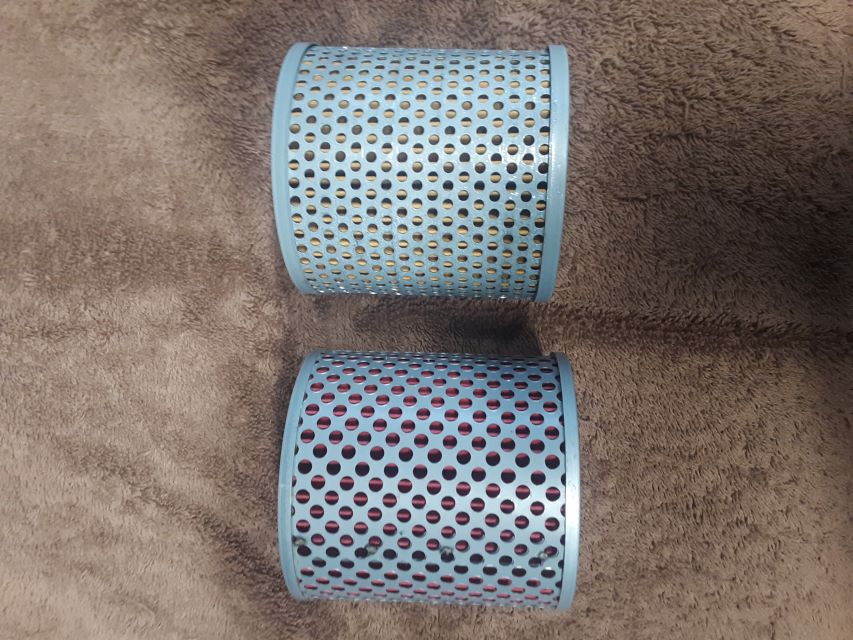

K & N :
KN-126 oil filter with perf metal "cage" 73 - 80 Z1 / KZ900 & KZ1000
KN-401 oil filter without perf metal "cage" KZ1000J & some others

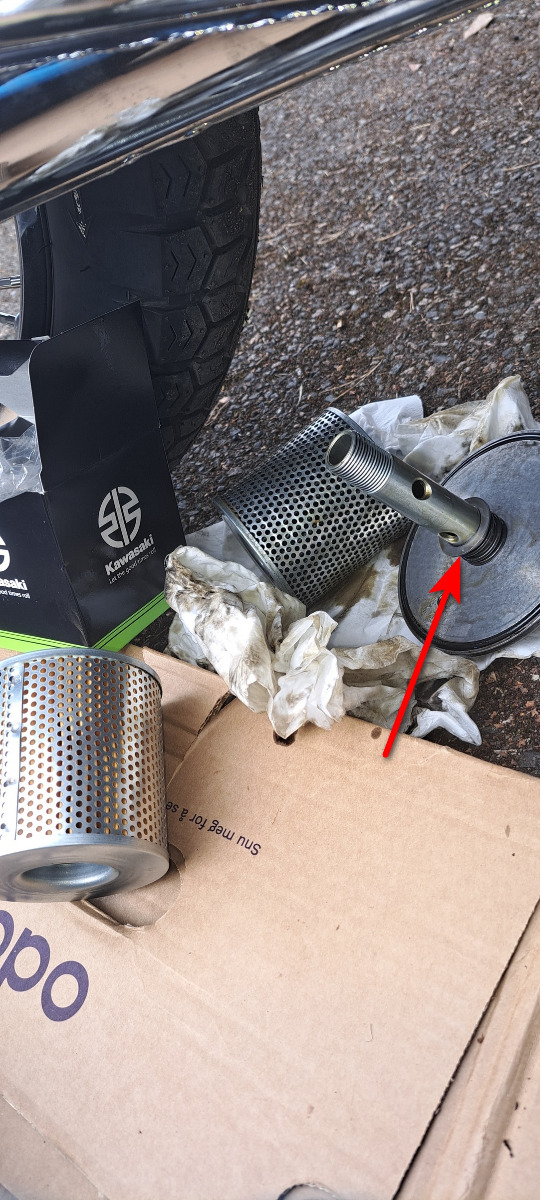

30 Mar 2025 07:28Those are same basic design as Mama Kaw's OEM# 16099-001 oil filter for 73 - 80 Z1 / KZ900 & KZ1000. They're examples of the perforated sheet metal that covers the outside (and inside) of the paper filter element. Shine light into the inside of one & that perforated cage will be seen.I have changed oil and filter some hours ago today. My bike has no cover . The important thing is like cra-z1 mention is the thin washer .It "glues" to the
filter when taking the old out and is easy to throw away with the old filer. Today the washer did that again and i had to pick it off the old filter and place it on the
oilfilterbolt again before installing new filter. If you install new filter without the washer you risk that the spring push the rubberseal on filter in so you got NO filtration.
A consideration we look for in aftemarket filters is the number & size of holes or, put another way, the total open surface area to expose the filter element to oil flow. The Z-motors in question have ball & roller bearings that bear the heaviest loads; those bearings live by flow volume far more so than pressure. The high-volume 3~5 PSI (hot) pressure of a Z motor is fine for balls & rollers as long as volume is maintained. The solid cam bushings are so lightly loaded they just need a constant oil film in a stock motor to live.
We ve seen aftemarket 16099-001 "equivalent" filters that have so few holes / insufficient open surface area that we question their ability to flow adequate volume, whatever that might be. Mama Kaw never spec'd volume that we know of, only pressure. There are aftermarket filters that have some fewer holes, but they are clearly much larger than others that have more, smaller holes. Surface area open to the filter is what counts. There's probably a way to calculate open area based on hole size & count but, we're not going there. Eyeball evaluation is all we do.
We toss any aftermarket filters we get in parts lots that clearly have the too little open area / too few holes syndrome compared to an OEM or quality aftermarket filter, so we don't have any to photograph. We don't sell them at swap meets, as we don't want to contribute to the possible demise of someone's motor.
The filters in OP's and Rolf1976_KZ900 posts above appear perfectly fine in that regard & should be able to flow plenty of volume.

^^^ Both of those have plenty of flow area.^^^
If you examine the inner cage where the filter bolt lives, you'll see the same generous configuration of holes in the sheet metal.
Wish now we'd kept an example of an aftermarket filter that has too few holes / too little flow area. It's pretty obvious in comparison.

I'm gonna stick with the K & N, even though the engineer in me guesses the open area is similar on both.
