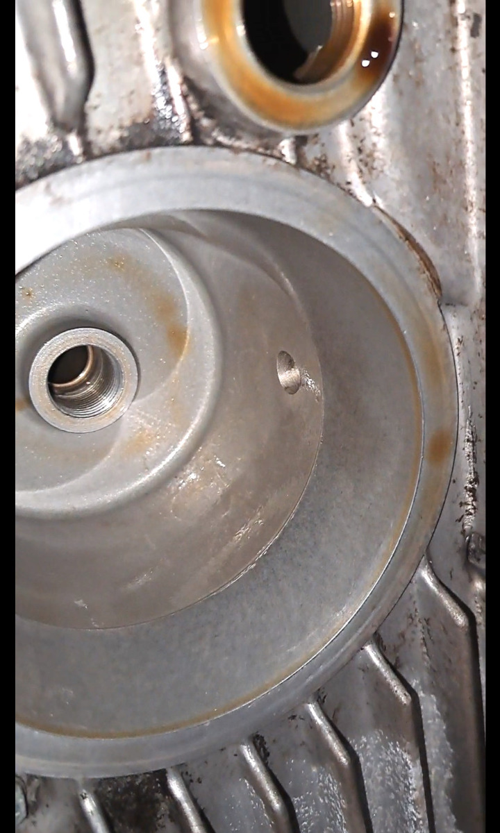

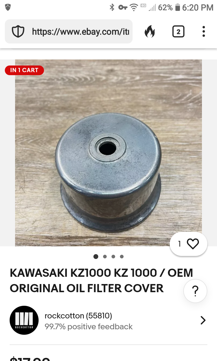

First oil change in my 78 KZ1000. Found no cover on the top end of the oil filter. Found a diagram on the forum with part #13169. Couldn’t find it on Partszilla. Any help would be appreciated. Thanks,Kevin

but, there is some reference to one on 72-76 900's ? And of course Fee-Bay has some..?

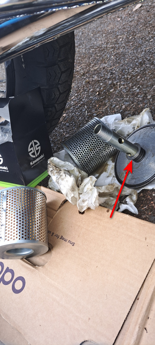

I have changed oil and filter some hours ago today. My bike has no cover . The important thing is like cra-z1 mention is the thin washer .It "glues" to the
filter when taking the old out and is easy to throw away with the old filer. Today the washer did that again and i had to pick it off the old filter and place it on the
oilfilterbolt again before installing new filter. If you install new filter without the washer you risk that the spring push the rubberseal on filter in so you got NO filtration

That's not an oil filter cover, it's a crankcase breather housing...

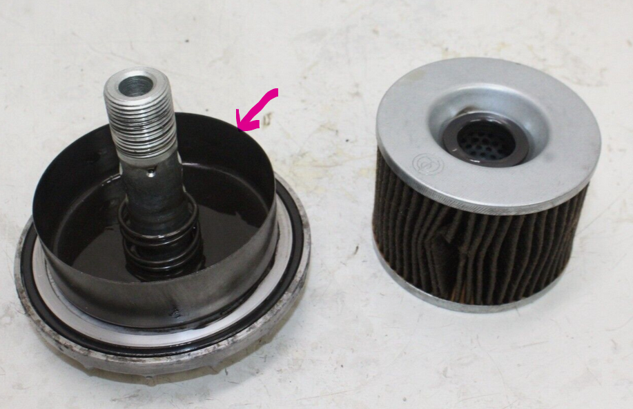

afaik. the fence protects the filter element from oil pump pressure. the 650/750 oil pump orifice is near the bottom end of the element and the 900/1000 orifice is probably near the top. the early 900/1000 oil filter had a metal/perforated cage around the element. as shown in Rolf's pic. so a fence isn't needed. if new oil filter doesn't have the cage. run it without the fence. then next oil change inspect the element to see if there's any pressure damage in one spot. probably won't be. edit. but lacking the cage. consider installing a fence.
