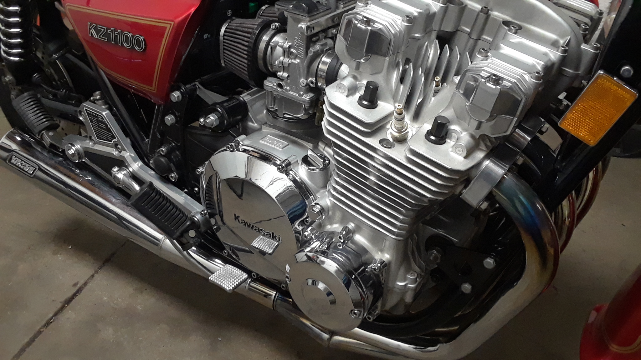

Done!
I did clean oil residue from the head with acetone on cotton swabs, and installed another set of annealed used copper washers.
With the current jetting, this engine runs fantastic:

03 Apr 2025 17:14
Superbe clean job !
Is the engine painted or blasted ?

Looks awesome, top job👍
