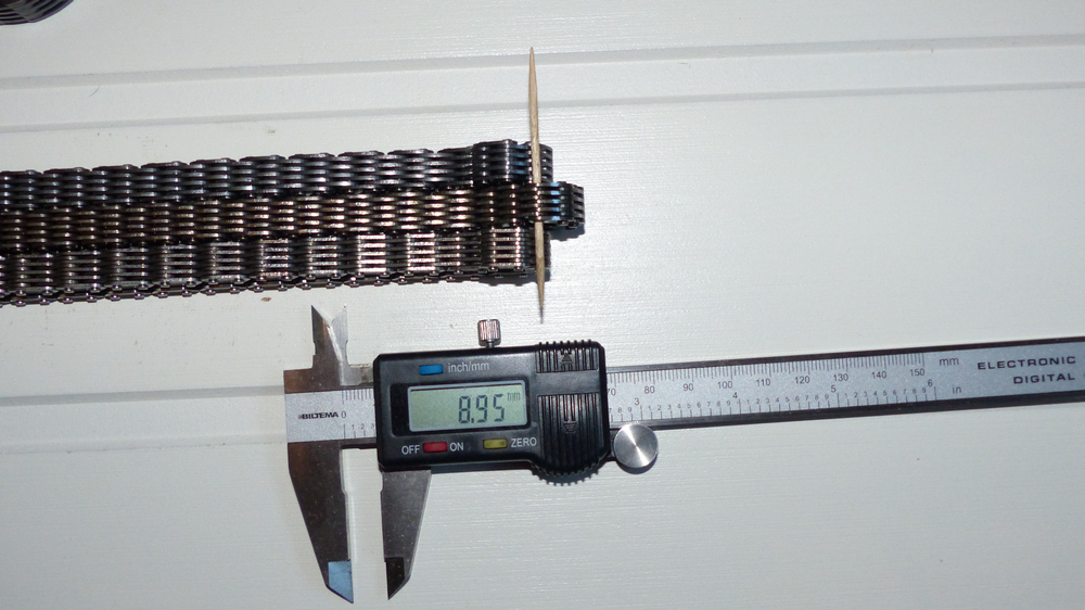

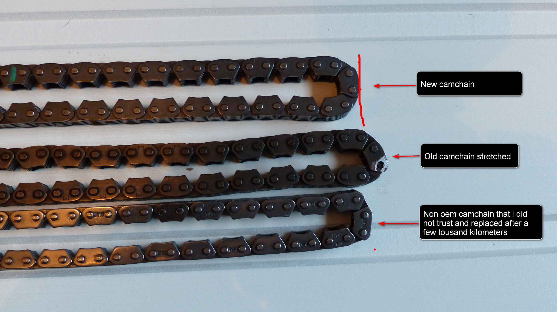

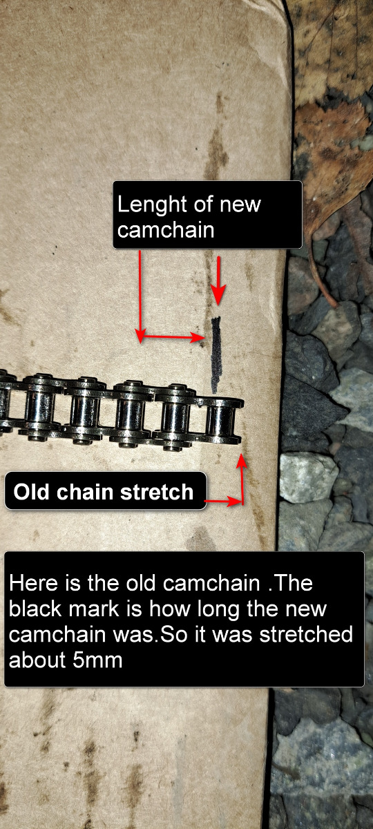

I had similar problem with timing on my bike .I replaced the camchain and sprockets. here is a pic from when i did the job the old camchain was about 5mm stretched
compared to the new.After replaced chain and sliders the timing was spot on.I did a quick writeup but have not posted it

Yes that is true ,but if you look at my picks where i have compared old and new camchain they are longer to not just sloppy. Here is another camchain i replaced
