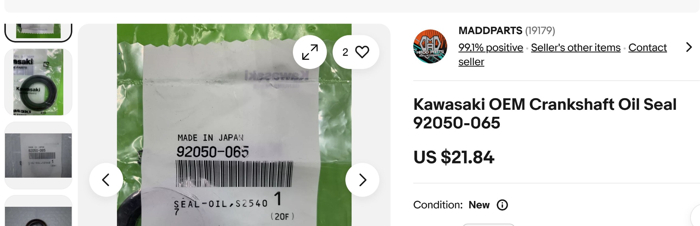

Got mine off ebay, having trouble posting the link so here is a snapshot:
I regret not doing this a long time ago and dealing with oil everywhere, it was easy.

12 May 2025 04:17 - 12 May 2025 04:18Did you "drag and drop" as your attachment is throwing an error code
EDIT: seems OK now ???

12 May 2025 05:02
At first I pasted in the URL, that is when I got the error.

Thanks Matratt3. Unfortunately Maddparts does not appear to have it any more. Funny, all listings I find describe 92050-065 as a R.H Crank Shaft seal and the image is not right.
I hate to order by P/N only, and disregard photos and description.
It looks like the seal size is 25x40x7. I may try ordering a generic seal in that size.

12 May 2025 08:40CMNSL list it as a "crank" seal but the associated image is of a camshaft ??Thanks Matratt3. Unfortunately Maddparts does not appear to have it any more. Funny, all listings I find describe 92050-065 as a R.H Crank Shaft seal and the image is not right.

12 May 2025 08:49
Yeah Cam vs Crank, I think it just got lost in translation.
Cam Seal, I bet if you message the guy on ebay he has the wrong picture, he might confirm it is wrong and looks like the Part and Picture I posted.
Here also with no picture
www.kawasakipartsnation.com/oemparts/p/k...-065/seal-oil-s25407
