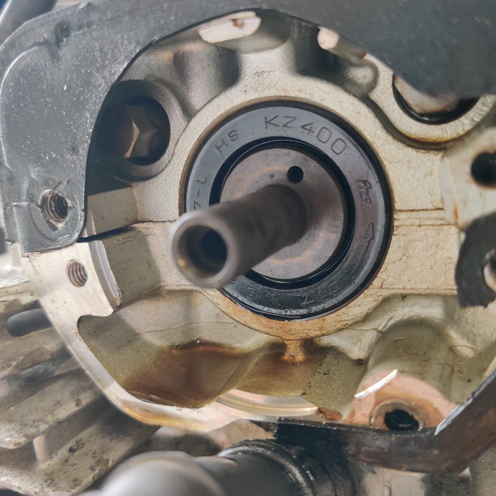

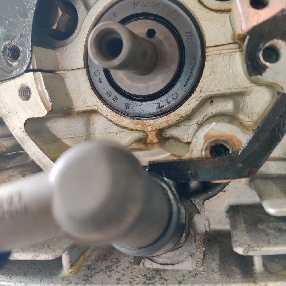

I degreased the bike and find that oil is leaking out of the lower part of the cam shaft seal. Pics attached.
Is this something I can do myself without pulling the head off?
If not would it be worth a try to apply permatex around the outside of the seal where it is leaking?

As Texas said, look at the FSM, you are already into to where you need to be and replacing a seal isn't difficult (if done correctly) plastering sealant over it won't help for long

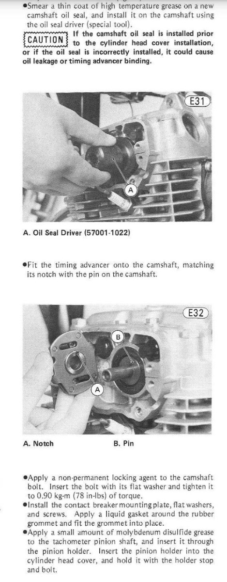

I had the service manual, thanks for posting the link anyway, I didn't know those files were there.
I'd like to say the service manual makes it all crystal clear for me but it does not. I am new at this.
My main question remains can I pull and replace the cam seal without pulling off the head. And on page 46 it says:
Caution:
If the camshaft oil seal is installed prior to the cylinder head cover installation,
or if the oil seal is incorrectly installed,
it could cause oil leakage of timer advancer binding.
This leads me to believe it can be installed without removing the head. But I was hoping someone else here had done this before and could chime in.
The other thing confusing me is there is no "timing advancer", I pull off the outer cover and what you see is what I posted in the previous pictures. Maybe because mine is an 87 KZ305-B2.

Simple answer is this type of seal is always fitted after casings are assembled

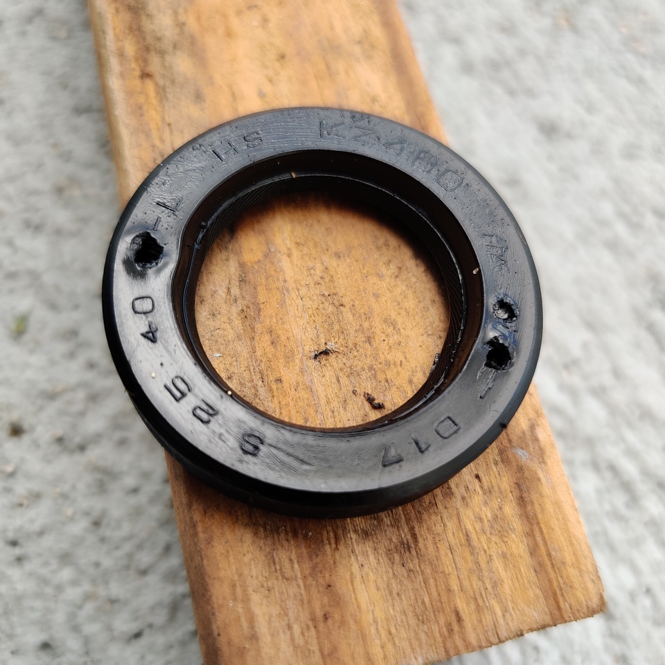

04 Mar 2025 13:45 - 04 Mar 2025 13:47You can carefully screw a "self tapping" screw into both sides of the seal from the face and pull out with pliers or vice grips, a socket will work to tap in the new seal although looking at the length of the shaft you will probably need a piece of pipe the right diameter to slide over the shaftThanks, should be interesting pulling the old one off and making/finding a makeshift tool to press the new one on, maybe a large socket.

I have had success using drywall screws to get seals out. Use the old seal as a cushion between the new seal and the pipe/socket when driving in the new seal.

Seal is replaced and bike no longer leaks!
Drilled 2 small holes and used drywall screws as suggested to pull it out and used the old seal and a socket to press the new one in after applying high temp grease.
Was way easier than I expected.

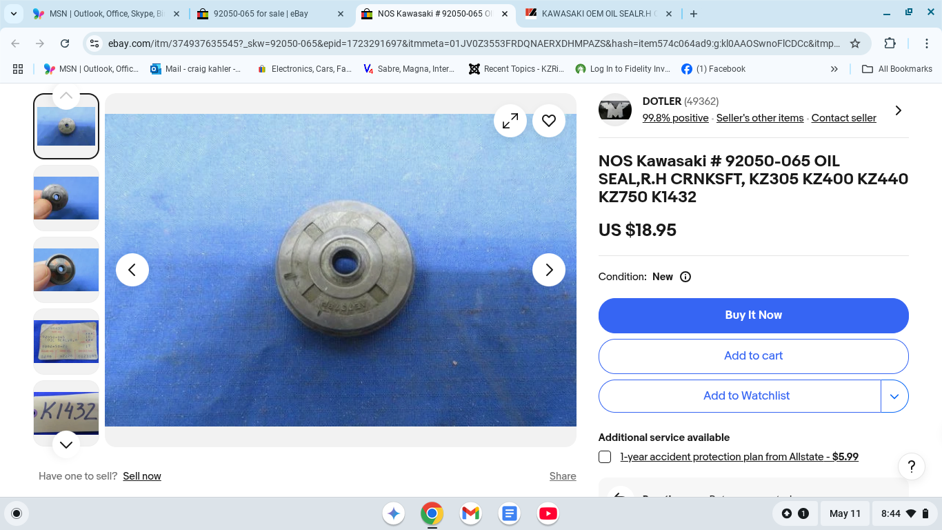

I'm going to be replacing that same seal, I got the p/n 92050-065 off Partzilla, but the images and description does not look right.
Where can I get that seal and what is the correct P/N?
