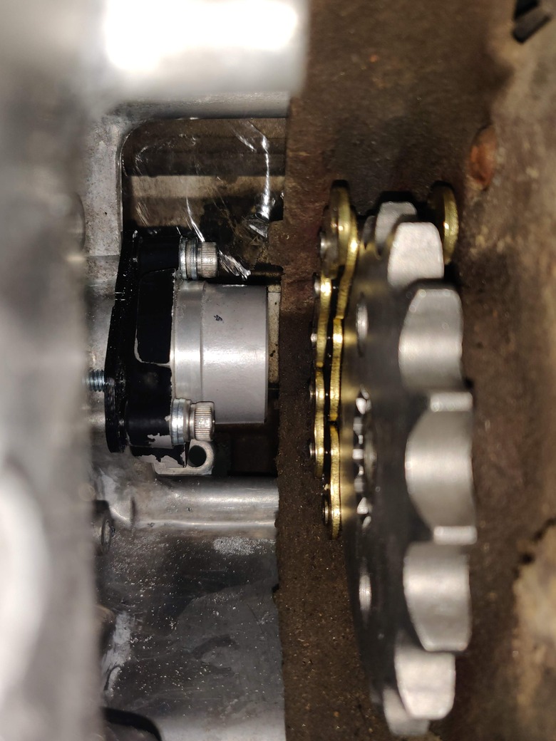

I went down the rabbit hole of designing a conversion plate to run a Concours hydraulic slave on my 82 1000k this past weekend. Initially I was thinking of a plate style sprocket cover and standoffs like you see in aftermarket kits, but I stumbled upon an American Classix kit (no longer made it seems) on eBay and realized that there is enough room to mount a hydraulic slave inside the stock sprocket cover.
The adapter plate route looks feasible to me. This is a 82 1000k with 530 conversion.
Has this been done before? It's a bit difficult to search the forum, but most seem to recommend the cable style retrofit kits or the complete replacement of the sprocket cover.

Check out page 23 of my build thread, this just needs the original lifter and a small amount of material removed from the stock cover

03 Feb 2025 12:13Interesting idea! Is there an easy way to route the hydraulic line to the inside? Let us know what you come up with for a final install
Ports are currently facing down, but can be rotated 180°. Unfortunately, hole spacing prevents the bleeder from pointing up, but it has to be bled with the cover removed anyways, so 🤷.
I'm planning on routing the clutch hose through the area where the stock cable is routed.
Wookie, I did not initially make it that far in your build thread; very nice solution!
I also spent a little time looking at 650 and mk1 1000 clutch covers I had on hand; looks like the same idea works for those as well!

I did the same to my Z1r, the GPZ900R slave fits to the original clutch cover with very minor modification I posted this on forum approx 12years ago). The other Bike "hybrid GPZ1100" has a different mechanism to the clutch rod using ball bearings/ cable, I actually found this to be a better system
