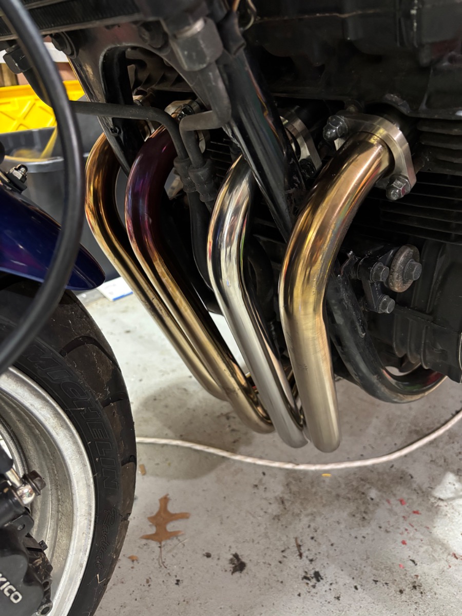

I had noticed the brand new header pipe on cylinder 2 was still chrome while 1 & 4 were straw colored and 3 is purple/blue at the first bend.
When I fire the bike up now, it takes a bit longer to turn over and cylinder 2 header is cool to the touch after running a few minutes, while cylinder 3 pipe will be glowing red at the bend. The outside cylinders seem fine.

Blue is hot,
Brown/golden is correct
Metal colour is too rich or not firing.
They look like delkevic single wall stainless down pipes.
Question is why is 2 & 3 different.
Likely blue is waaayyyyy too lean.
Metal colour I doubt is not firing at all or if it is its waaayyyyy to rich.

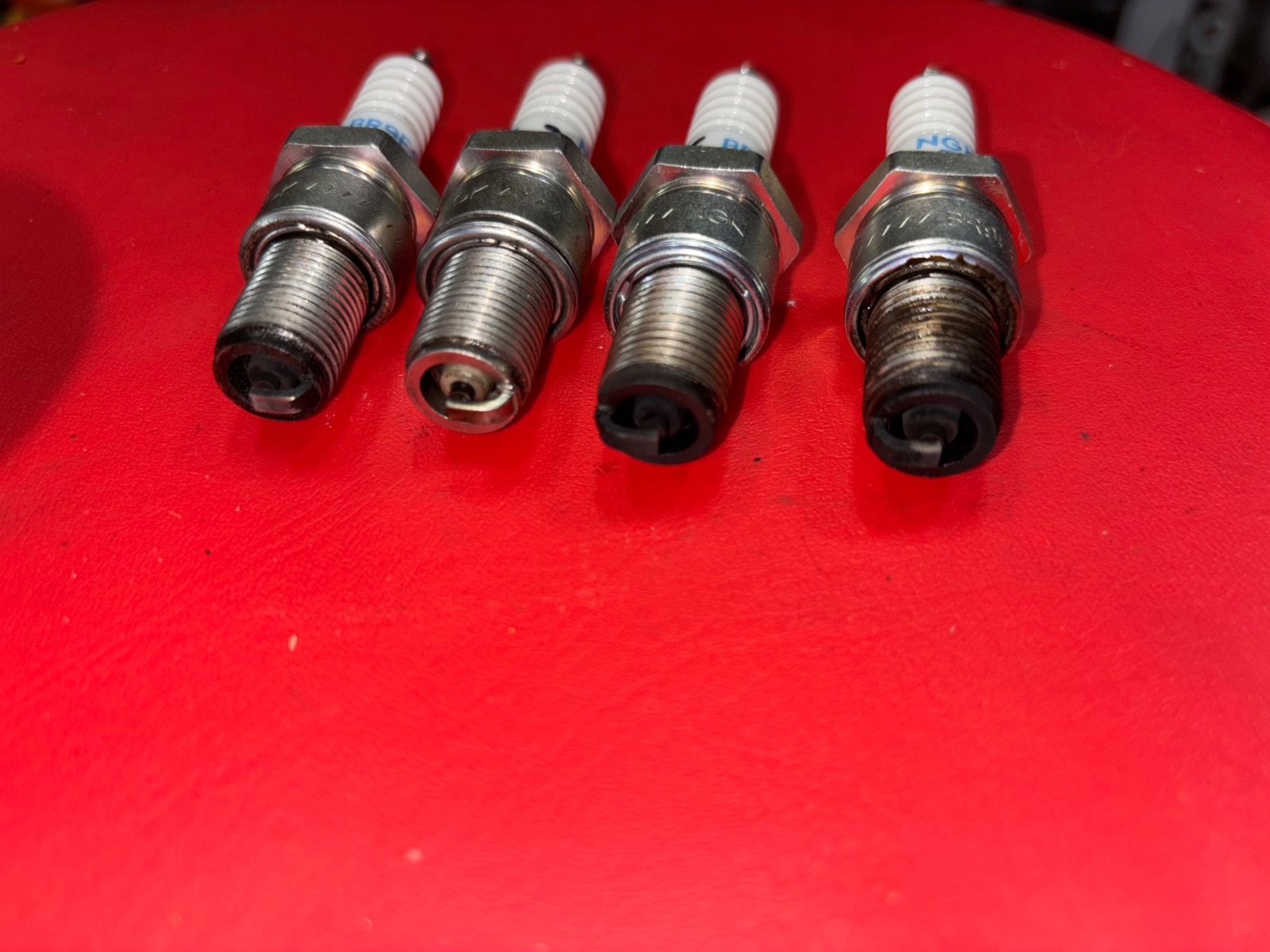

Yes, these are Delkevic pipes, with no miles on them only approx 10 minutes idle time.
Here are the spark plugs 1-2-3-4 from left to right.
2 is the cold cylinder and 3 is the hot.

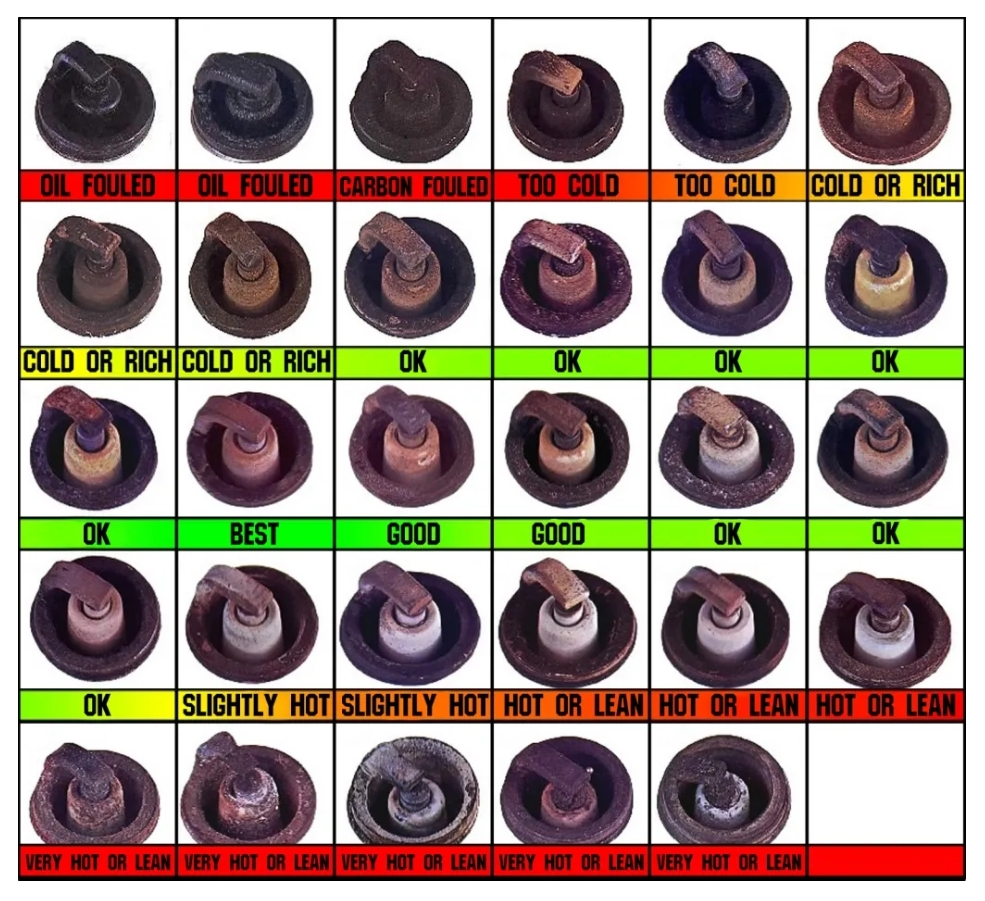

Difficult to say as those are presumably still choke rich mixture covered but No2 is def not firing. This'll give you an idea but it's not definitive for modern fuels.

Thanks for the graphic.

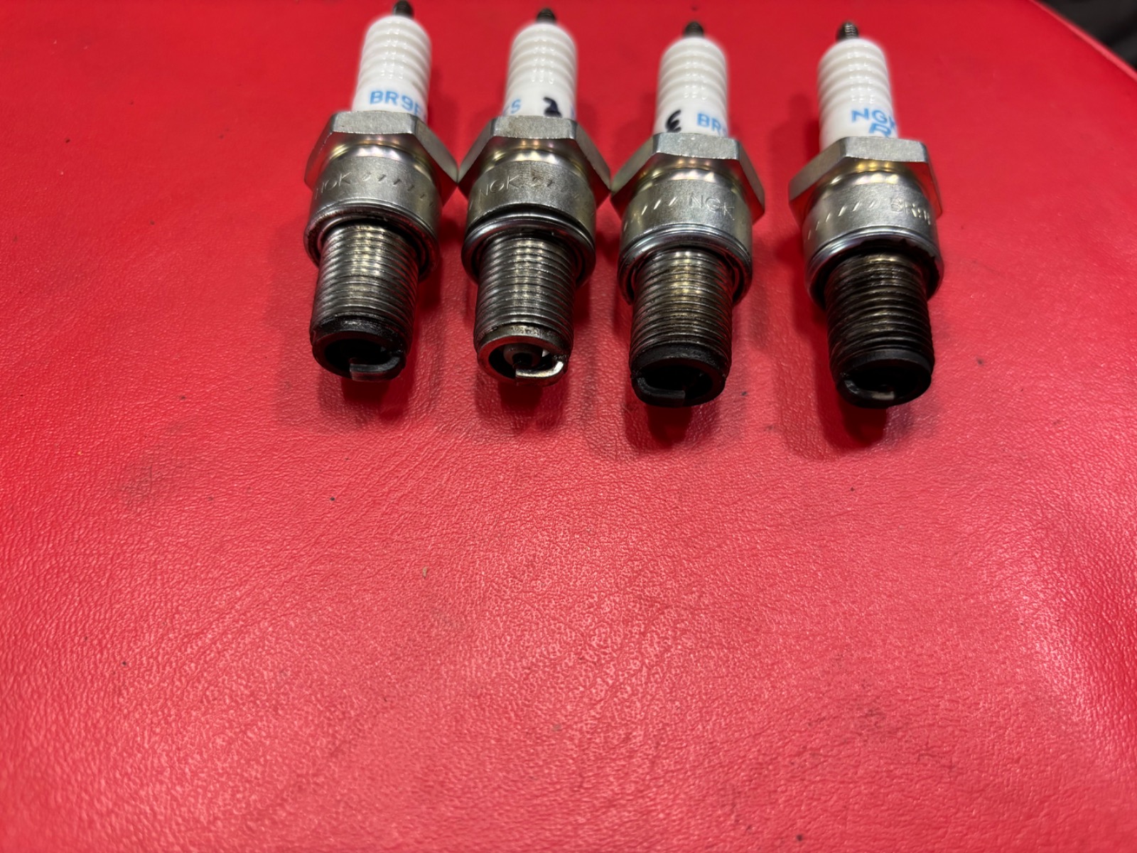

Thanks for the suggestions. I did a compression check at the end of August when I couldn't get it to run at all and got the following: 1 & 2 were at 120psi, 3 at 125psi, and 4 was 135psi.
I'll pull the plug out after letting it run a few minutes and check it out. Plugs are cheap enough I'll probably grab another set and throw them in and see what happens.
One thing I just remembered, when I pulled #2 plug two days ago, the side electrode had collapsed onto the center electrode.

29 Sep 2024 21:10As far as I know, that can only be mechanical damage caused by a foreign object or broken part. A broken valve will do that. Borescopes are pretty inexpensive these days.One thing I just remembered, when I pulled #2 plug two days ago, the side electrode had collapsed onto the center electrode.

30 Sep 2024 00:44I would agree (unless you dropped a plug when they were out) if you are using the correct plugs that suggests something is "amiss"As far as I know, that can only be mechanical damage caused by a foreign object or broken part. A broken valve will do that. Borescopes are pretty inexpensive these days.One thing I just remembered, when I pulled #2 plug two days ago, the side electrode had collapsed onto the center electrode.

01 Oct 2024 00:22Before you dive in too deep I would suggest looking in the plug hole for signs of impact and fit a new plug. Where you have had the plugs in and out you may well have dropped one on the floor and don't remember (it's not a life changing event) which could have closed it up. Think positive If it happens again then you know you have a problemWonderful... I sure hope mechanical damage to the engine or head is not the case but I will start down that path after checking the few suggestions I've received. This is quite the blow to my drive as I thought I was just about to throw my leg over it for the first time in years.

IF, and it's a big IF, there is any foreign object in that cylinder there is no evidence of impact witness marks on the plug earth strap. Additionally as he's run the engine already he's not going to damage it more by just trying again with a good plug.
I suspect that that plug either came out the box like that or it's been dropped.
Although plugs "supposedly" come pre gapped they are seldom correct for the application we use them for so I always check/adjust the gap, new plug or not. Then you know where you started from.
Re gap that plug, swop it for another cylinder, fire it up, see what happens and go from there.
