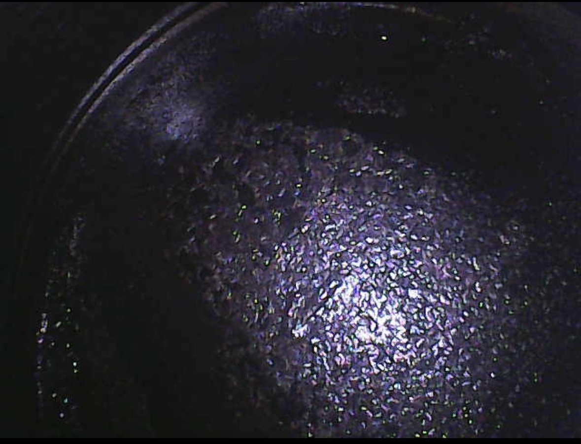

Thanks @Warren3200gt and @Wookie58. I let the bike run for a minute or two and cylinder 2 was still cold. Pulled the plug and the earth strap was not bent. Purchased a cheap borescope and looked inside the spark plug hole and saw no foreign objects, just some carbon build up on the piston.
I swapped plugs from no1 to no2 with no change. Checked the resistance on those two plugs and got 5.48k on no1 plug and 5.84k on no2 plug so they seem to be okay.
Time to pull the carbs and check for a fueling issue next?
