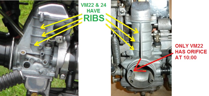

21 Aug 2024 12:34 - 21 Aug 2024 12:48Ok! the 97.5 mains gave me a clue that it may have been because stock non pumper 24's don't run a jet that small from stock and as i mentioned to the pics you posted on the Ebay reply you have VM22's and not VM24 as you state in this thread.Yes I did contact you on ebay regarding the positioning of the air correction jets.
The main jets were 97.5 and I changed them to 102.5 supplied by Phil at zpower.
The air jets for the 22's are a different size from the 24's so if you bought them for the 24's that you thought you had they will not fully eliminate the off idle hesitation.

22 Aug 2024 10:38 - 22 Aug 2024 10:40Maybe someone fitted the wrong carbs or yours is a USA import as the 22's were USA only.That is a bit strange because the KZ650E1 owners manual that I got with the bike says that the carburetors are Mukuni VM24ss. I did google and found some info that said the American import E1 does have the 97.5 main jets.
Yours are certainly vm22 .
Only the 22's have the kidney shaped passage at the ten o'clock position as highlighter by the red arrow.
24's do not have this.
Last edit: 22 Aug 2024 10:40 by zed1015.

23 Aug 2024 04:26
I did contact you on ebay regarding the position for the air correction jets which you replied, they always go opposite the air screw and attached a pic. I did not post any images of it on ebay, mine don't have the orifice at 10 o clock like the image above. Mine are exactly the same as the image you have on ebay 2 left and 2 right.
They look the same as the vm24 which the manual says they are for that bike and they definitely had had the 97.5 main jets.
