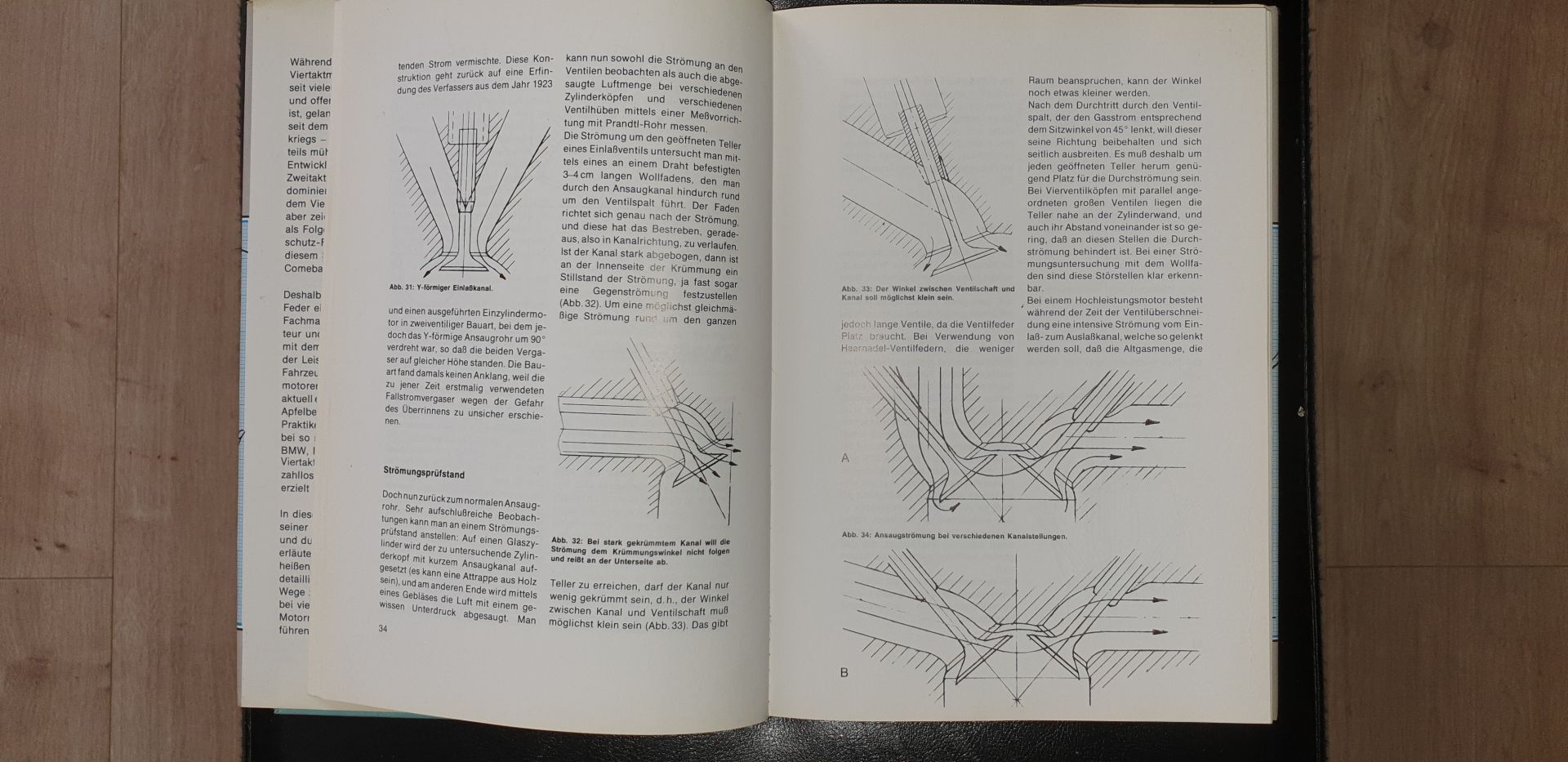

You can perform 100% (with parts and tuning) on the intake or exhaust side but destoys/waste the
expected power in the main core reaction power plant area!
You can have an unknown power bottle neck in every "perfect" system.
