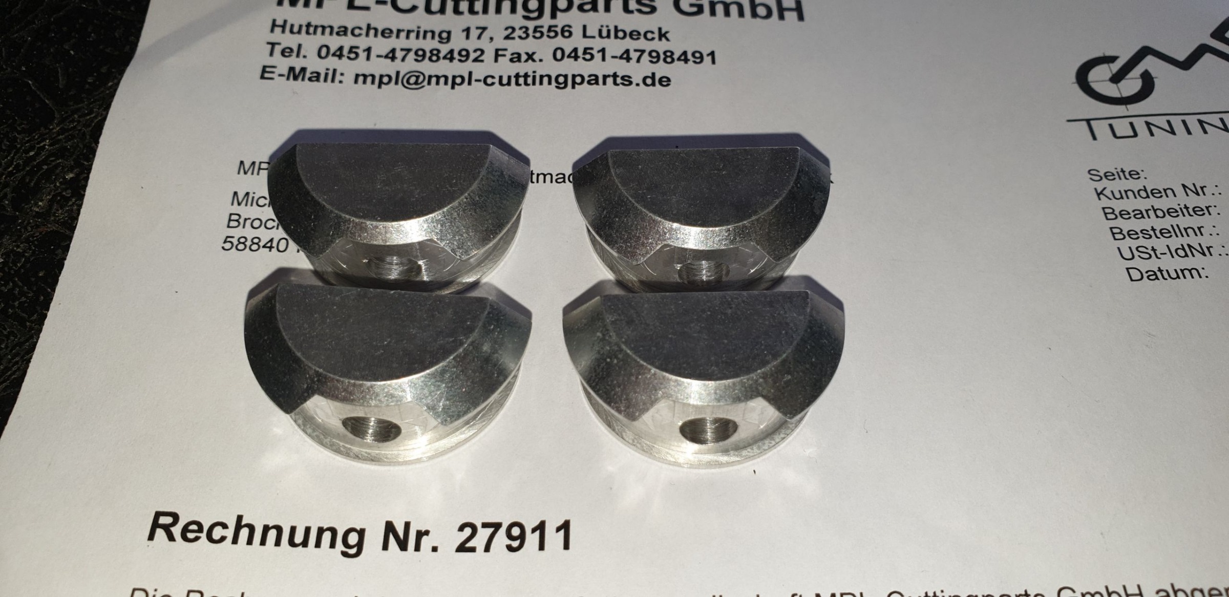

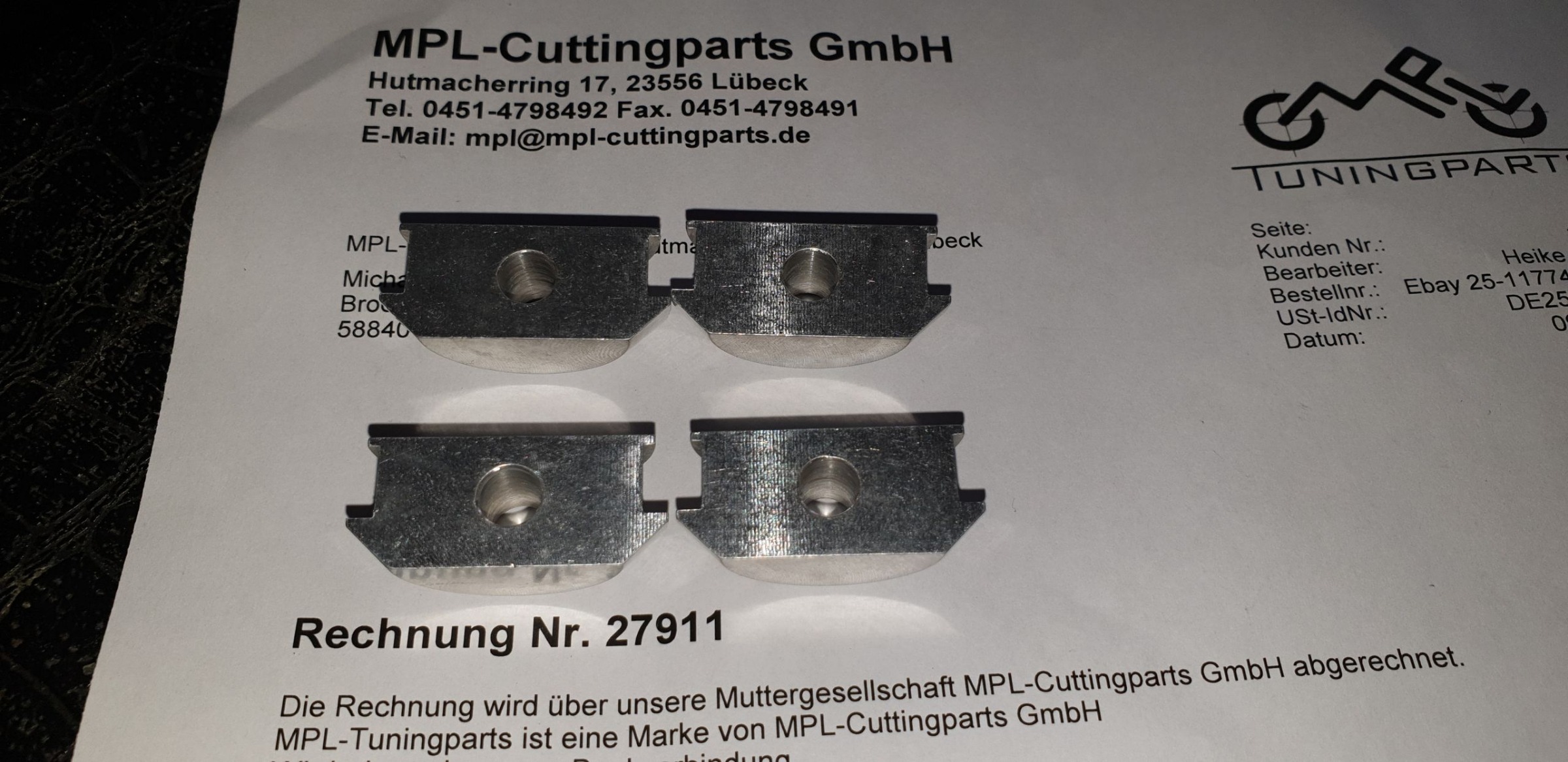

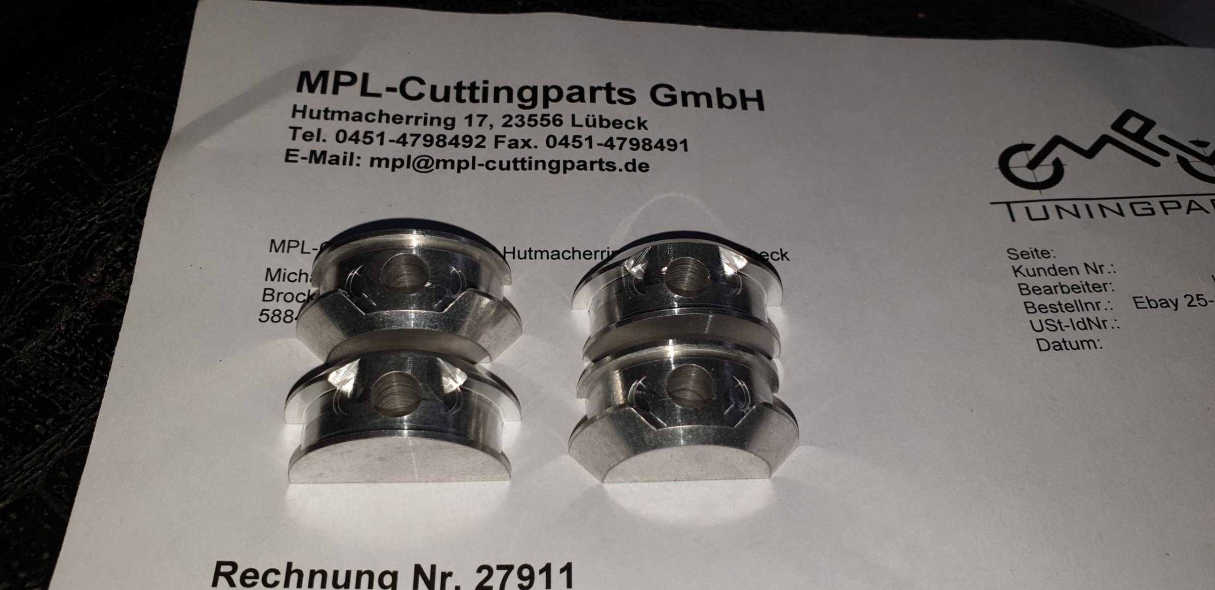

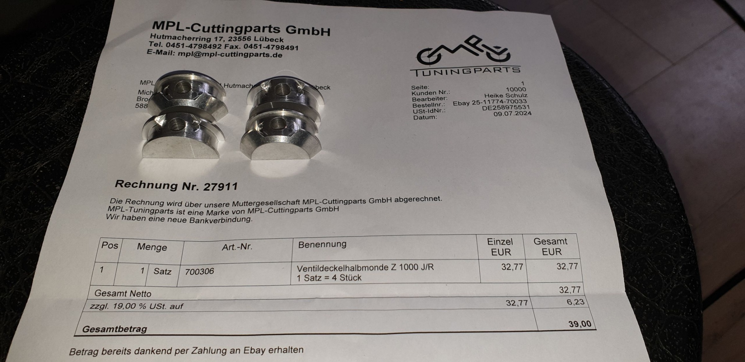

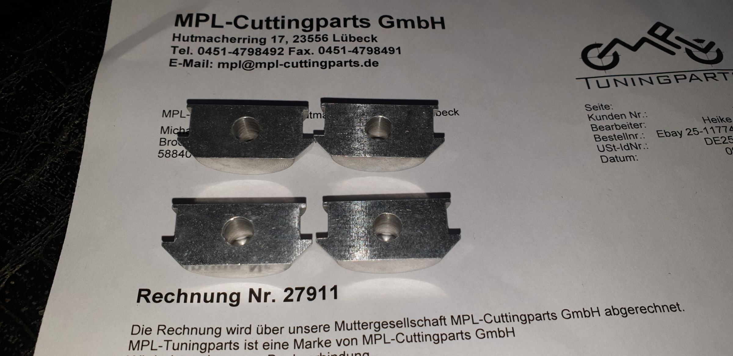

Call me silly but why would one want to divert to "solid" end-plugs?? They utilized the rubber and shiny blocked cover for a reason and worked super well for years in operation. You'll miss out on rubber sealing that naturally comes with the original design, especially where the M6 bolt passes thru.

I've had oil weeping issues with the metal-faced rubber plugs on past cylinder head installations. The solid plugs minimize and potentially eliminate that, which also means fewer expensive cam cover gasket replacements.

The pure aluminum cam end caps made the cyl. head like a one pice casting unit.
Rubber can shrink or dry out, so weeping or a mist of oil could your future problem you have to fix with money, time and labor.
